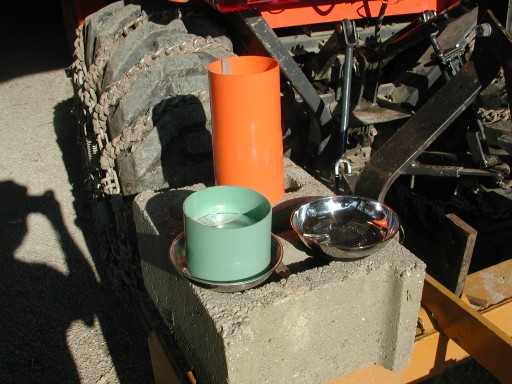

Here is what I did. I made mine magnetic so I could easily move it to the other tractor, or take it off when I want to.
I used one of those cheap stainless steel magnetic trays. The ring magnet on the bottom of the tray provided a place to drill a hole, and let me attach a wooden disk to the tray with one screw. I attached a piece of 4” PVC pipe to the wood disk, and put a piece of rigid foam insulation in to help keep things cool.
A second piece of pipe (had a piece with the expanded end on it laying around) slips over the base piece, gives me the option to have a shorter holder in the future is I should desire to. Doubt I will want to though.
This photo has a second parts tray sitting on the concrete block, showing the starting point. Actually I think it was holding a screwdriver bit.
