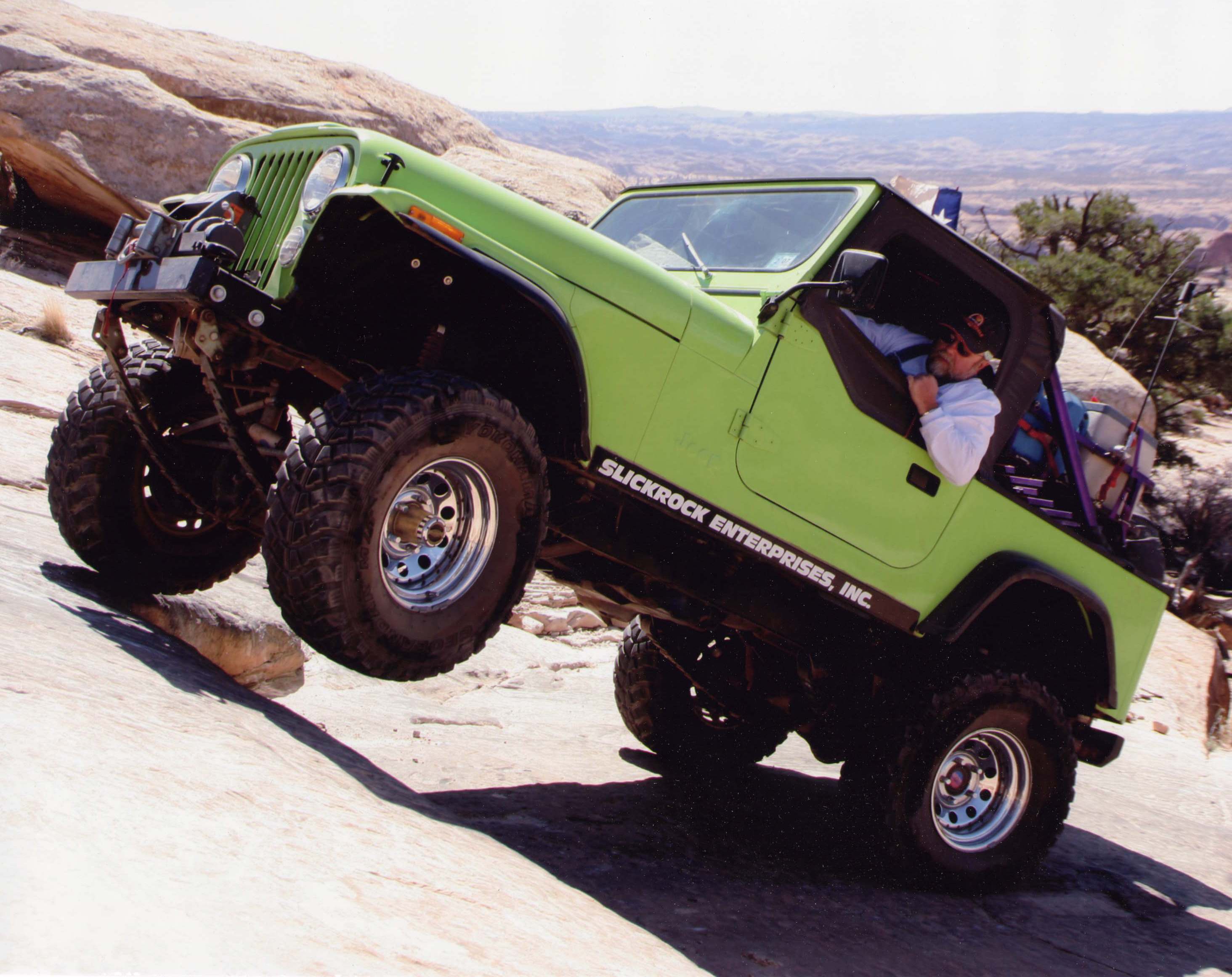

   / cut a foldable ROPS? #9
Me too Gene, I put a cage on my tractor as well as my Jeep.
