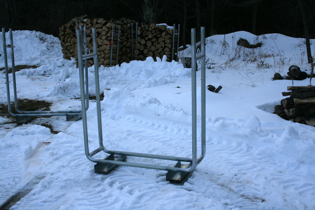

I have several incomplete and empty units. I'll try to get a pic.
I had them built by Freudenthal Dairy & Manufacturing, Medford WI out of heavy wall pipe. First proto was 2" exhaust pipe, but this is a bit weak for going in the woods.

60" wide x 48" tall were my first batch
4'" wide x 54" tall is my latest ones which I prefer

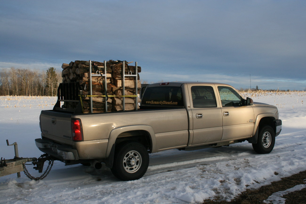

Pic of the rack empty.
Also a pr of racks loaded in the bed of my truck. I had my bucket along due to snow etc so I had to carry the forks in the truck bed. If I didn't have to carry the bucket I'd carry another pair on the tractor/trailer with the forks speared thru. 2 racks tied together is quite stable. I pit a plank through the fork slots as a safety precaution as well.

Thanks for the pictures do you know what tie id/od of the tube is?
Did you do any thing to keep the water from going in the uprights?
