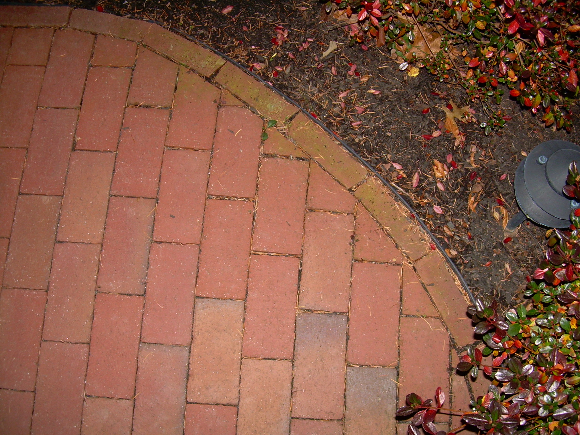

Well "back in the old days" when bricks were fired clay, a mason could cut what ever shape you wanted with a brick hammer (I've tended for many of them). Now no mater where you hit them all you get is 2 halves :( you have to have a saw, the new modern bricks including pavers as well as veneer and structural bricks are a combination of highly compressed shale and cement with high heat.
For OP I have this one pic showing what I was talking about, doing the radius with the border bricks, then running the filler courses into it just trimming the corners to bring them in close.
For Joel with the final cuts, I would take as many bricks as I needed to the back corner of the yard where the dust wouldn't bother anyone and cut them with a 12" demo saw w/diamond blade. If you have this saw available that IMO would be the fastest way.
