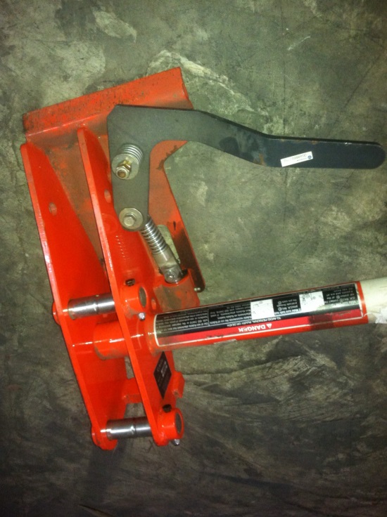

Customer ordered an 84" grapple and change out his loader to SSQA ... Grapple teeth and lids are AR400 steel 3/8" ... dual lids with 2x8 cylinders.
off with the old
Box in for lever clearance
Test fit
Cut the parts
and finish up

Kinda hard to tell from your picture, but the latch linkage doesn't look like it has any "over center" travel to keep the handles from bouncing up, unlatching one or both sides.
Where I added the arrow needs to be over farther (handle lower), so the compression spring will hold the handle down better.
Should be more like this, notice that the spring has to compress as the handle starts to raise.

You make a very good point and thank you ... I believe all is good it latches very secure.
