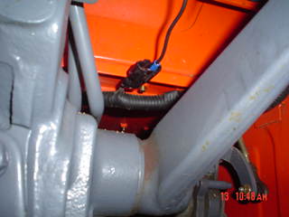

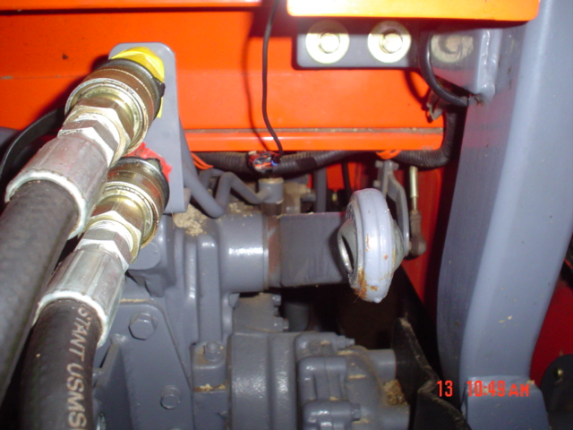

This is the tie in location for three of my added lights on my 2008 CK35 HST, they are on the "customer use" 15 amp circuit. I have added two toggle switches behind the tool box as I only used them at night or when grading our road. The round rear facing light was put on by my dealer and is on a different circuit. I had also tried to add the two smaller fog lights to the dealer installed round light but it blew the fuse. This round light is on the bullet connection that you have already found, this conector is on the left side if looking forward.
Thanks Mousefield. What type of connector did you have to use? The black wire going to the rectangular recepticle in the first picture, is that the "hot" wire for your lights? Did you frame-ground the other wire?
   / "Customer Use" fuse on CK27...Where the heck is it? #6
Yes, the rectangular "box" has two connections inside. I used a "spade" connector and just pushed it in solidly. It is in a weather protected area so should not get wet. I grounded the lights to the frame. I have used them a number of times now with no problems and they work well.

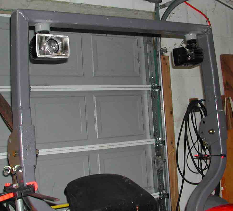

I want to add some work lights, 2 facing front, and 1 facing back.
I just finished my worklights on my CK30, and I did it similar to that.
Since I used 55W halogens, I installed relays for each one, with the control
coils powered thru the customer-use fuse. This way, the key has to be
ON for them to work. I also used dedicated dual 16 guage wires to each
light, which are fancy PIAA fog lights with the internal light blocker removed.
Furthermore, I wired the relays so that they use the turn signal switch. Now
a right turn lights the front light, and a left gives me the rear. No added
switches!

The rectangular box was already there from the factory. Make sure you are looking a little forward and a couple of inches down as it is hidden, took me a few minutes to find it. If I recall right there is another set of wires running in the same general area but a little higher (3-4 inches) and a few inches back. You want to find the run of wires a little closer to the seat area.
That is the same wire that I hooked in to, sorry I do not have any pictures. But I cut off the black connector, put bullet connectors on each wire and used both wires, one as hot to switch, and the other as ground for switch and lights. I may light up like a shocked cat one of these days if I wired it incorrectly. I just felt like I could get a better ground coming on back to the wires coming from the customer use fuse
