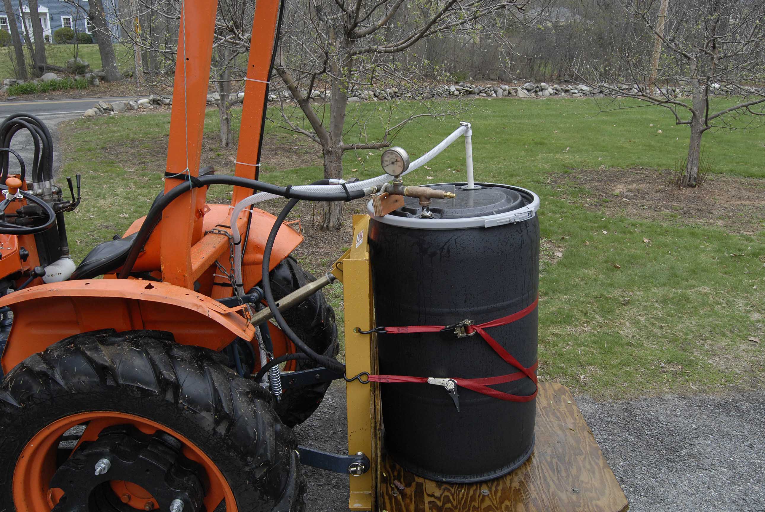

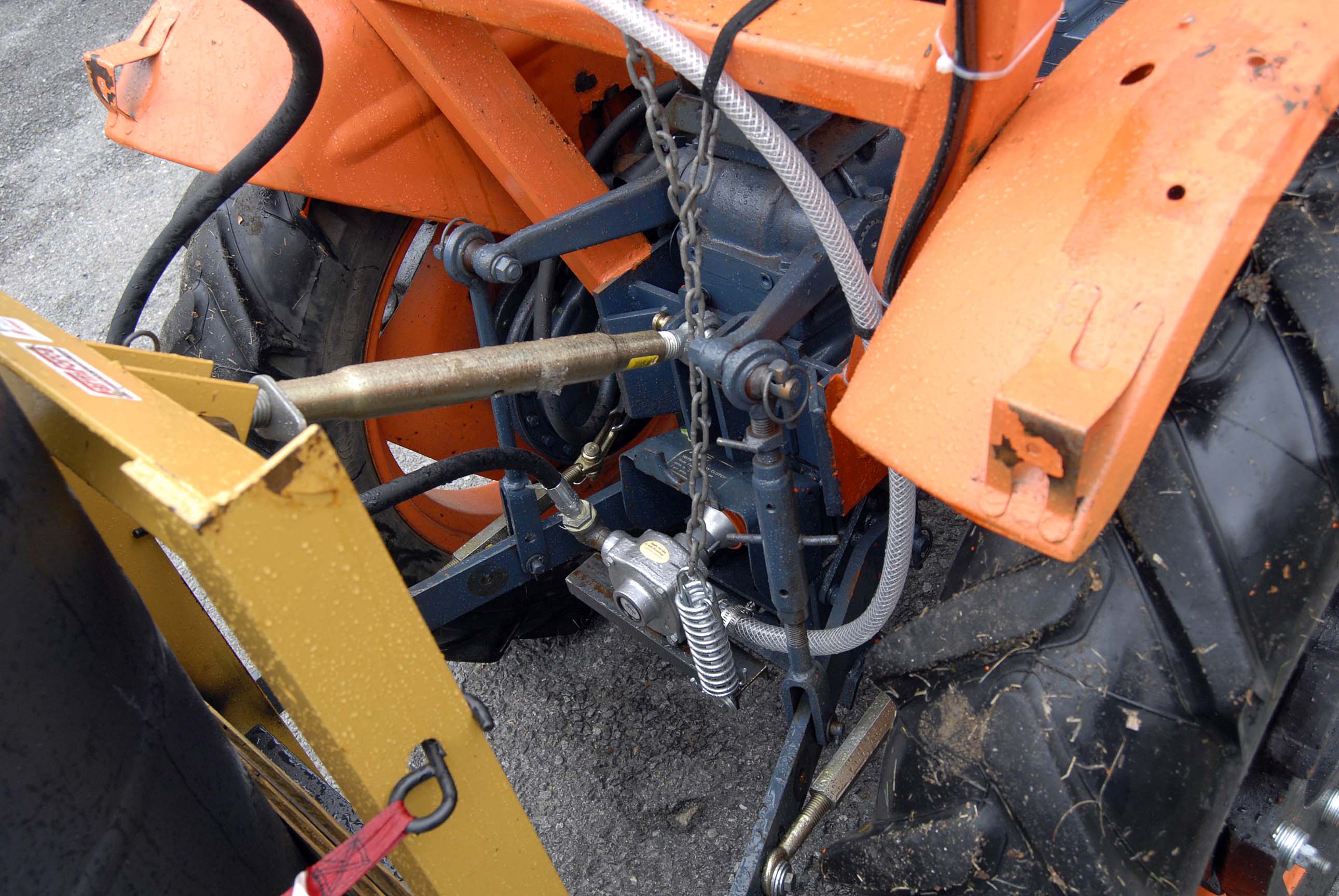

Hello to all,

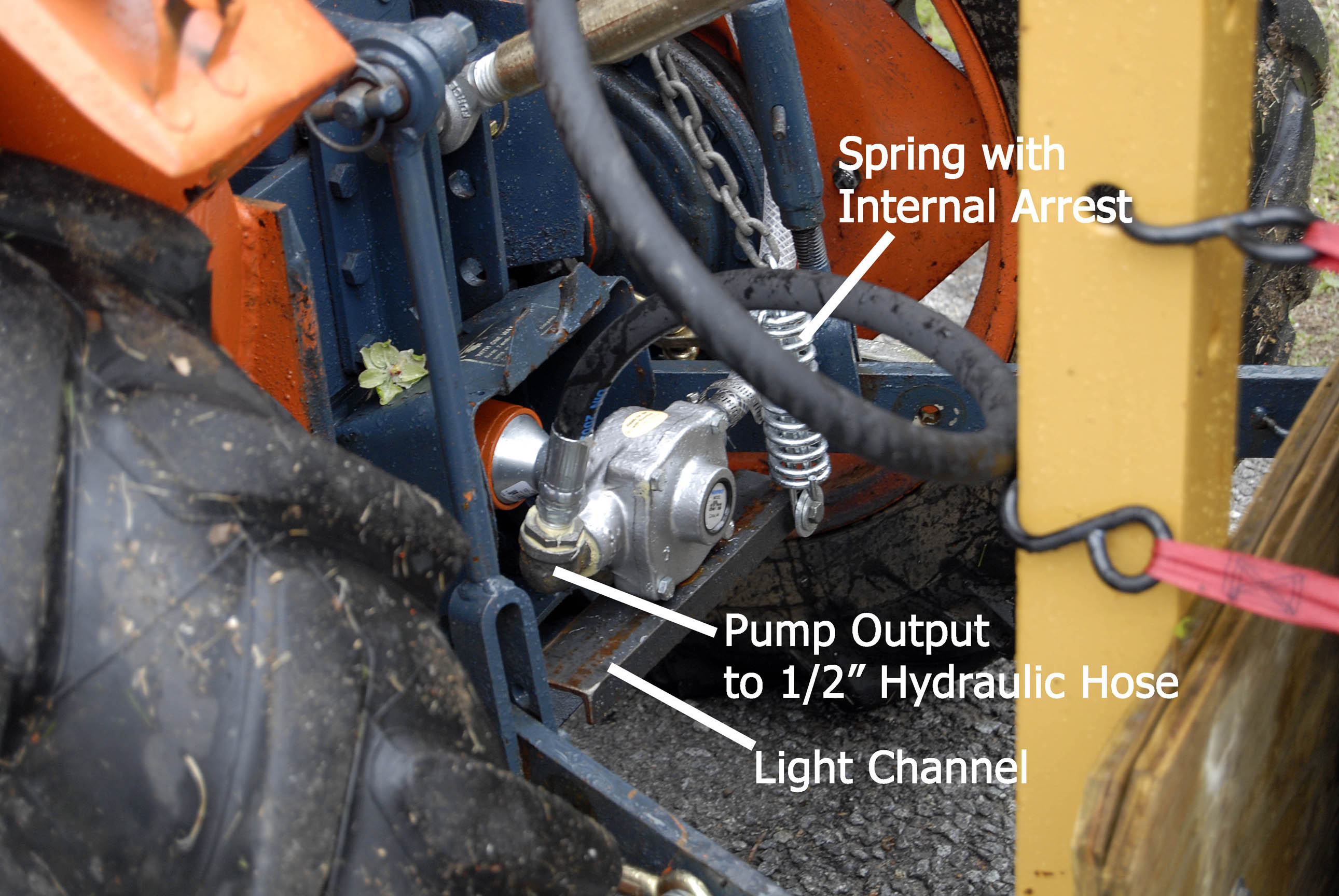

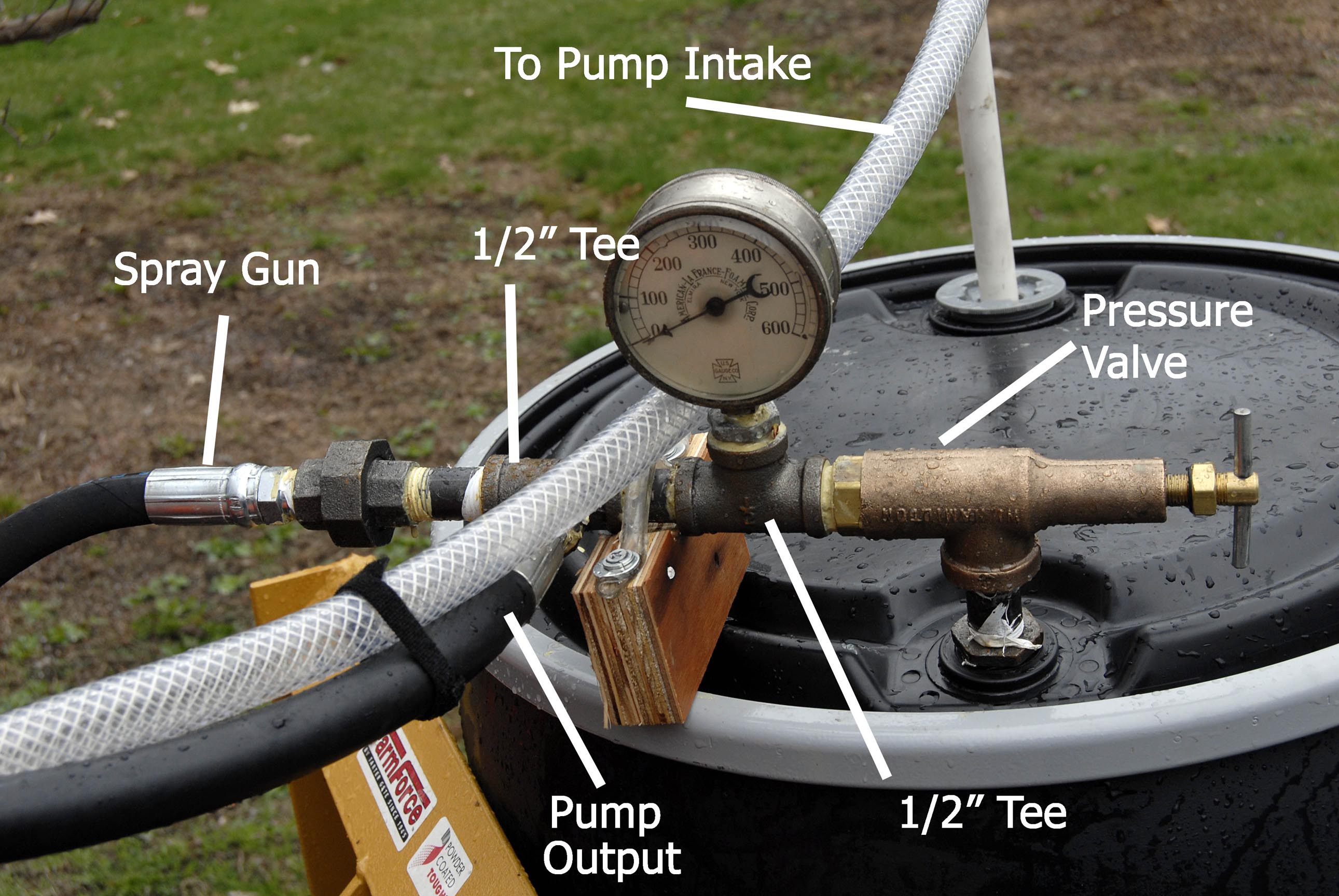

Here is my version of a custom PTO driven sprayer. Most parts are from TSC or Home Depot. The pump is a hypro 6500XL, TSC 2111815. It will drive the system to 300 PSI. The pressure valve is TCS 2106705. It's set to dump liquid back into the tank over it's setpoint. It doubles as an agitator as the system pulls from the botton and dumps on the top.
The high pressure hose is TSC 1819606 and TSC 1819999. These are 1/2" and 3500 PSI rated, rugged and overkill. Pump to manifold is 5', manifold to spay wand is 10'. This could be a bit smaller in diameter if you like.
The low pressure, intake side is Home Depot 3/4 to 1" vinyl hose.
The pump is mounted on a small piece of channel, a spring on the right side as a torque arrestor. The spring is TSC, I think it's sold as gate or fence hardware. You could use solid chain, there is very little shock when put into gear, also very little rotational force.
The intake pipe is 1/2" PVC from Home Depot with an angle cut at the tip to allow flow without suction to the tank bottom.

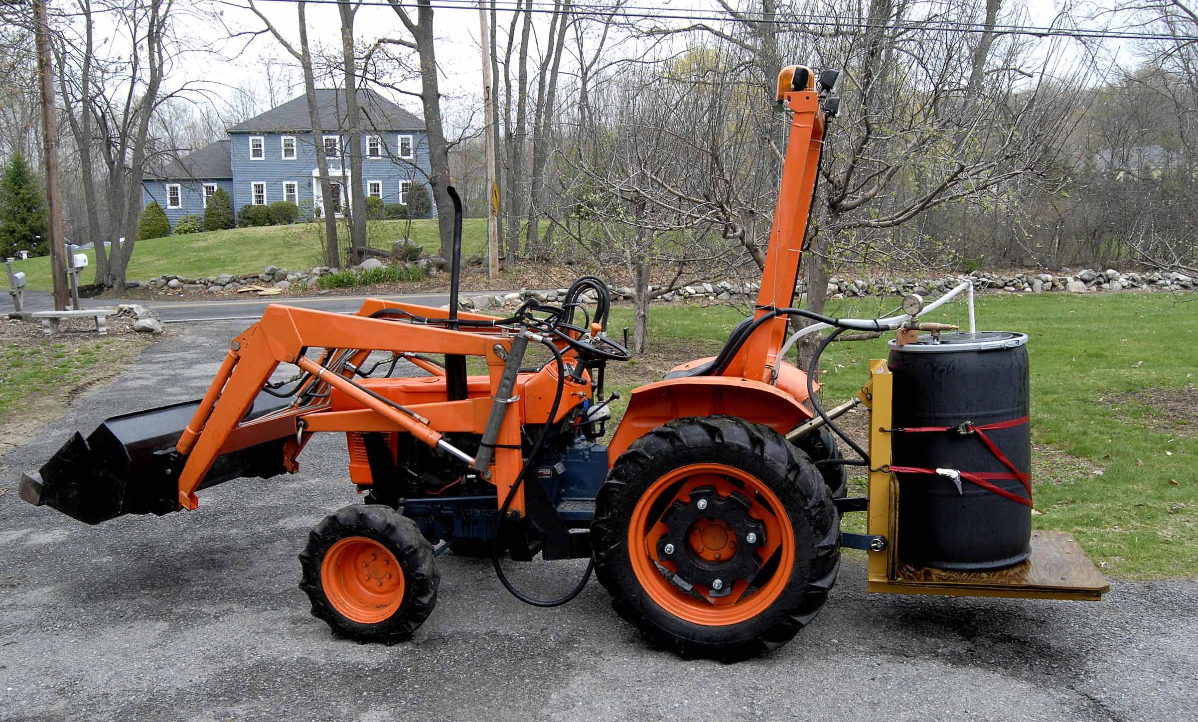

The tank is on a TSC carry all, that doubles as ballast holder in when needed. TSC 2128210.
They spray wand is TSC 2107044. This was a problem at first, it's rated at 8 GPM. 800 PSI. Not enough flow at 200 PSI. I took off the aluminum tip and drilled it out about 5 or 10 thousandths. If you do so, be sure to keep the new orifice size under the edge chamfer to allow for spray. If you go bigger I would guess the hole would not spry well if squared and would need a new chamfer inside and out. I could be wrong on this, have not done too much with nozzles.
That's it. The total cose is about $200 to $250 without the carry all. It will spray about 20 feet and is great for my semi dwarf apple trees and general spraying.
Best to all.

/ Custom Sprayer #6
440# of liquid plus the weight of the barrel, carryall and plumbing looks like a lot of weight out on the back of that CUT. Pretty slick setup though, I like the removabale top barrel, that is a good idea.
/ Custom Sprayer #7
Just curious. Some of the suff I put in my sprayer makes a lot of foam. Do you get a lot of foam with your return going into the top like that?
/ Custom Sprayer
Hi Berniep,
Foam? I get foam like Lucy and Ethyl on a bad day doing laundry. :) I don't have a problem though since my intake pipe is right on the bottom of the barrel, I cut a chunk out to keep be sure it pulls liquid instead the barrel. it's a about 1/2" up and at a 45 degree angle. When I'm done I pull the tie downs off, pull off the lid and send a huge river of foam down my driveway. It's mostly air and I don't want grass where it goes anyway!
I was wondering about an anti foam agent but since it doesn't create a spray problem I'll just live with it. The foam was with Round Up, have not shot Imidian yet. To me it's a small issue compared with a greater potential problem with poor agitation. My old sprayer was a plastic 33 gal trash can with lid hooked to a 6 hp gas driven power washer. I fed the hose input from the bucket and it worked fine for years. It shoots pretty much just like when hooked to a garden hose. To agitate I used an air caddie stapped to the rig and weighted a hose to the bottom. A slow air leak made bubbles that kept it all mixed well. I had to hope I didn't run out of air. I had also used a 12 volt RV water pump in the past.
This set up is best so far, agitates and allows me to put down more liquid in less time. It was cheap and pretty easy to build. One thing to note, the fittings need to be tight even when testing. You will be surprised how much pressure the pump makes. I wish it would shoot more than 20 feet, maybe a new nozzle at some point will get me more distance.
