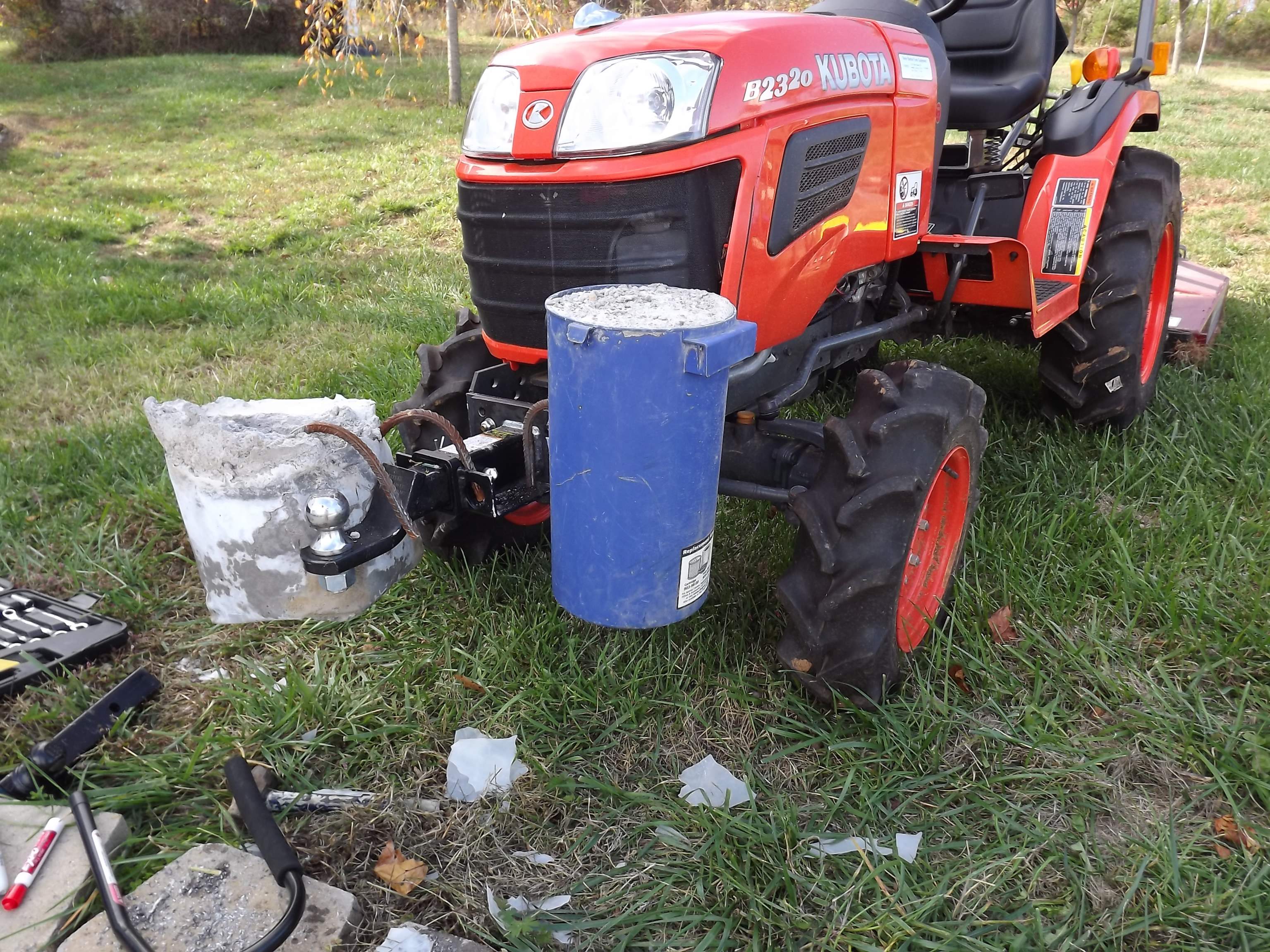

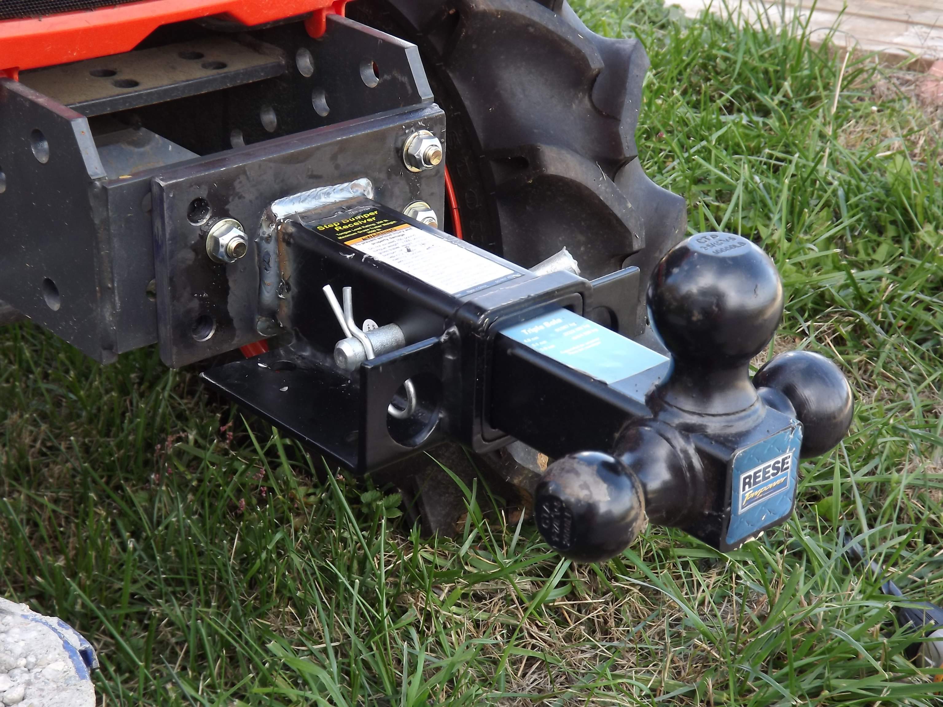

I had the same problem with my B2320 with the front end going for the sky. This is my fix with Sakrete hanging on the front end. It's ugly and I've since gotten some exercise bar weights that look better that I'm going to use.

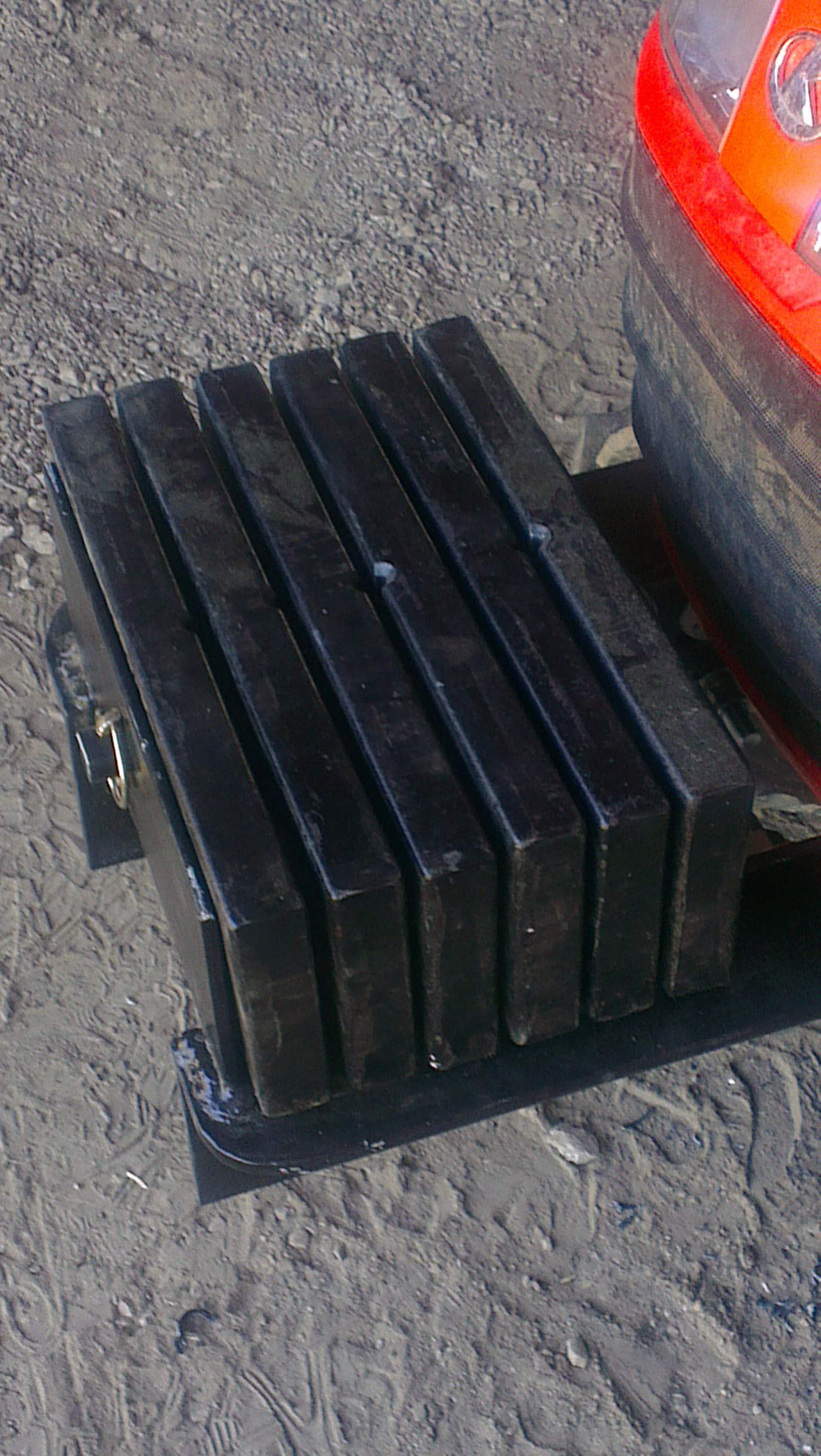

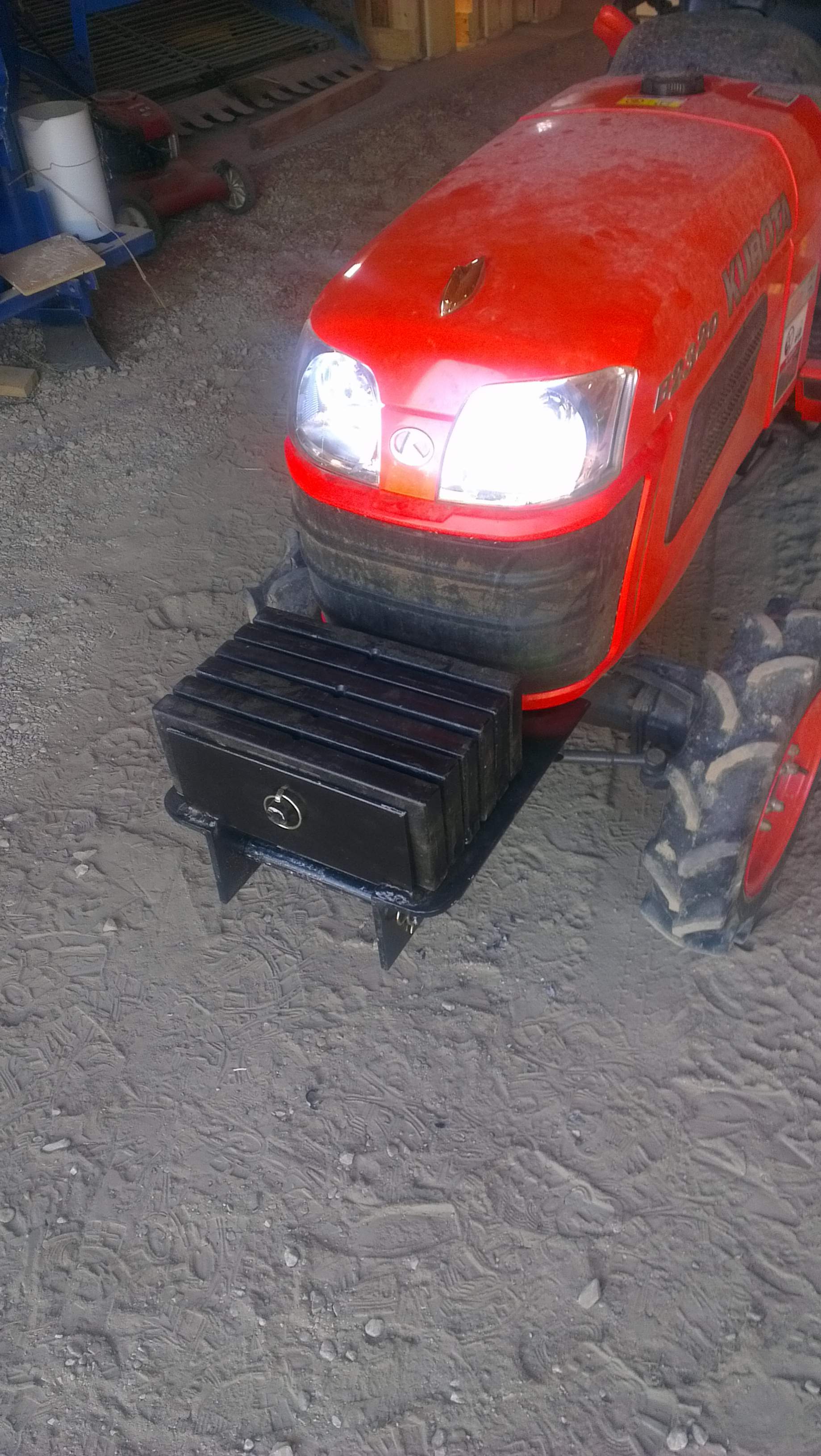

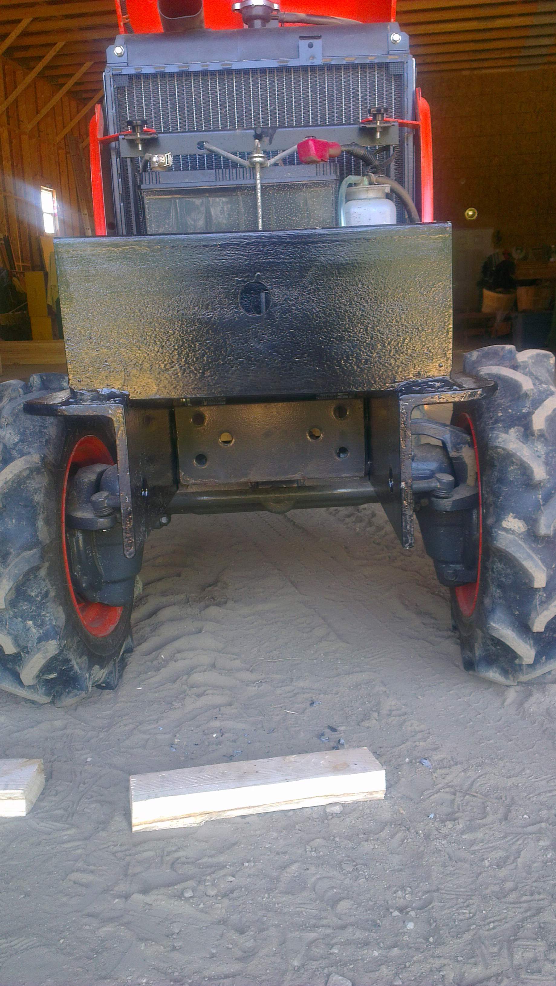

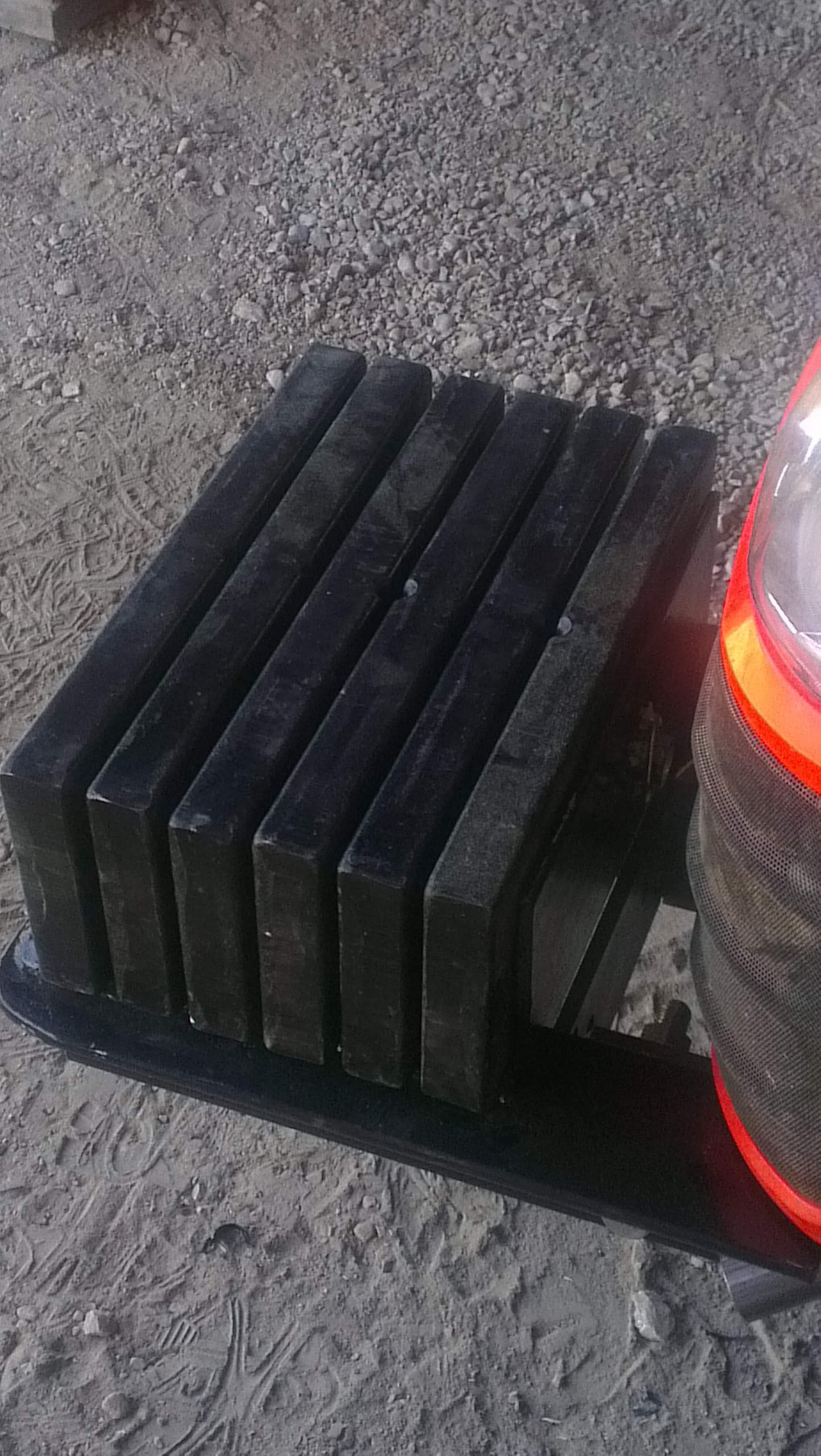

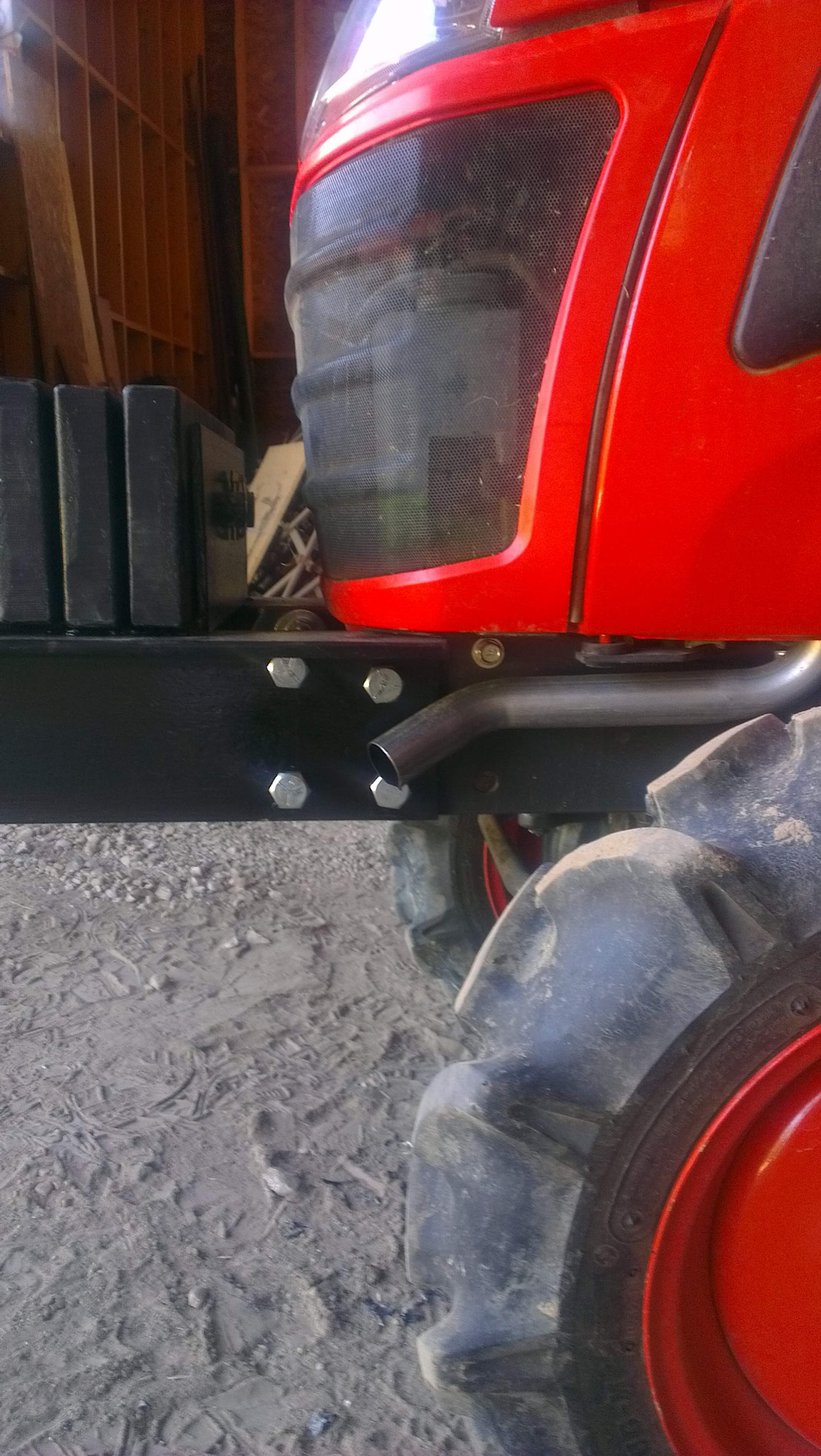

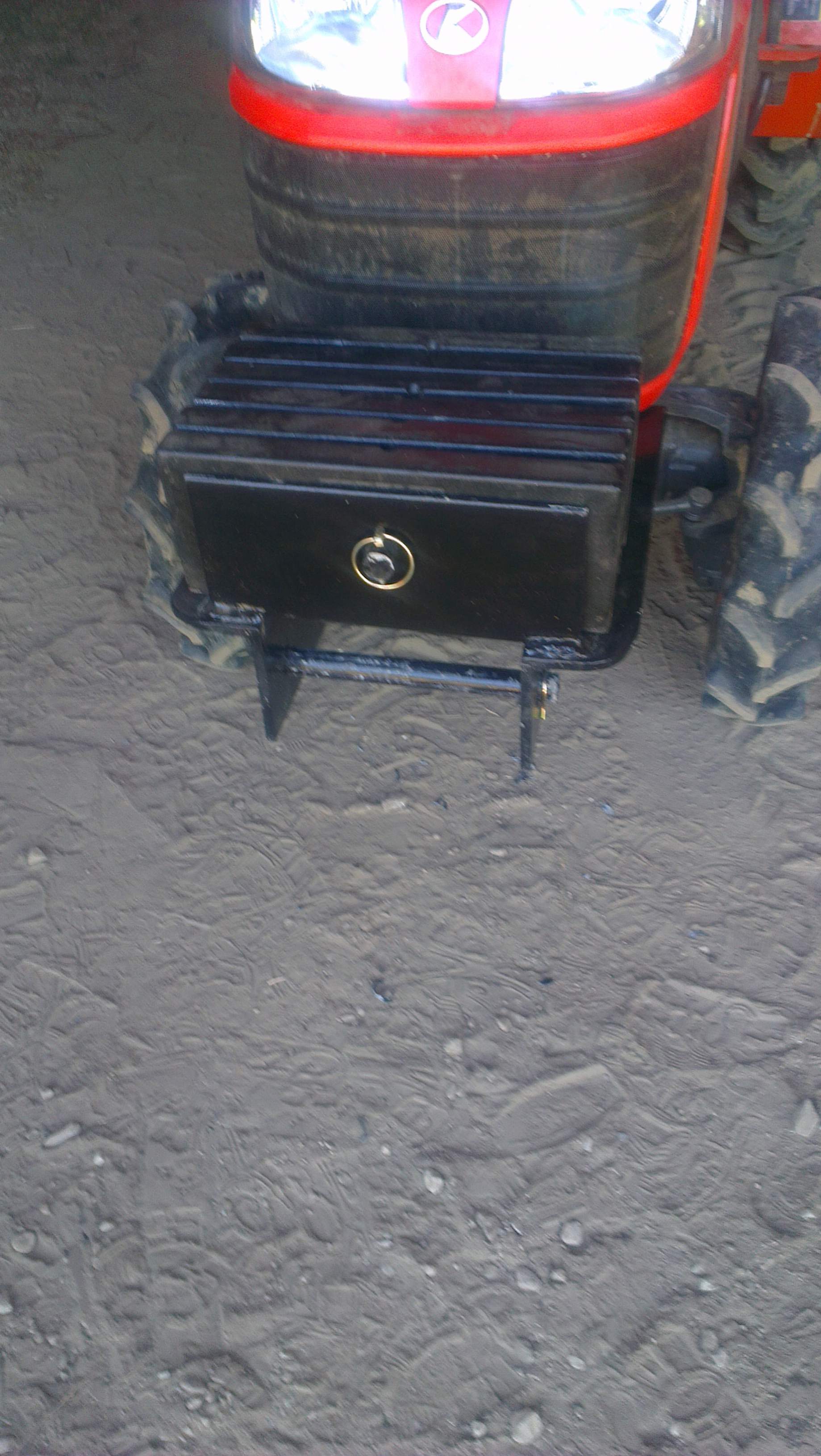

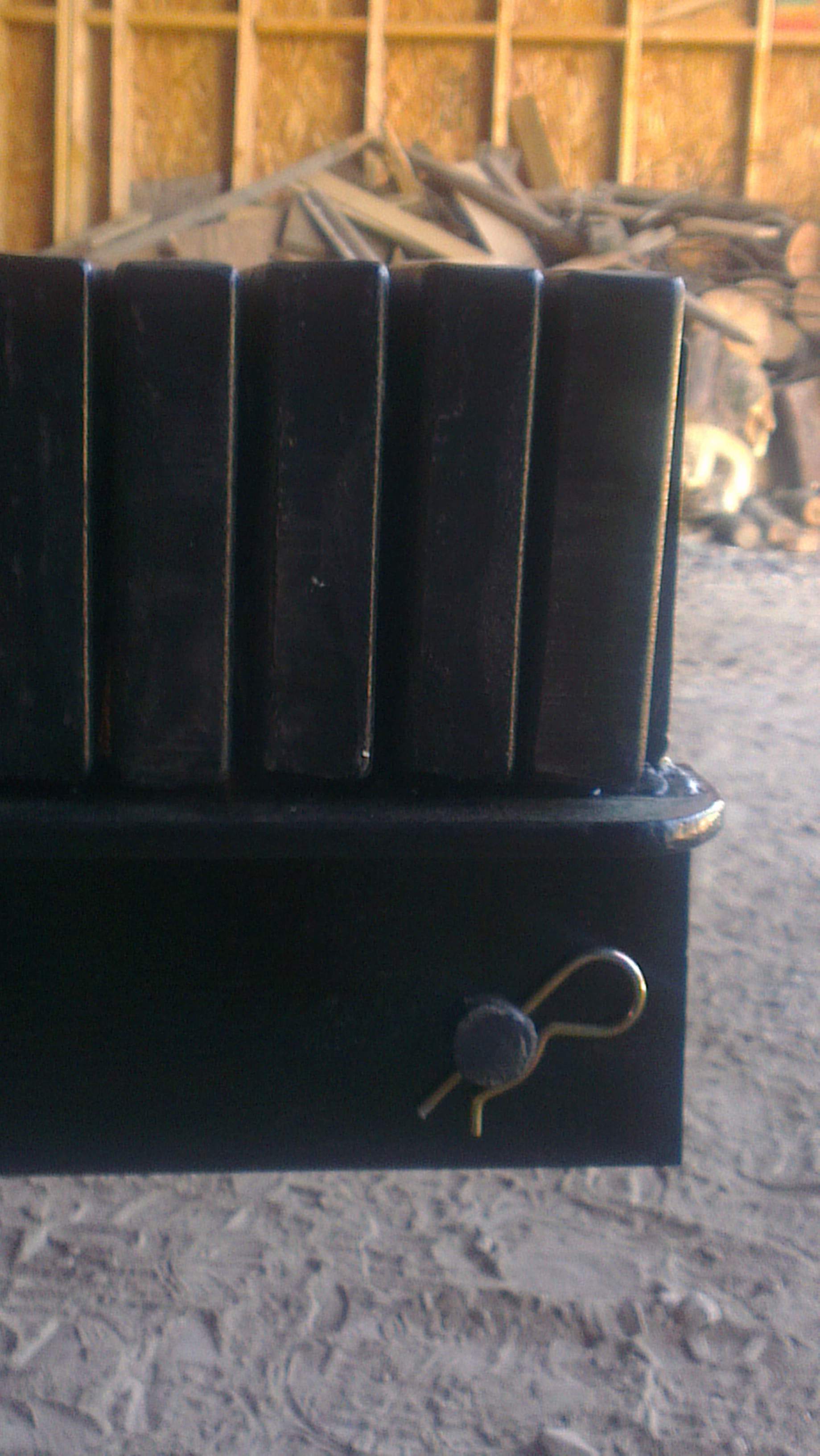

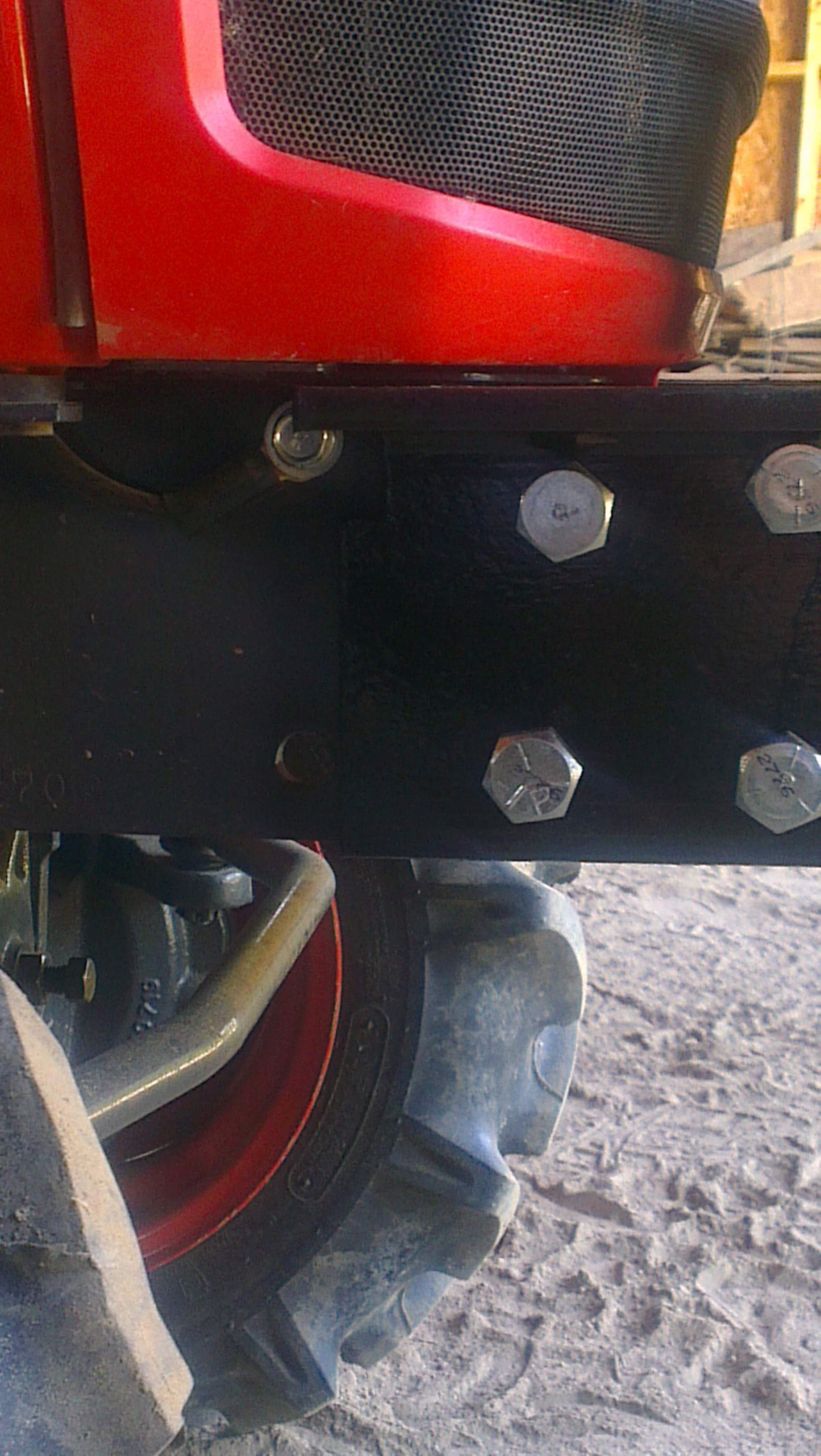

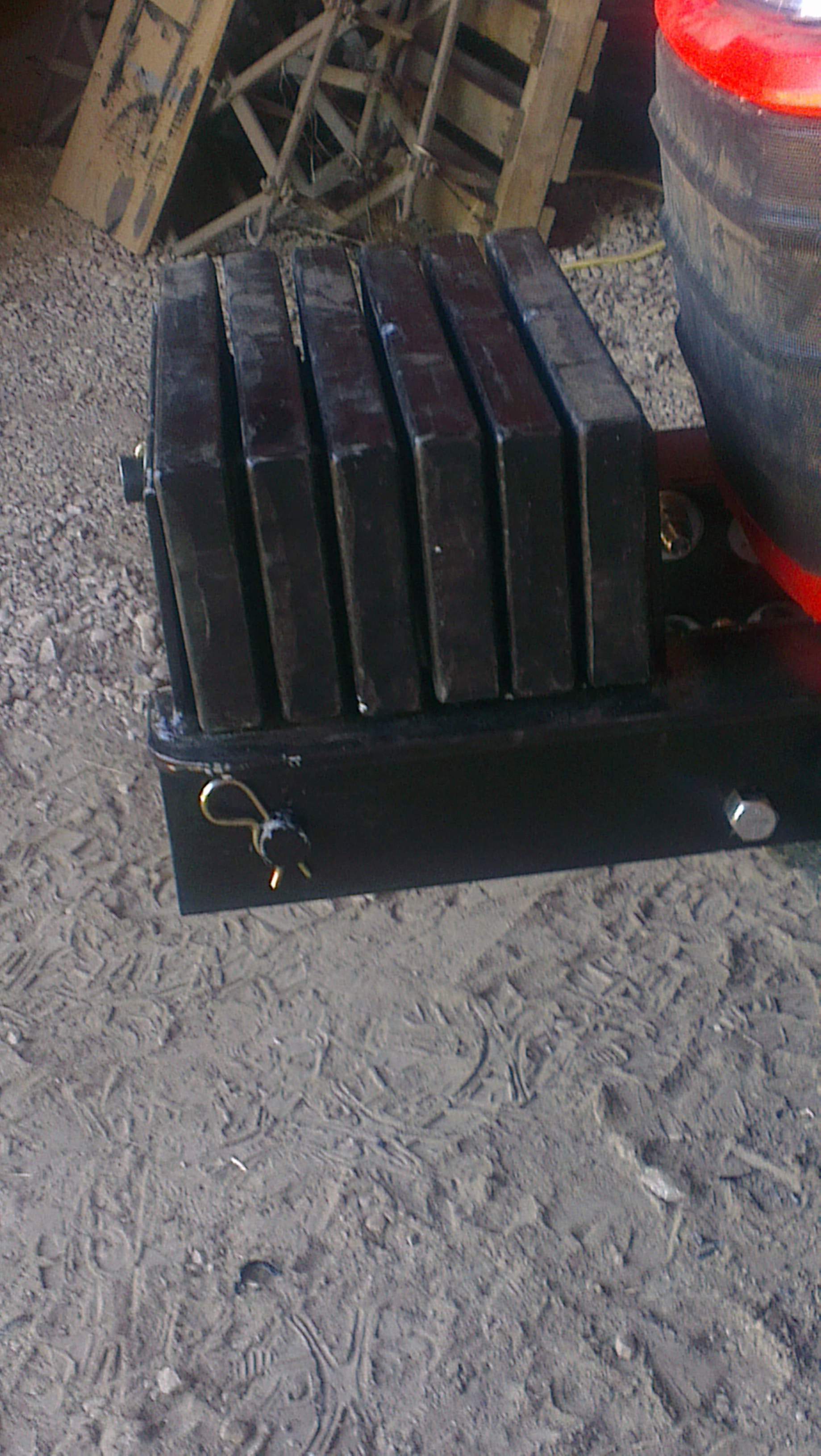

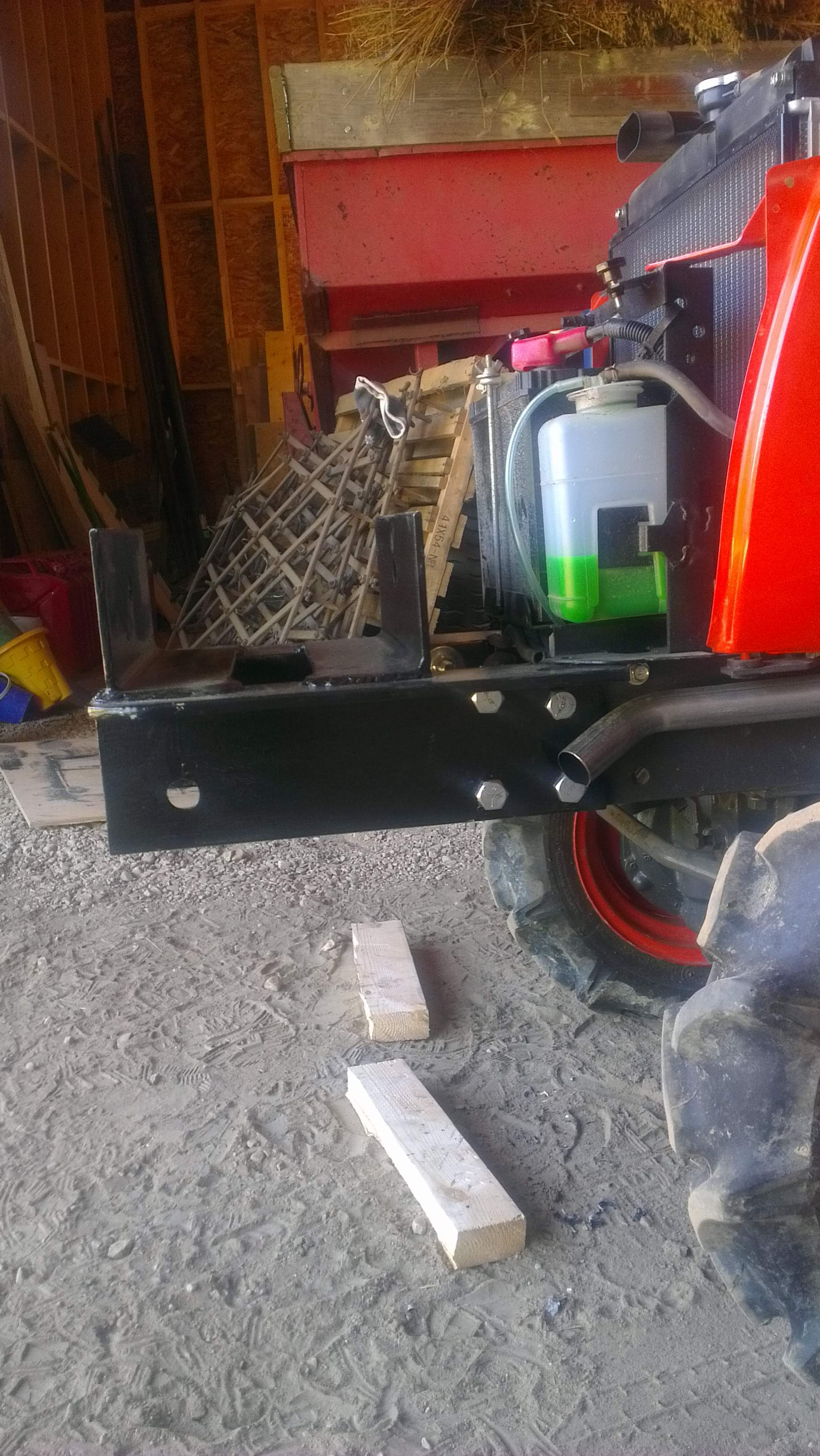

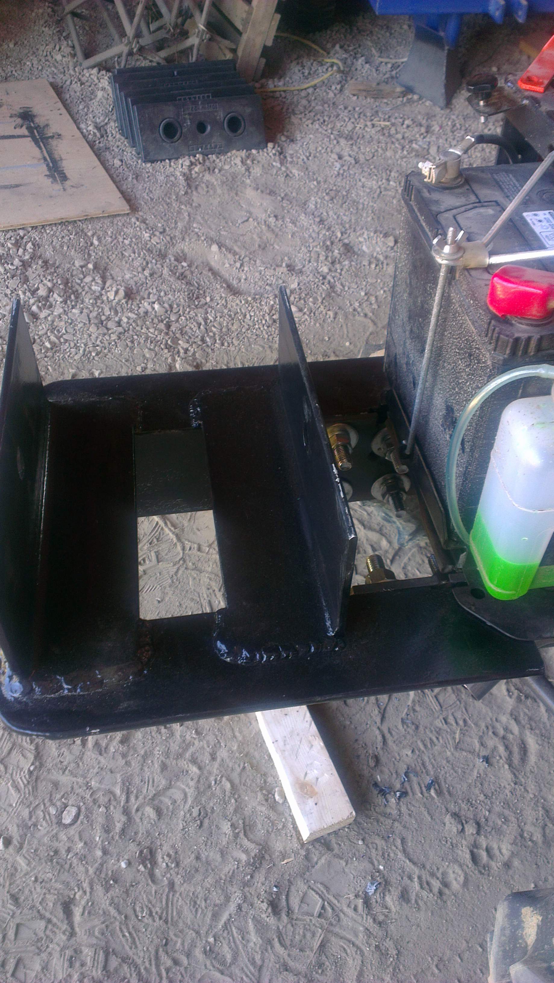

Here is my solution (3/8" and 5/16" angles, two 1" solid rods, all A36 steel, bolts are 5/8"). Angles had to be custom cut/fitted because of electrical ground bolt and exhaust pipe. The rod at the bottom can be used to pull the tractor out of trouble or pull things with it. The weights are from exercise equipment,
22lb each. Got them for free from kijiji. All together my setup is about 150lb.

Very Nice build. I was going to do something similar to yours however I have a FEL and wanted the setup to be easily removed.
I like you drop pin in the center nice touch.
