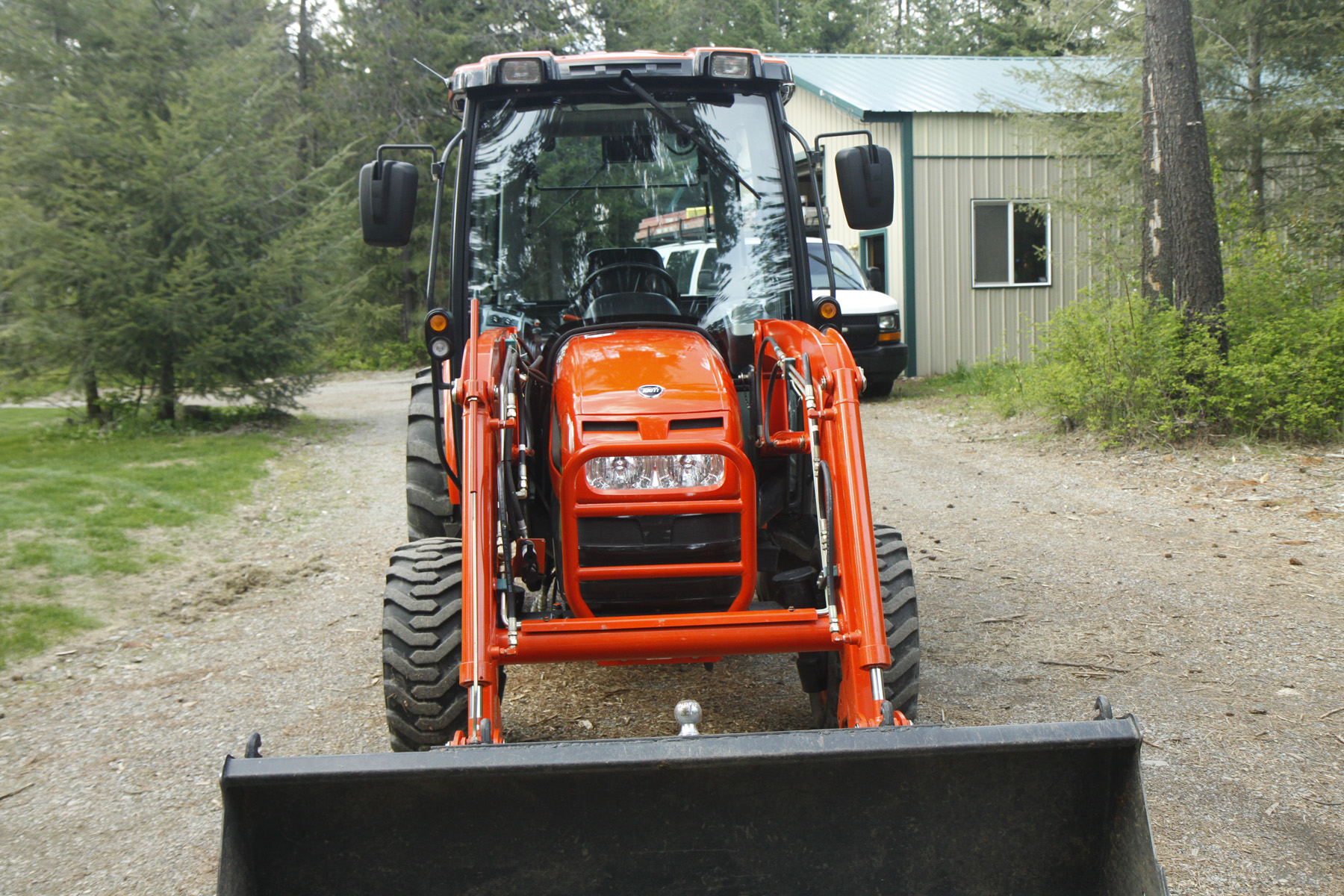

thats weird. my 2010/2011 DK45 has a real beefy brush guard. i guess they cheeped out in later years View attachment 678581
I think your 100% correct. Look at the OP's recent guard compared to Eric's guard. His is a much stronger design, and is more similar to your 2010 guard. It really does appear Kioti "cheeped out" for awhile on Brush Guard designs, and then returned back to strong designs

I have an NX with same guard as Eric. First year had a huge stump fold it and luckily missed the hood. Repaired and reinforced it. Finally last week I added some expanded metal and repainted.
   / Custom built brush guard for DK 4710 SE #18
My 2012 brush guard is very sturdy.Of course I don't use my tractor like a bull dozer either.OP nice work on the brush guard..
