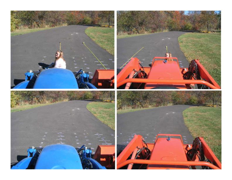

Yup, the difference is dramatic. And that difference is why the curved arm, sloped hood tractors are much easier to use.
The photo pretty much tells the story. My daughter is sitting 24" in front of the bucket lip. All the pictures were taken from the drivers seat, by me, with the seats adjusted as I would normally sit. I did my best to provide close to the same frame of reference in all the photos. The tractors were lined up so the bucket front edges were sitting side by side. Notice how much of the bucket you can see on the NH and how little you can see on the Kubota.
The farthest mark on the driveway is 6' in front of the lip of the bucket, on the Kubota your view is obstructed to 5'9" over the hood or 6'8" over the grill guard. You cannot see the top corners of the bucket on the Kubota.
On the New Holland you can see the ground at 2'10" over the hood. You can see the top corners of the bucket on the NH. The ground is visible 24" in front of the bucket on either side of the New Holland hood over the top of the bucket.
I am 5'11" tall, so someone taller would have a slightly better view, someone shorter would have a worse view.

/ Curved Loader & hood vs. Standard loader & hood #11
I think it won't be too long before all the Botas have the curved design. My BX2350 is curved, so I expect this will continue with new models...
And yes, the view is better in the 2350 than it was in my old 2200...
