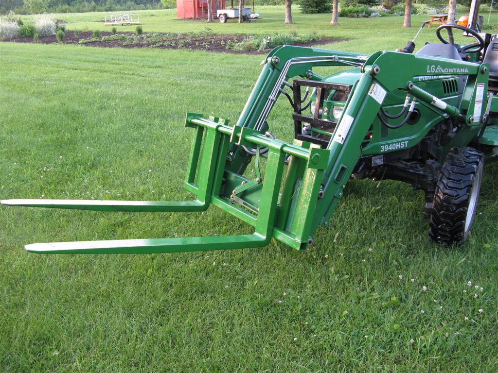

I have the non-curved loader arms; I have not had the opportunity to try a curved profile so I am not sure what is better. I suspect that there would be very little difference when attaching buckets, but better visibility when working?
This is my "straight arm"

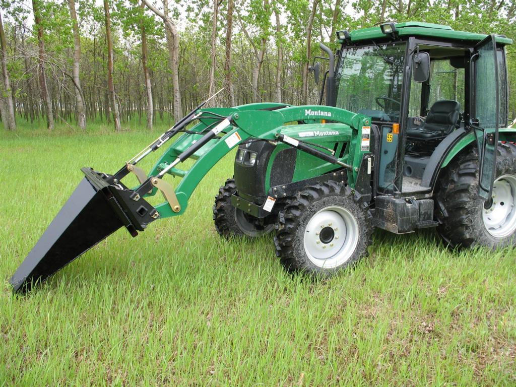

vs a curved one (courtesy of another member here - I borrowed this pic for ideas on a cab for mine)
You are correct that is exactly what I was talking about.
