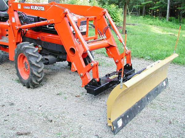

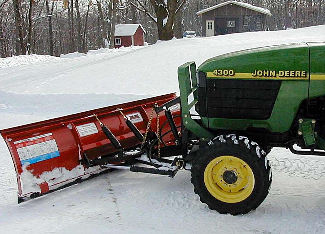

5 minutes??? not on a bet. Curtis sends the plow unfinished, requiring the mounting eyes to be welded in place to fit the loader that it will be used on. The good news is the blade uses the pins from the loader. the bad news is they are a very precise fit and close is no cigar. This is a job for a flat concrete floor. I was able to put it on with a rubber mallet and a wood dowel for a punch. The "mechanic" that first installed the loader at the dealership used a single jack sledgehammer apparently since the pins were peened. As I mentioned, I plan on leaving the Curtis blade on all winter. I don't worry about using the bucket for snow since this blade setup will make snow "ramping" pretty easy. My technique is to plow until the snow starts spilling, then I turn and dump. If I lift my blade as I come to a stop, it forms a ramp. As the snow continues, the ramps get longer and higher. I usually make them every 50 to 75 feet. This prevents getting "bermed in" as the season goes. Sometimes it is the best way to store alot of snow in a limited space

Have one for my 2910. Would not do it again. Make your own from a truck plow or buy a blower. It is a bear to mount/dismount /w3tcompact/icons/mad.gif. Used it one season on TC29d and could not steer it due to front end lifting when pressure is applied to blade, steering brakes on wrong side with hydro. Supposed to be used in float position. Had fit to my new 2910 this summer, we will see how it works. This tractor has a manual cruise control so the steer brakes should be useable. I have a 200' gravel and 300' field road to plow.

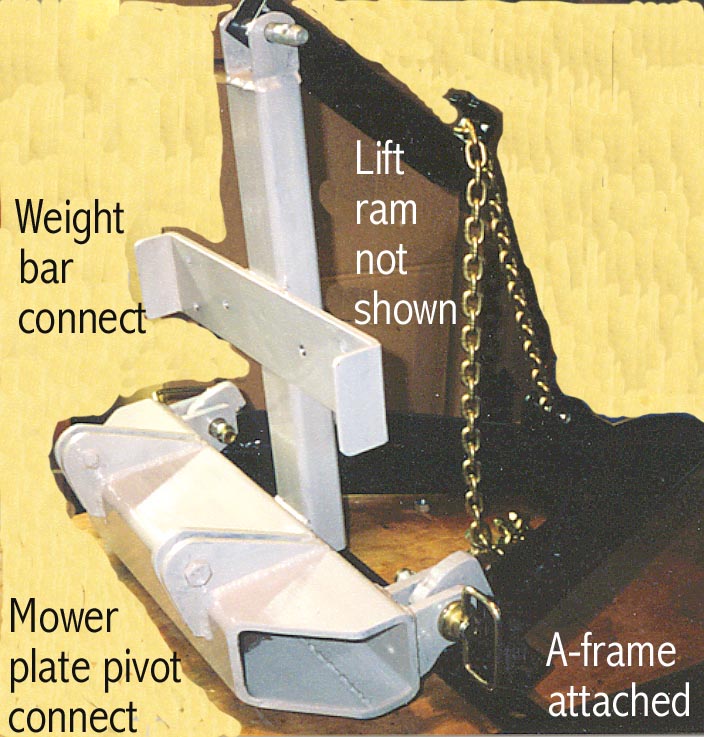

I've had a 6' Curtis that I widened to 8' and it works fine on my B 2710 for a few years now. But I did un hook the top loader arms, Weld a clevis hook the the center of the crossover tube for the loader arms. Then a chain between the plow bracket and new hook for raising the blade. This allows the blade to pivot freely. My drive is gravel and has given me no problems. If the edge of the blade gets too far into the bank it just pushes the front over. Hope this helps you
