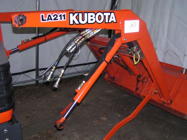

Bob,
Is it possible to quick detach the FEL without removing the cab completely? I looked at your front picture and it seems like the windshield may swing up to allow the joystick to tilt off with the loader but that is just my guess. I've looked at CozyCab and Sims and they can't.
Thanks,
Michael

Yes, it's possible but not in the traditional manner. You must remove the pins from the cylinder and the loader arm instead. In this way the hydraulics remain mounted on the tractor when the loader is off. It's a pain in the but to get them realigned for reinstallation but I'm working on a plan with the Dealer to address this. The new models have been re-engineered to leave the controls on the tractor while detatching in the normal way.
Here's a picture of the FEL detatched.
