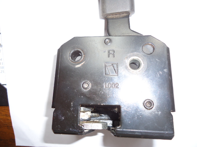

Just had an adventure with Curtis Cab parts service. Not good. The Door latch broke for the second time on a two year old cab ( I did repair it the first time myself). Its stamped with a part number 1002 R. Parts service said they needed a part number and wanted to know, which side it was for (1002 R) I told her "R" I assumed stood for "right"(conversely the one marked "L" is on the left side). She told me I would have to go directly to a dealer. They have an online parts breakdown that you cannot access. The latches on the window keep loosening up. The wiper switch gave out at 1-1/2 years. The roof leaked. I recommend stay away from Curtis. DSC01391.JPG.

Just had an adventure with Curtis Cab parts service. Not good. The Door latch broke for the second time on a two year old cab ( I did repair it the first time myself). Its stamped with a part number 1002 R. Parts service said they needed a part number and wanted to know, which side it was for (1002 R) I told her "R" I assumed stood for "right"(conversely the one marked "L" is on the left side). She told me I would have to go directly to a dealer. They have an online parts breakdown that you cannot access. The latches on the window keep loosening up. The wiper switch gave out at 1-1/2 years. The roof leaked. I recommend stay away from Curtis.View attachment 368318.
The part you are looking for is P/N 9DL01B. <--- This is the part number for the left hand door latch, which is actually marked with an R. The part number for the right hand door which is stamped with an L is P/N 9DL01A. These two door latches are actually installed upside down. Thus the R part on the left door and the L part on the right door.
For the outside door handle it's P/N 9DL01C.
Hopes this helps you.

I know this is now a 16 year old post, but I wanted to give anyone else a chance at repairing their Curtis cab. The afore mentioned latch assembly is apparently common to several doors from Curtis Industries.. I was able to dig up some old PDF manuals and was able to verify some part numbers for reference. I got lucky and found a replacement latch on eBay from a vendor in Canada.
  • 9DL01A is a Curtis 'code number', the part# is 70000-01016. The latch will be stamped with "L". This latch will be used on the right/passenger side for suicide style doors (per Curtis documentation)
  • 9DL01B is a Curtis 'code number', the part# is 70000-01017. The latch will be stamped with "R". This latch will be used on the left/driver side for suicide style doors (as is the case for my cab)
Hope this clears up some confusion and gives someone else a clue.
Good luck
