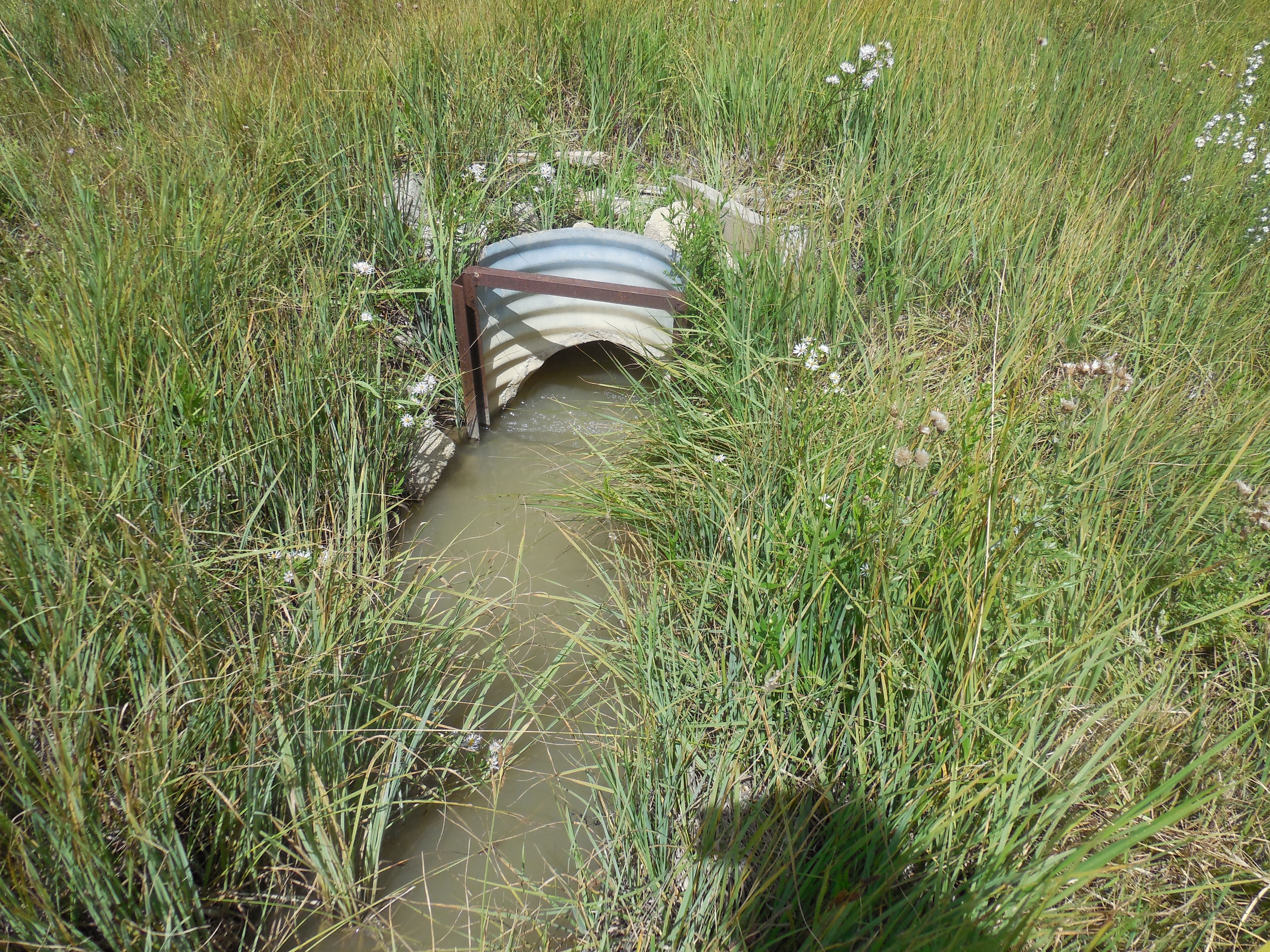

Silt fence is the black woven fabric with attached wooden stakes you see every where on construction projects. It's designed to allow water to flow through, but capture larger sediment (sand, some silt), but it doesn't prevent turbity very well, and clay particles are too small to capture well. It is Not a permanent product, it's suppost to last 12 months or so, but I'm thinking 8-12 ft across the ditch, maybe 20 ft upstream, would work for you.
I think you're severely overestimating my puny irrigation ditch. It was 24 inches wide after the last clean-out, but that was about 10 years ago.
Since then the grass has made it narrower, but the gravely and somewhat rocky bottom at this part of it tends to stay as intended.
There's a 2x6 in that gate, and you may be able to see that the water drops maybe two inches behind it...and behind that is the mound.
Basically, I'd need two feet of silt fence, if that, and if it were to plug up the water would not go to the best place possible, but end up in a pasture.

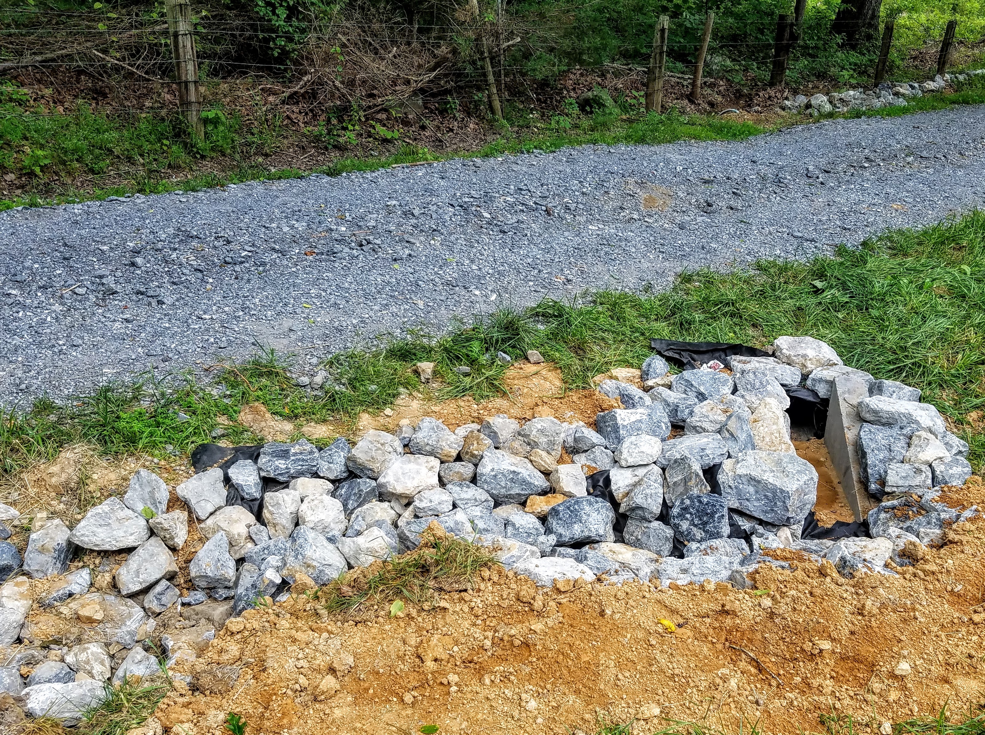

What I have done, copying someone else, is to build 3 rock dams before my driveway culvert, a few feet apart. Stops water, silt/soil sinks to bottom, and cleaner water will continue to the next. Besides the torrential downpour/flooding we have experienced the past 2 years, I only have to clean out once per year. I use the harvested sandy road soil to fill in low spots on my "logging" trails.
I try to keep the outlet clear as well, once I discovered soil build up there. The entrance has always been clean as a whistle...

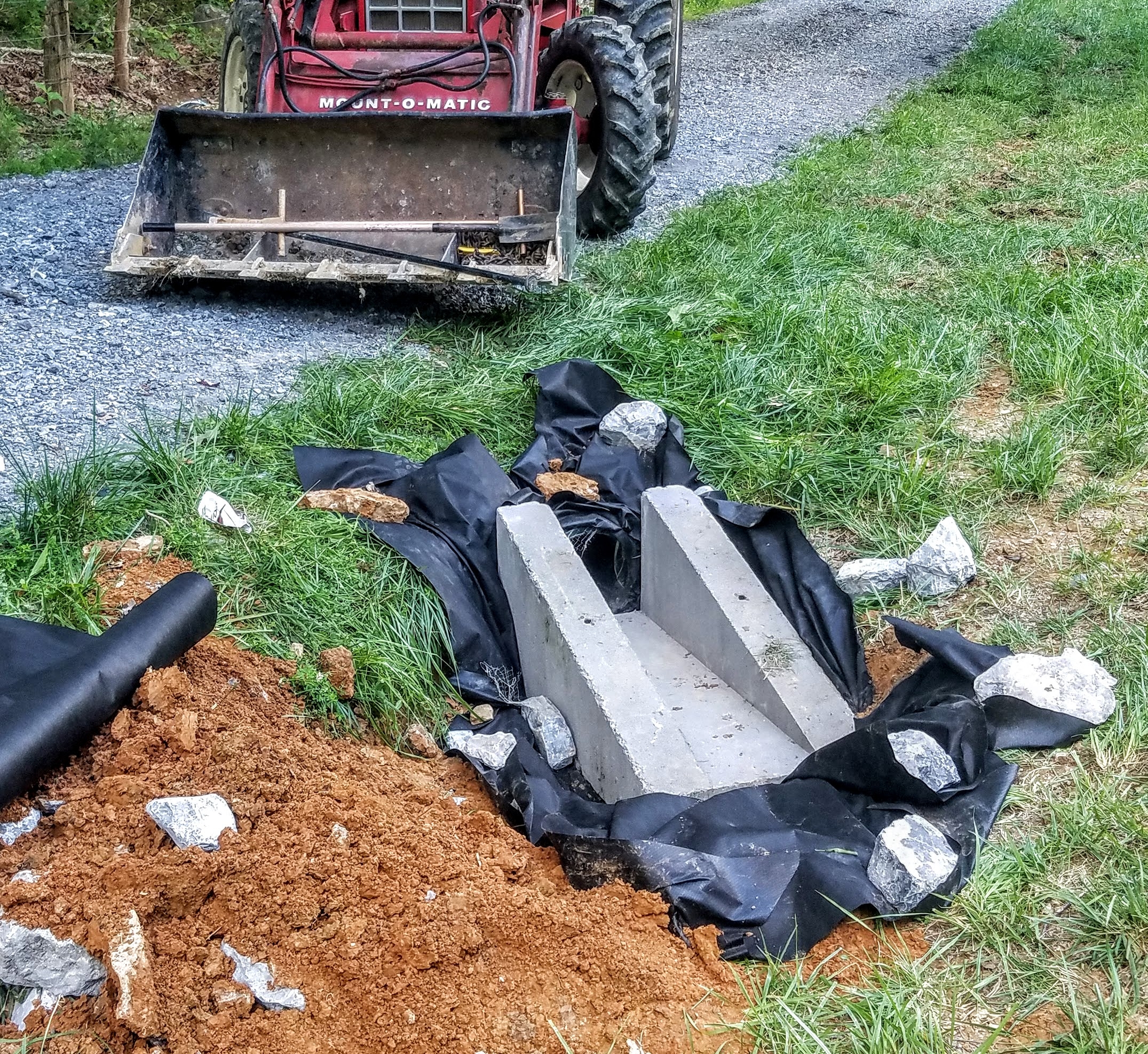

I installed 4 culverts six years ago,,
the inside of each culvert is spotless,, zero,, hardly even dust,,,
I did get carried away with the entrance of each ,,,
That concrete thing is on a slope,,
it accelerates the water so fast, the water is flying when it enters the pipe.
A leaf does not stand a chance!! :ROFLMAO:

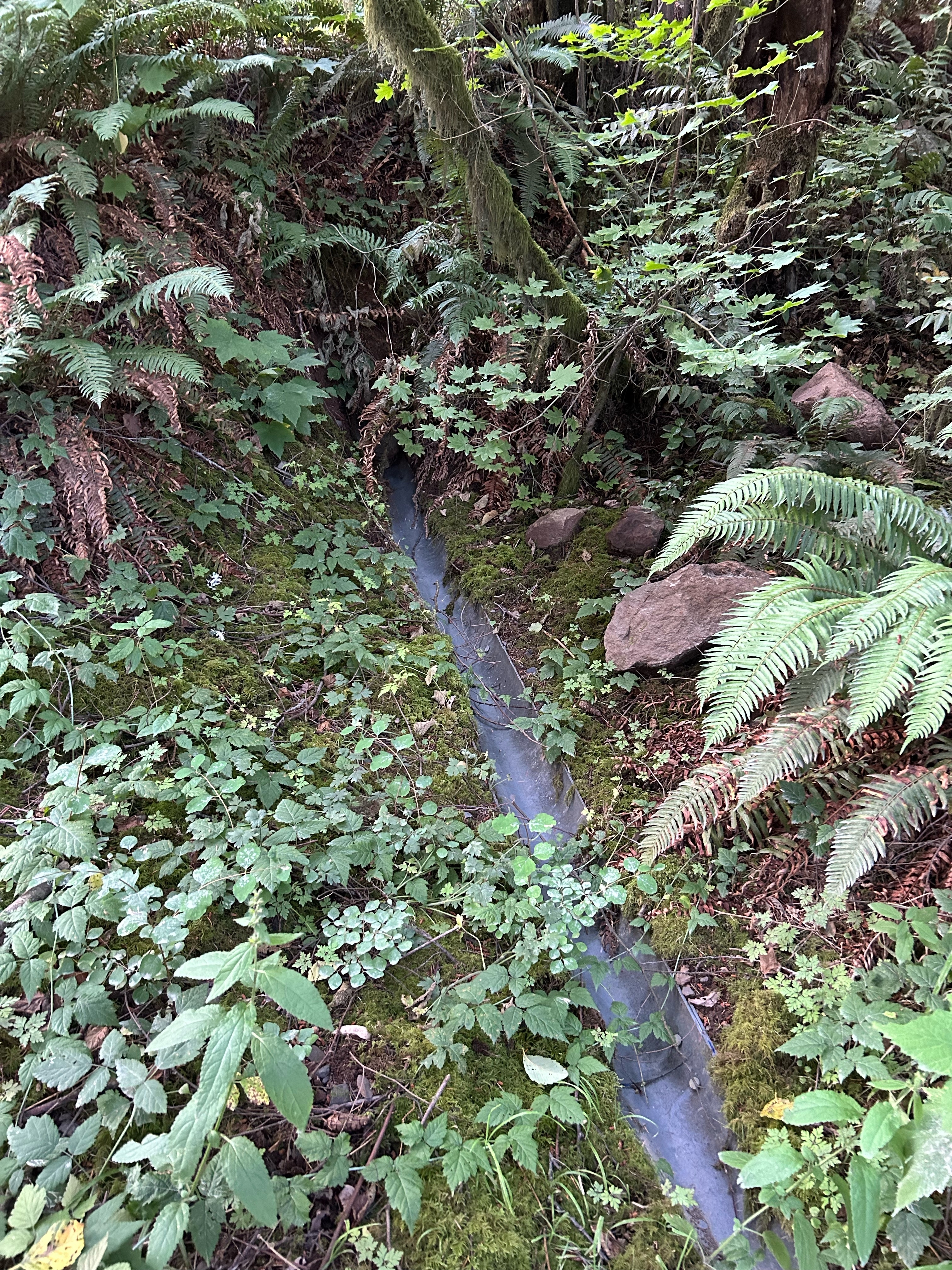

I have a steep 10 inch concrete culvert under the driveway. It has never clogged internally, except... The outflow area was a much flatter slope. The water slowing after leaving the culvert dropped sediment, eventually backing up into the culvert.
A 2nd hand store had an 8ft length of 8 inch pvc pipe. Cut in half lengthways and joined, it made a long, slick half-round outflow channel.
The silt still backs up, but it is now far away from the culvert and easy to shovel out in a few minutes once a year.
