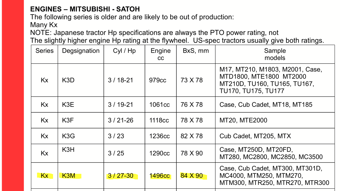

Jun 4, 2025 / Cub #1 R russ1` New member Joined Dec 26, 2008 Messages 4 Location Ohio Tractor CaseIh Farmall 95, Ford model 960 Where can I get a wiring diagram for a cub cadet 7274
Jun 4, 2025 / Cub #2 bmaverick Super Member Joined Sep 17, 2013 Messages 7,360 Location Beloit-WI Tractor Yanmar YM2610 ■YANMAR GURU■ EXTRAORDINAIRE russ1` said: Where can I get a wiring diagram for a cub cadet 7274 Click to expand... From the owners manual on the MTD website. Or from a Mitsubishi MT series with a K3M engine. You machine is really a Mitsubishi, not a Cub in yellow paint. It looks like a Cub, but it is not.
