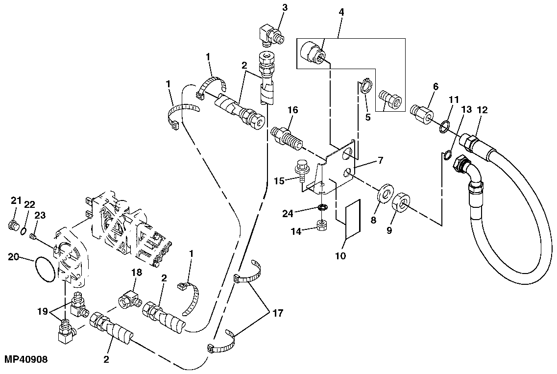

I'm having quite a time trying to get information about where the power beyond ports are on my Cub/Yanmar EX3200. I talked to my dealer but no luck, I probably need to go there and rifle through shop manuals to get an answer. I looked at the JD parts site for the 790 and 3005 models. Seems to be very similar. I just got my WR Long true third function kit the other day and am trying to get my stuff together to do the project this weekend.

The power beyond ports are on the front side of the loader valve. I found it in the technical manual. Looks like I need to take off some panels but the install looks pretty straight forward. I'll post pictured when it gets done.

Your CC is closer to the 2520/2720 I think rather than the 790/3005 series possibly. There should also be a plug (it's really a screw) that needs to be put in the block to direct flow to the ports.
I am very familiar with the JD hydraulic setup if you need any more help...
Below is picture of the 2520 PB setup if it helps you.
