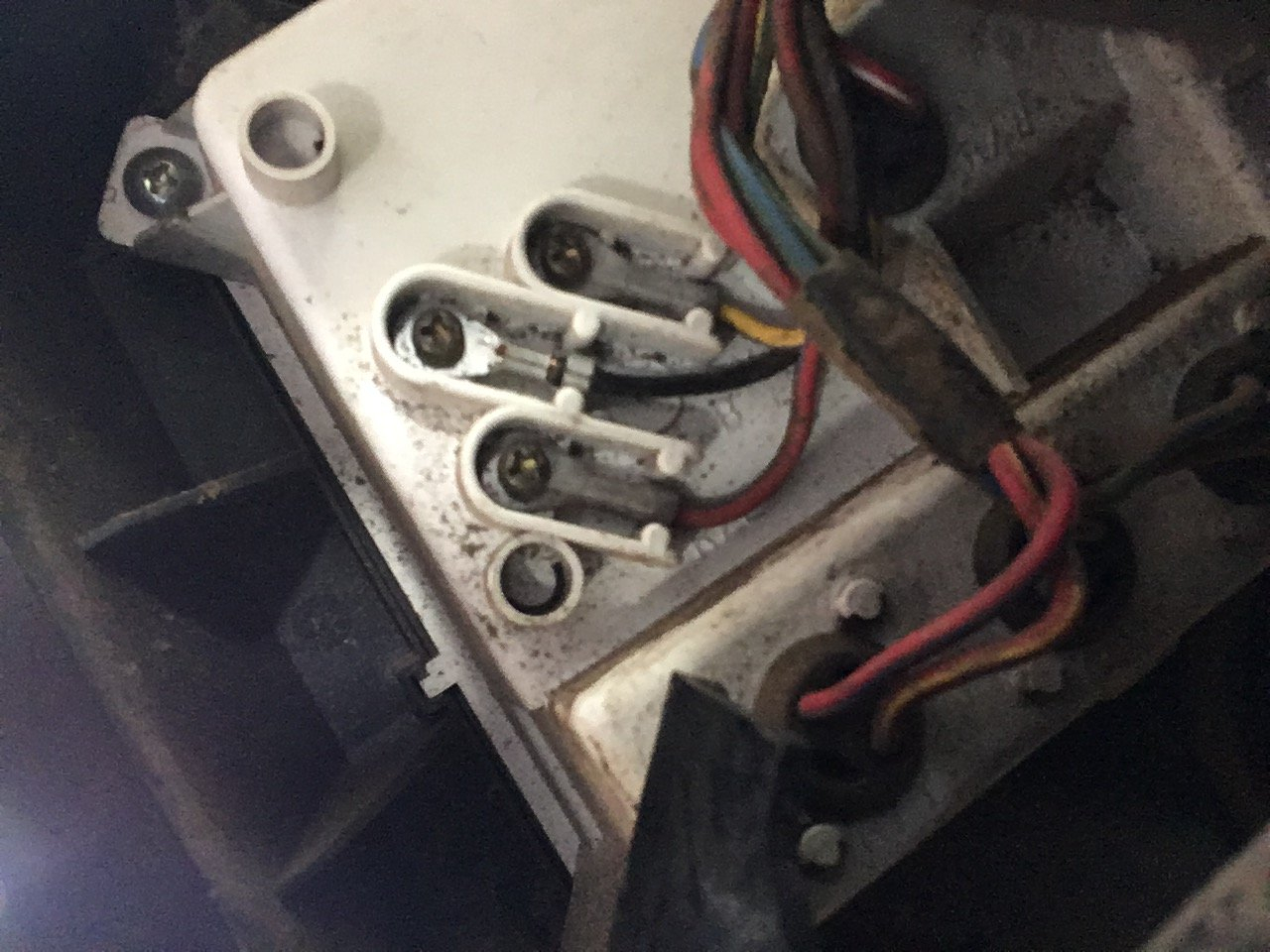

This is a pic of the back of the temp gauge on my EX3200.

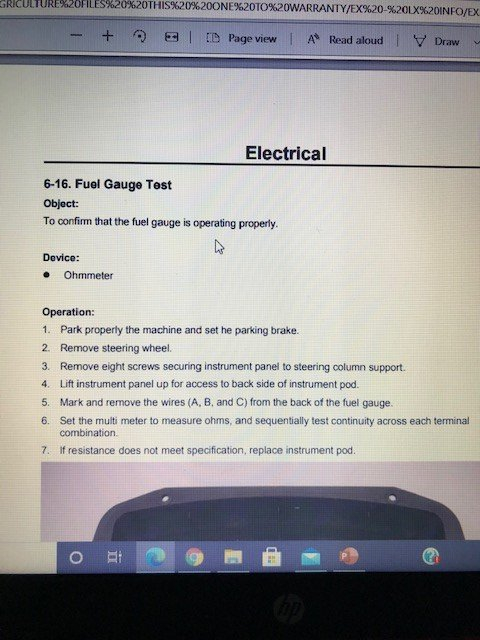

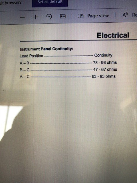

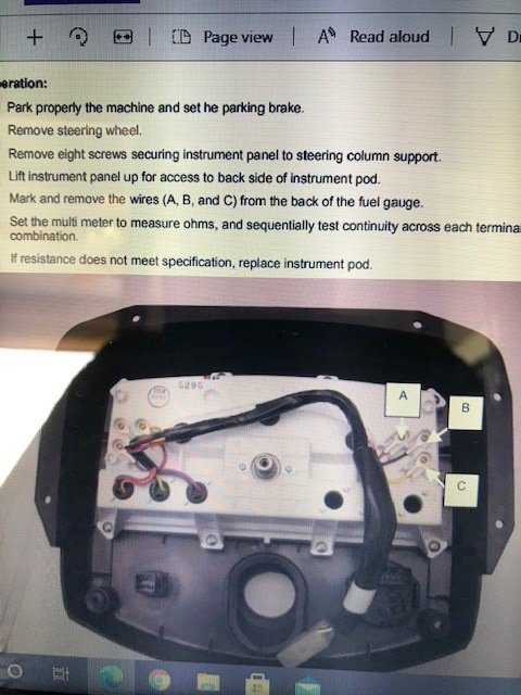

   / cub cadet yanmar EX3200 Gauges #7
Please see attached pics for testing Monitor panel for 3200
