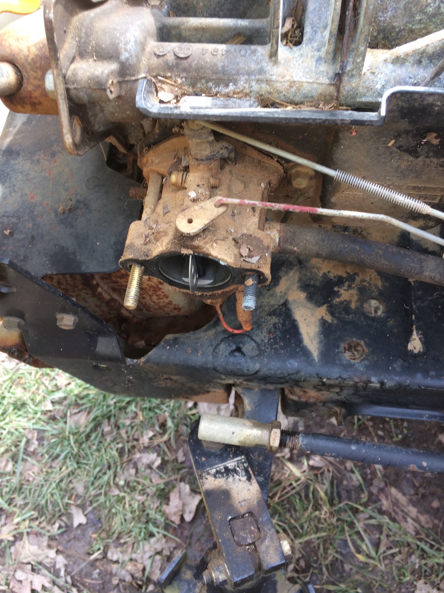

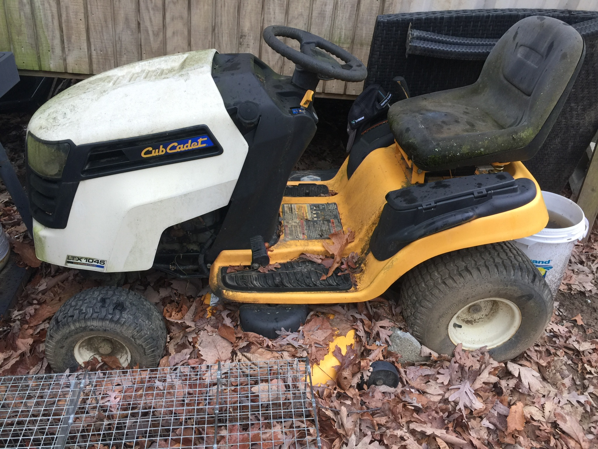

I recently got a cub cadet mower from a friend, it's a cub cadet ltx 1045. It was sitting for about a year or more before I got it. I bought a new battery for it, fuel filter, spark plug, just the regular stuff for something that has been sitting to get it going again.
He said the reason it was parked was because it wouldn't start, it would just "click" so I bought a new solenoid, it started up for just a second then would die, it did that about 3-4 times. Then it appeared to be flooded, (smelled gas & seen gas coming out of the carb). So I let it set for a couple hours but still the same, just turning over but won't start.
I pulled the spark plug back out to clean it if/since it was flooded then put it back in, still the same. So I started testing the usual thing like is it getting spark. It's sparking and I believe it's getting gas to the spark plug since it appeared wet when I looked at it.
The point/question of this whole thing is, what do you think is the problem, since it's getting gas to the spark plug, and its firing?
I think maybe something got stuck in the carb or something after the first couple cranks, or maybe one of the safety switches went out, but I just don't know.
The gas tank was completely empty when I got the mower so if something got lodged somewhere along the gas flow it would have to be in the gas line or the carb I'd think.
Anyway please reply asap and thanks...dylan

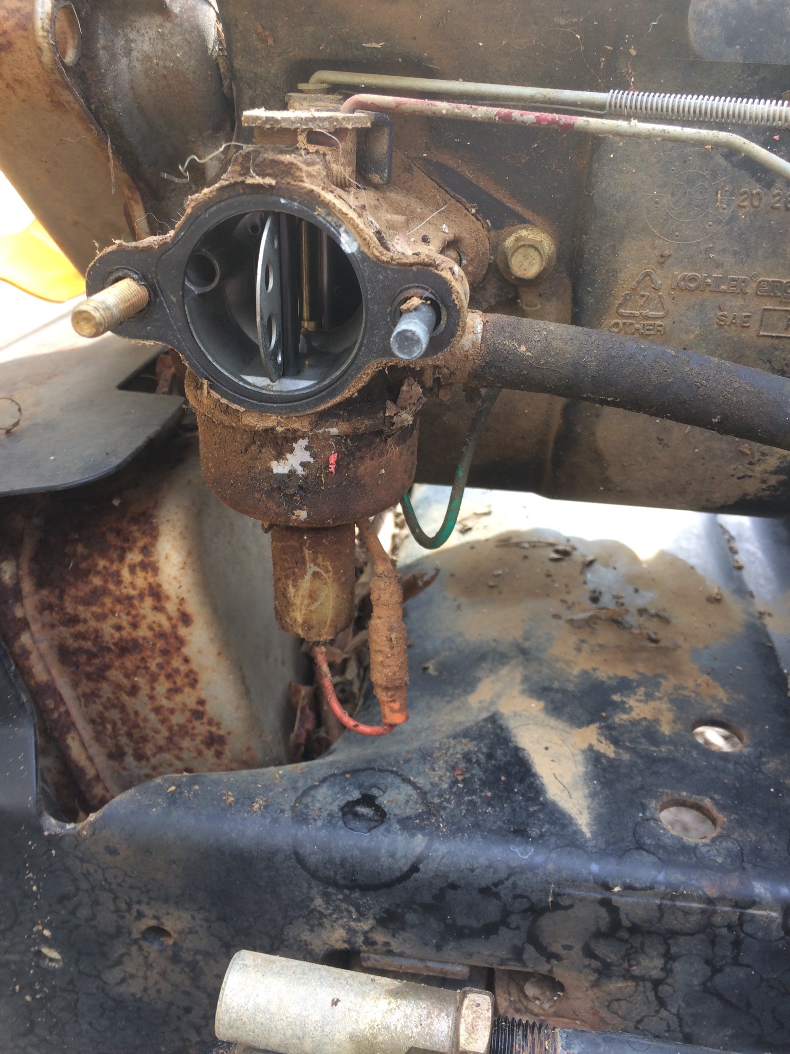

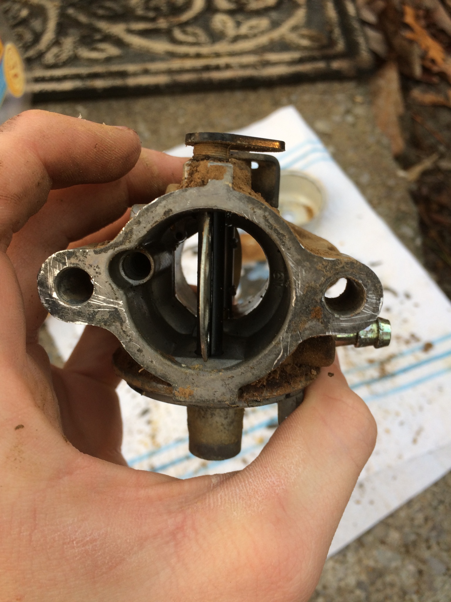

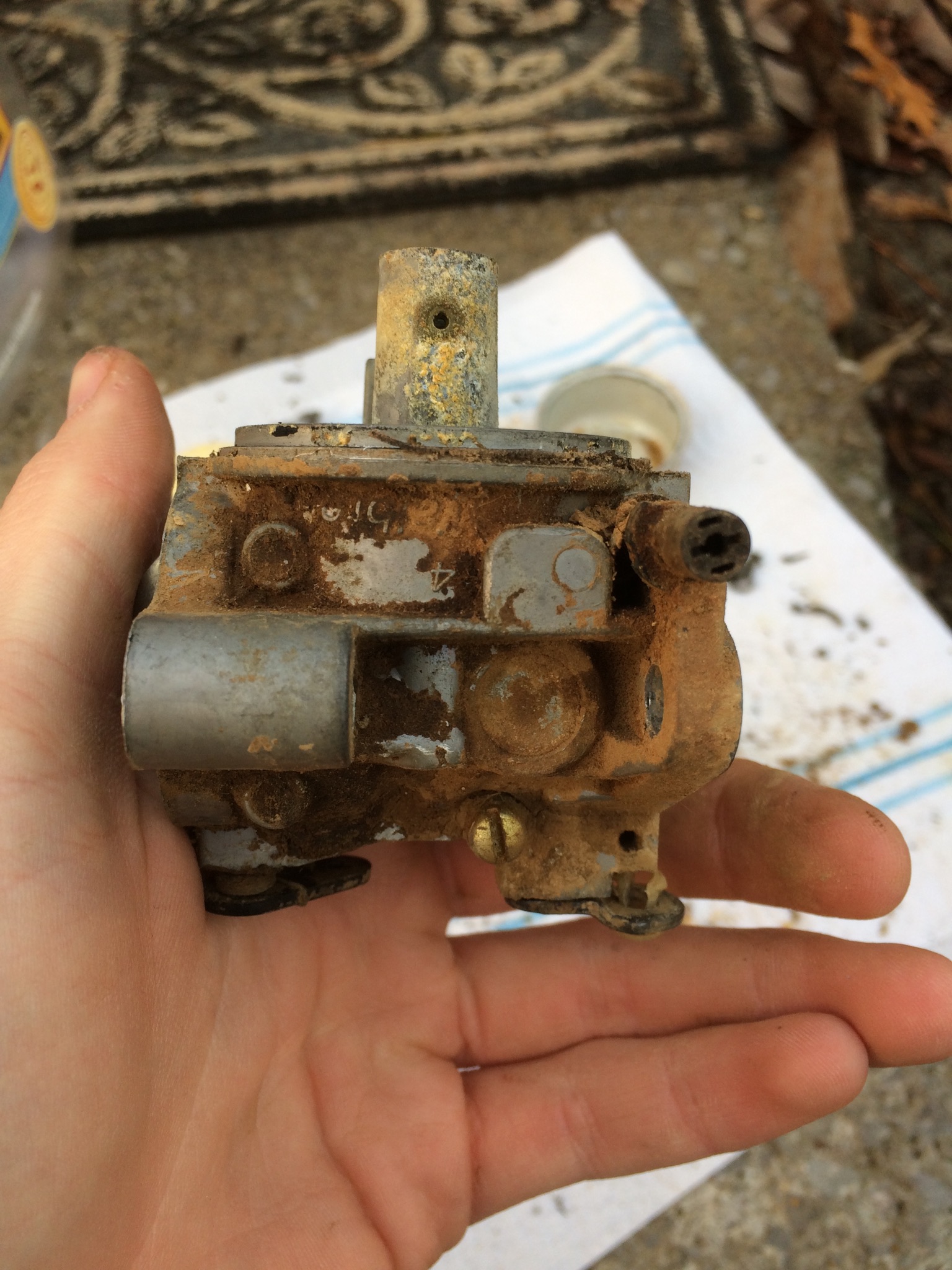

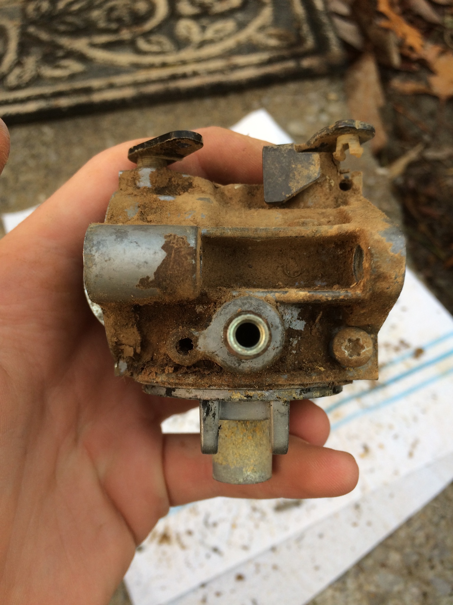

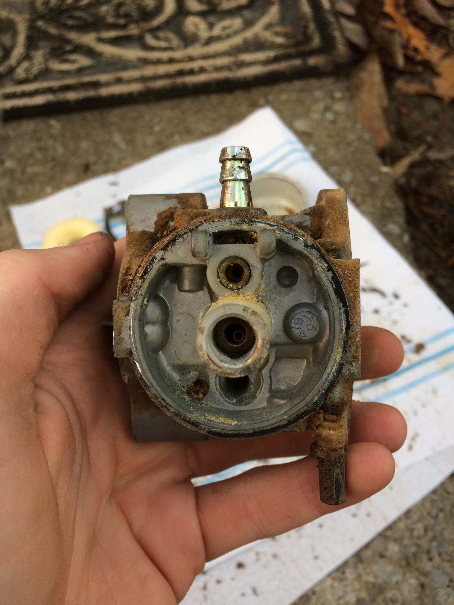

Hey guys and thanks for the replies, it's a Kohler courage 20 motor. I took the carb off and it's pretty rough, looks like it was sitting at the bottom of a lake for a while. I'll upload pics of it to show what it looked like before I took it apart, IMG_0942.JPGIMG_0943.JPGIMG_0961.JPGIMG_0963.JPGIMG_0966.JPGIMG_0965.JPGand then some of it after I took it apart.
The pics of the carb after disassembly is to ask if you guys think the carb is worth rebuilding or to just replace it?
/ Cub cadet wont start #5
Definitely rebuild. Just be sure that all of the flow ports are clear and the needle valve seat is good and the float/bowl are clean. Since you already have it off, you can take it to a reputable small engine repair shop and they will clean everything with carb cleaner and check out all critical parts. Those carbs can be tricky sometimes.
/ Cub cadet wont start #6
Other than general "gunk" everyplace in the carb. Pay attention to the float bowl shutoff pin and seat. Sometimes the rubber of the pin sticks to the seat and tears. Be careful cleaning the seat!
-R
/ Cub cadet wont start #7
First find out what kit plus dunk plus not knowing if you got everything costs vs new carb - you might be surprised. Good luck. Jim

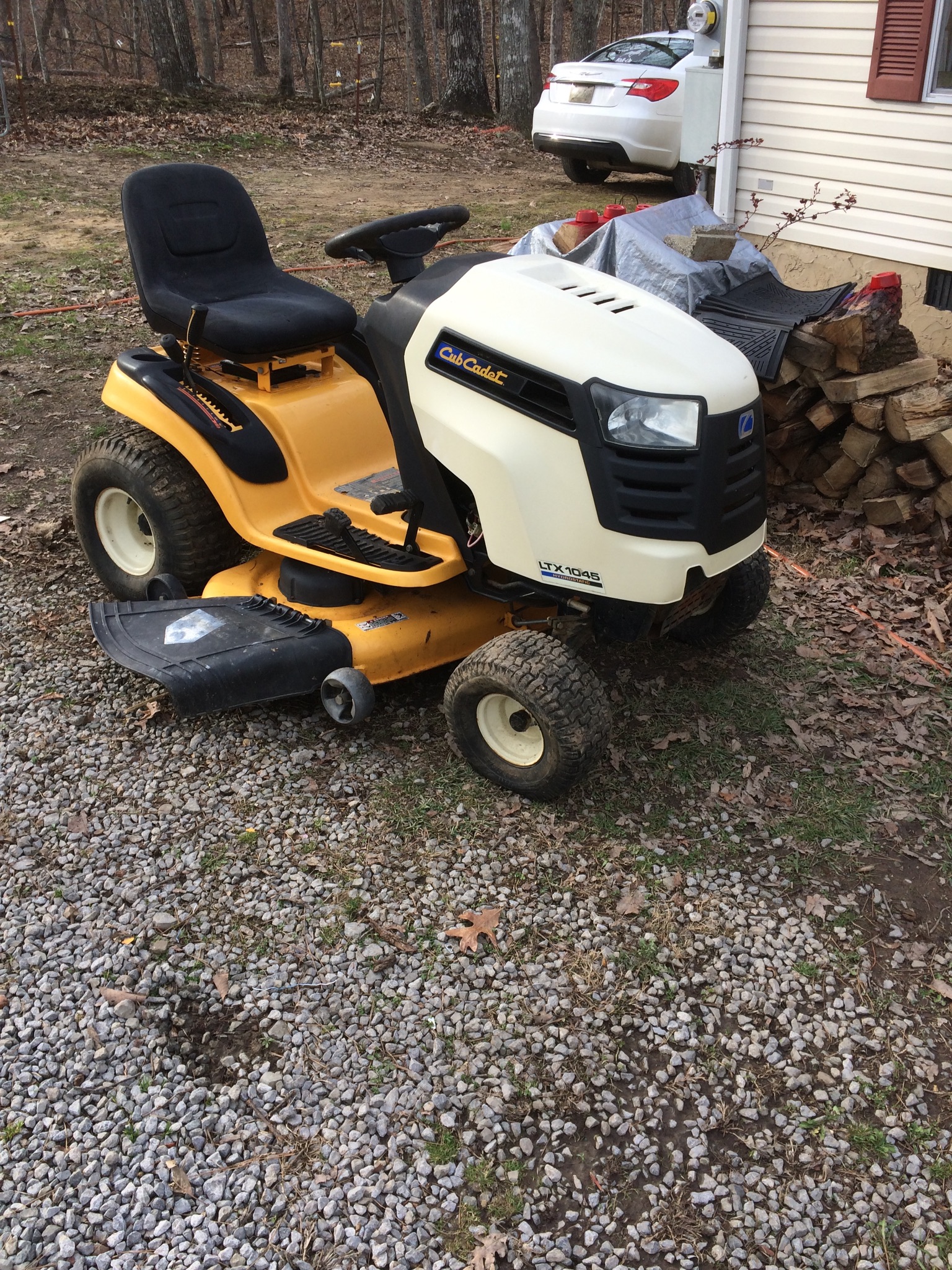

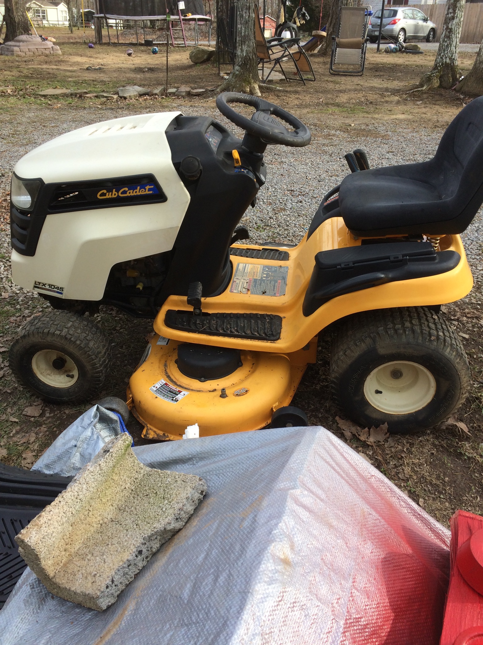

The air filter looked fine just some normal dirt from use. Here is a pic from when I got it to now.IMG_0936.JPGIMG_0949.JPGIMG_0950.JPG
/ Cub cadet wont start #14
If it were mine I'd do a thorough cleaning of all passages, be certain the float will float, replace the needle valve, feel and listen for electric solenoid operation and check the oil level for gasoline contamination.
After I got it running I would put an aluminum heat shield between the carburetor and muffler.
/ Cub cadet wont start #15
Hey guys and thanks for the replies, it's a Kohler courage 20 motor. I took the carb off and it's pretty rough, looks like it was sitting at the bottom of a lake for a while. I'll upload pics of it to show what it looked like before I took it apart, View attachment 499912View attachment 499913View attachment 499914View attachment 499915View attachment 499916View attachment 499917and then some of it after I took it apart.
The carb is repairable, but be aware that white grey powder on the sides of the emulsion tube is aluminum corrosion, and even if you get it all removed, will reappear because of the water, interaction with the air in the carb, and will fall off and reclog the jets in time.
/ Cub cadet wont start #17

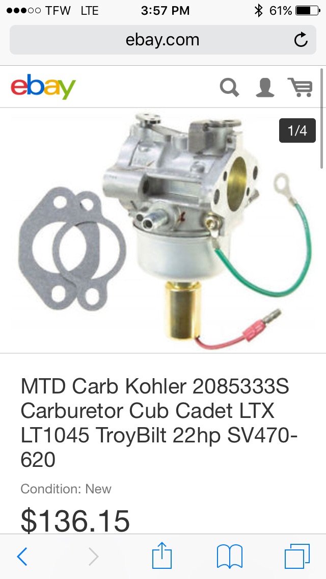

It's rebuildable, but be aware - I've got lots of experience rebuilding small engine carbs of all sorts, including at least 3 or 4 of that or a similar design - they are one of the more tricky and finicky carbs to rebuild well. The main jet often falls out of the internal passage in the plastic "metering plate" between the bowl and the body and gets lost when you jet it out with carb cleaner and compressed air. Does your carb have this plastic plate and is your jet still there? The "serpentine" o-ring for the bowl is VERY easy to get misaligned and kinked. The rebuild kits for those are among the most expensive around. Last time I priced things, they ran about $25-$30. I found a complete (identical) replacement carb for only about $50. Take a close look at the throttle and choke linkages if you go with a replacement to be sure they're the same. The solenoid only needs one "hot" wire and usually just grounds through the housing, but sometimes has the second (ground) wire, so don't be too concerned about 1 or 2 wires.
