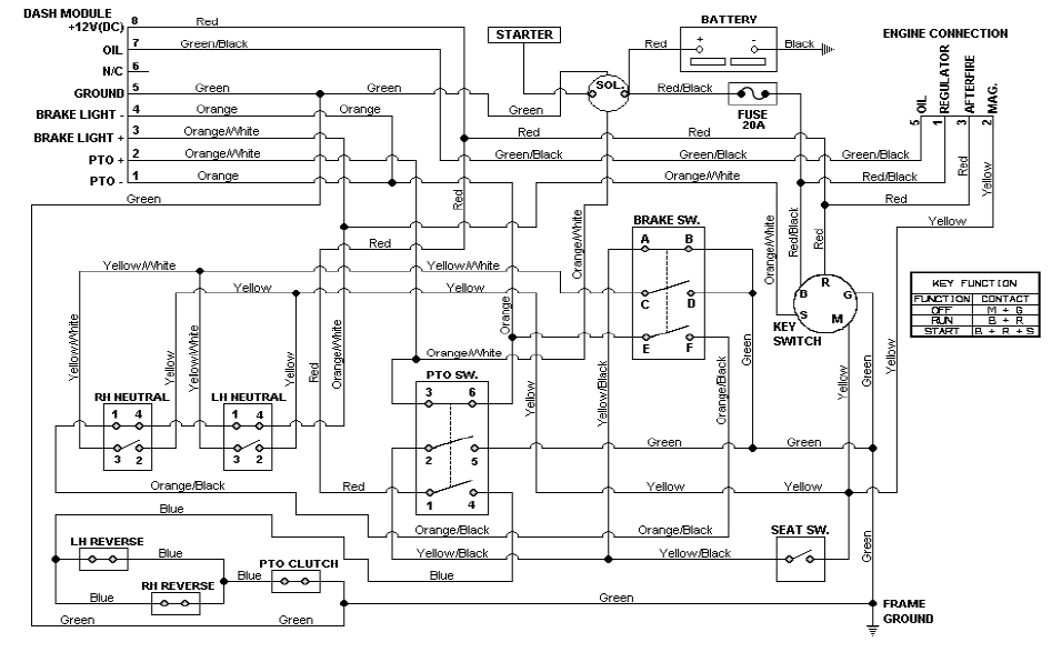

#19
This is the correct wiring diagram for my CC. As you can see on the PTO switch, connections 1 and 4, 4 goes back to the PTO clutch after the two reverse safety switches. Well I have bypassed the safety switches and the connector 4 goes directly to the clutch. Does this mean my PTO clutch is bad? Is there a way to test it?
   / Cub Cadet RZT50 Kawasaki Won't Start #20
the steady current draw on a normal engaged PTO clutch is around 4 amps @ 12vdc. But - if my dim memory is any good - seems I recall some earlier similar discussions where a another culprit was involved.... namely some sort of a shunt circuit to tame the sharp spike of current draw that is typical with initially energized coils such as contained in a typical PTO clutch - very hard on switches.
I don't know whether that "circuit" would be part of your harness or part of the clutch and the schematic you have certainly doesn't speak to it.
Perhaps one of the posters here more experienced in electrical stuff can chime in on this shot in the dark...
