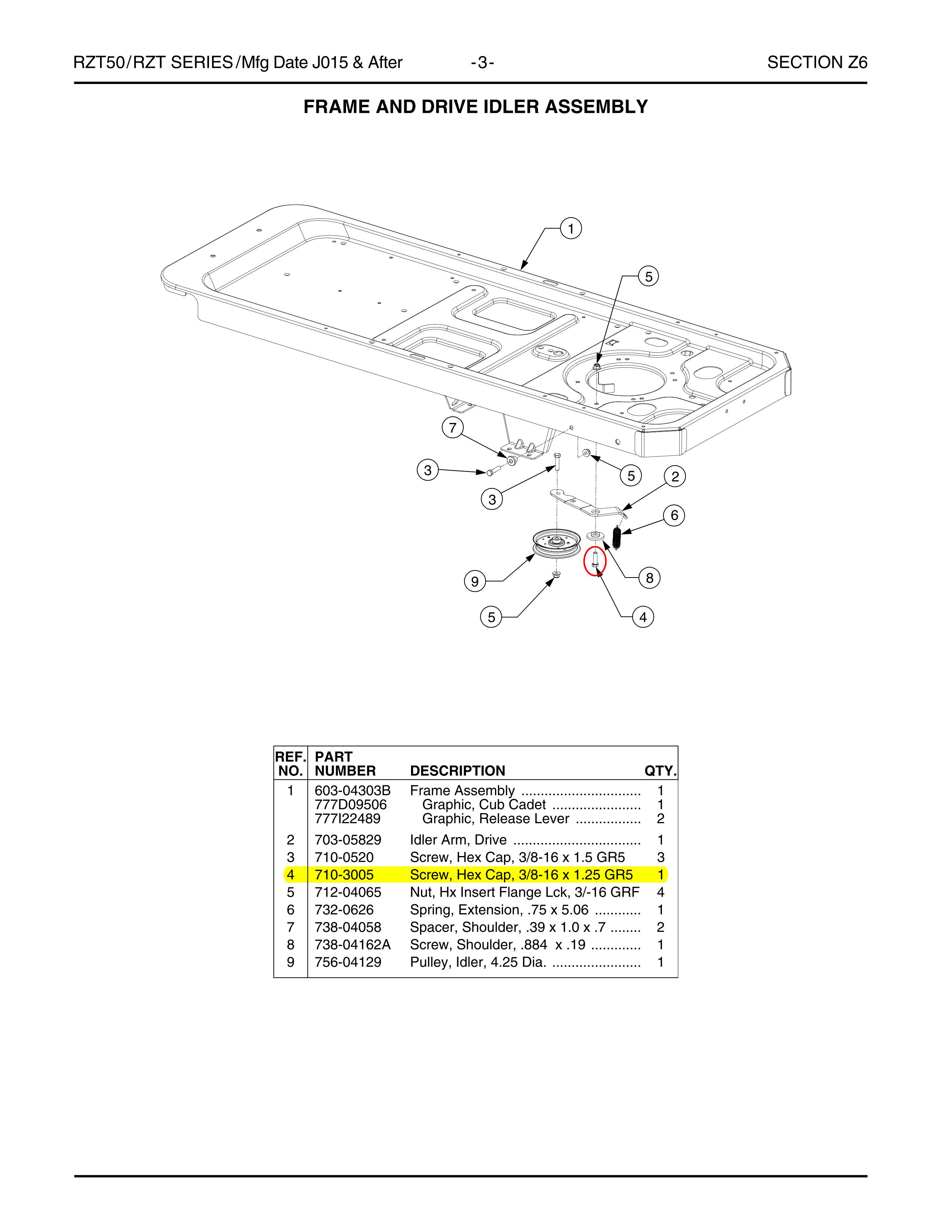

   / Cub cadet RZT 50 hydrostatic transmission #45
The mounting bolt for the idler arm should have a grease fitting in the head to grease where it rotates and it sounds like your arm has seized up on the bolt. I'd take the bolt and the arm off and get it them free'd up because if the bolt runs loose it might fall out.
   / Cub cadet RZT 50 hydrostatic transmission #46
I just checked and my RZT 50 does not have a grease fitting in the idler arm bolt. My bolt does not look like yours at all. Mine does not have the tube-like structure yours appears to have and looks more like a normal bolt. The bolt is threaded into a lock nut on the top of the body and I just barely loosened it. I agree that I need to lubricate it somehow but without a grease fitting it looks like I'm limited to oiling it.
The exploded parts diagram does not indicate a grease fitting (sorry this picture doesn't look as good as it does on my PC for some reason):
   / Cub cadet RZT 50 hydrostatic transmission #47
The picture I posted was from the RZT service manual. I went back and looked at the parts diagrams and it looks like only the early models had the grease fitting.
