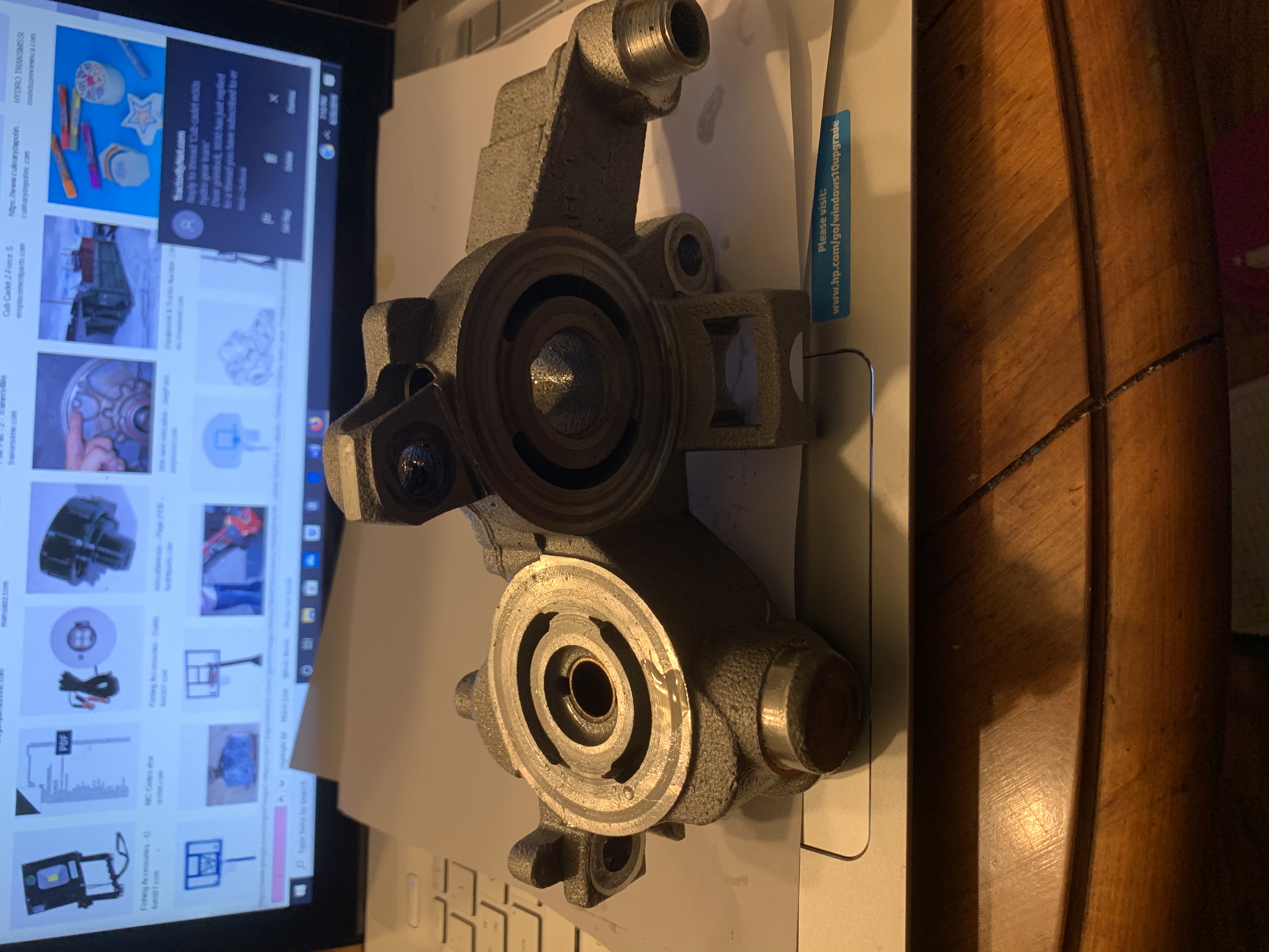

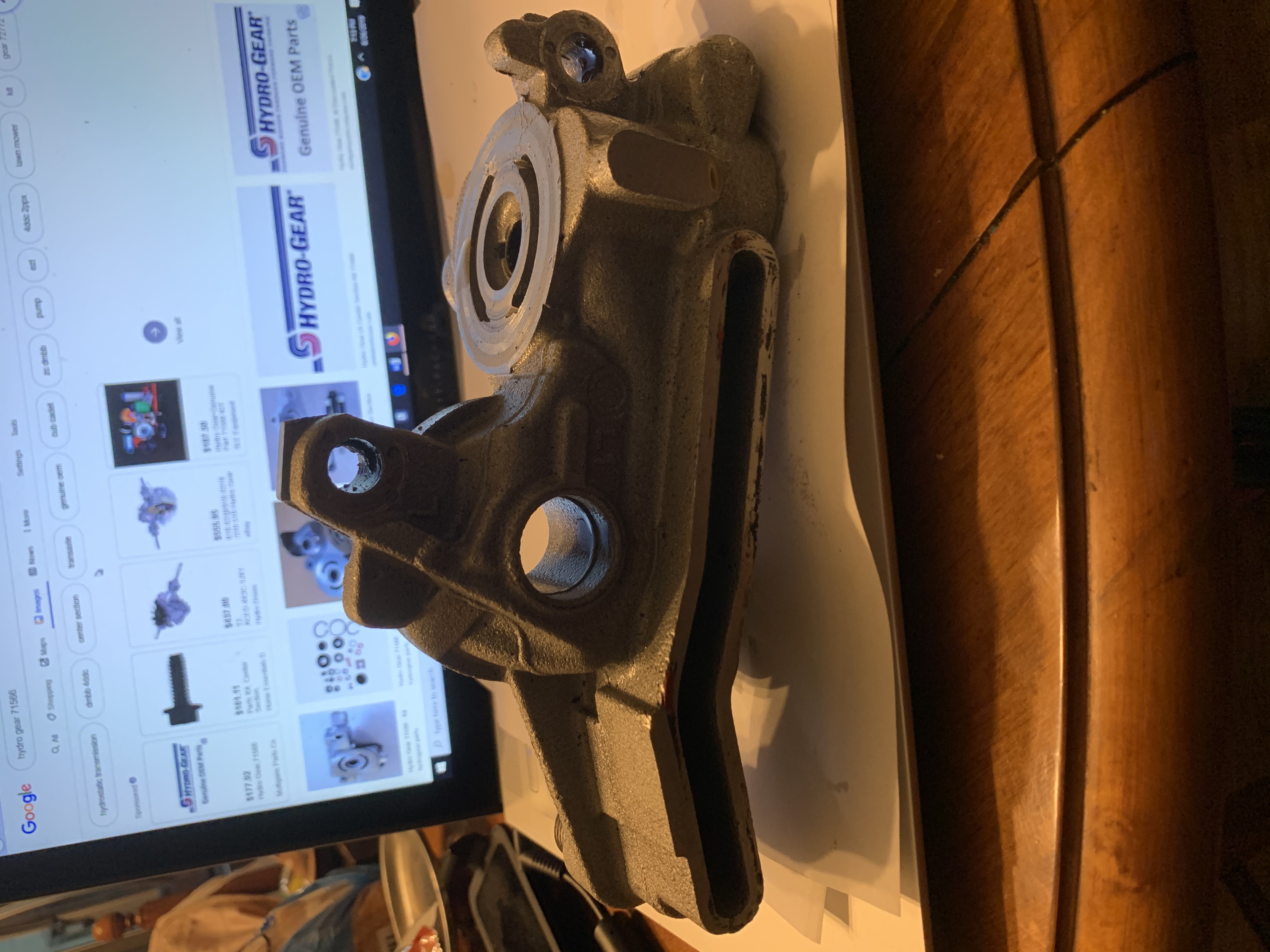

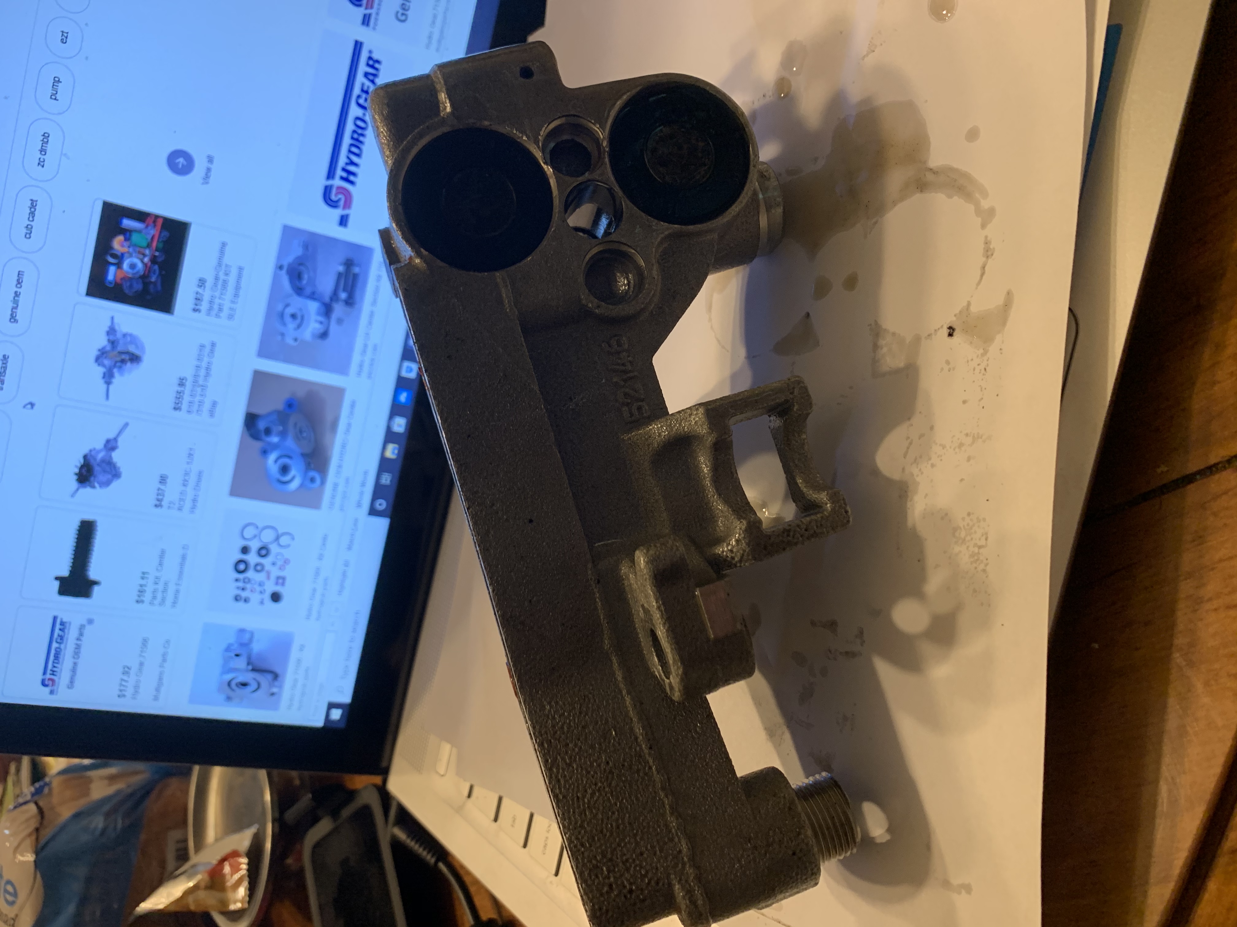

I bought it from a dealer that used it to mow their business lawn . I paid $800 5 years ago. It’s in great condition , engine doesn’t leak or burn oil . I think it’s worth trying to save . Here’s some pics of what was in my unit .

Looking at the center section I am surprised that the pump and motor are not both trashed with fingernail catching grooving.

The pump and motor are trashed too . Not as bad as the center section but they have slight grooves . I can find those parts , just can’t find the center section.
