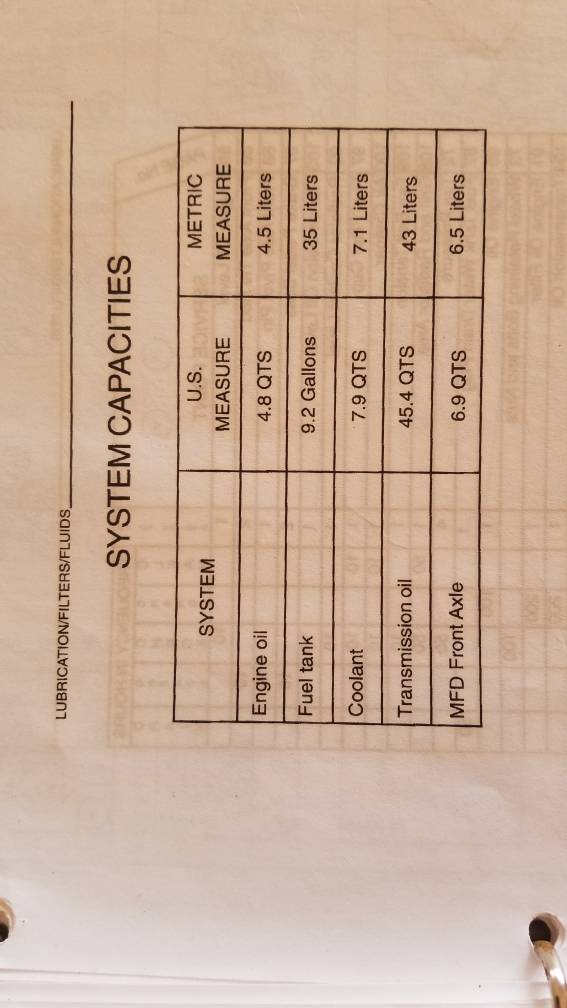

I just purcjased a 7360 and need to fix a few hydro leaks. I am not sure what fluid is the best choice. As I fix leaks and new ones appear, I will be going through a bunch of fluid. Not sure if capacity yet or how to check level.
   / Cub Cadet Hydrostatic Oil #105
Not sure of capacity yet or how to check level.
45 quarts, about 11 gallons.
