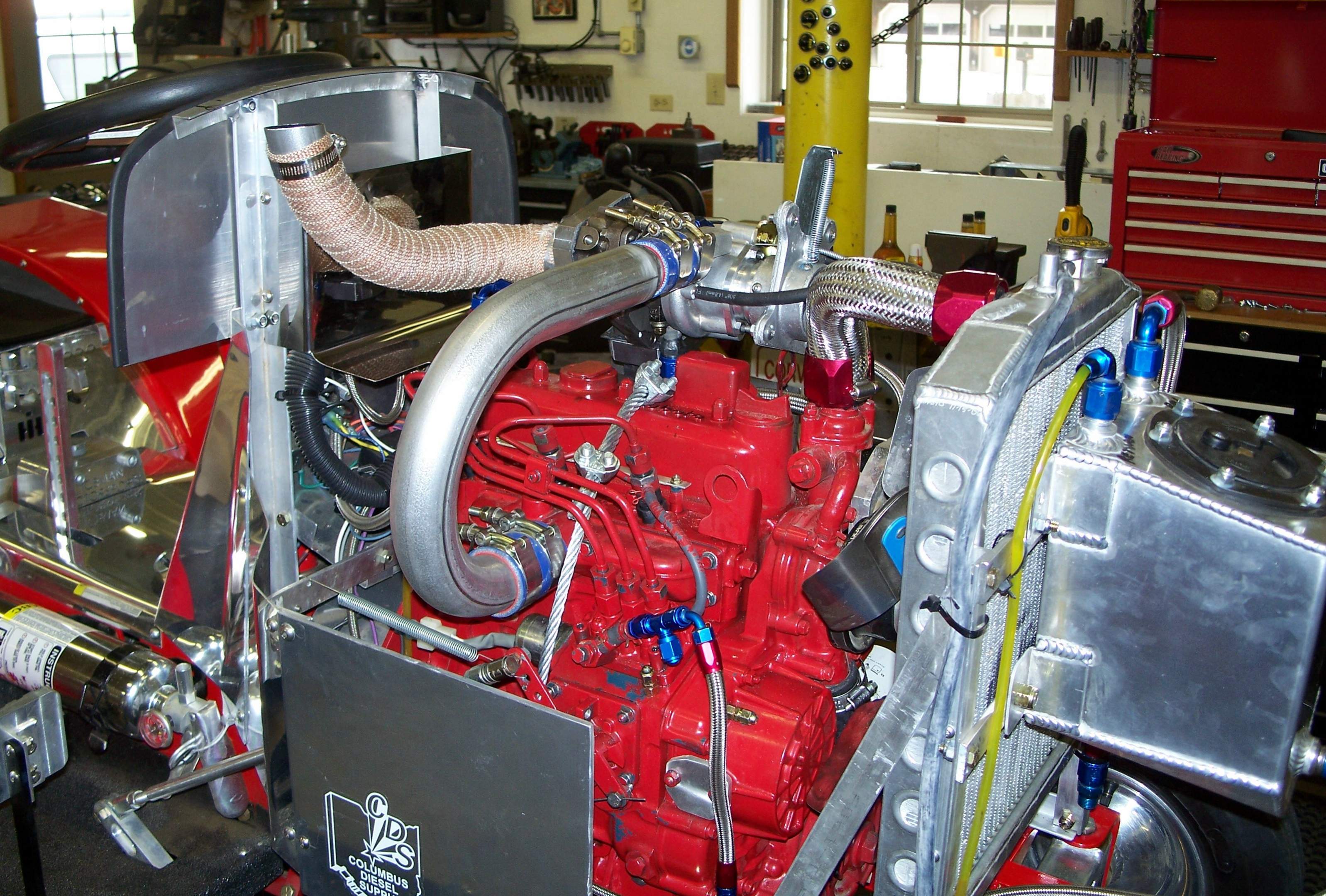

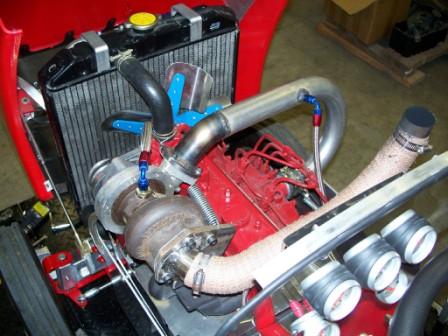

Here is a D1105 in a 582/782 frame
   / cub cadet diesel puller #9
and NONE of it will fit under the 782 stock sheetmetal, and the 124 is a good 6" narrower!
