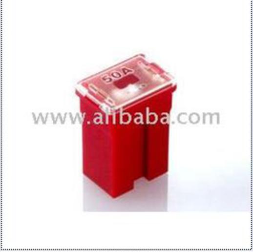

Need more information! Does the engine turn over with the starter but not catch and run, or not even turn over? Does it click from anywhere when you turn the key?
If just a click, or not even that, there's usually a host of safety switches whose specific intent is to prevent it from starting until all "safety conditions" are met; in neutral? clutch depressed? operator in the seat? PTO not engaged?
Then Cub usually puts a large plug-in type fuse in the wiring down near the starter that can be the problem. It should look something like the attached.
Of course, check all the "regular" fuses too. I never trust just looking at them. Use a cheap ohmmeter. Harbor Freight usually has a coupon for a free one.
Good luck!
