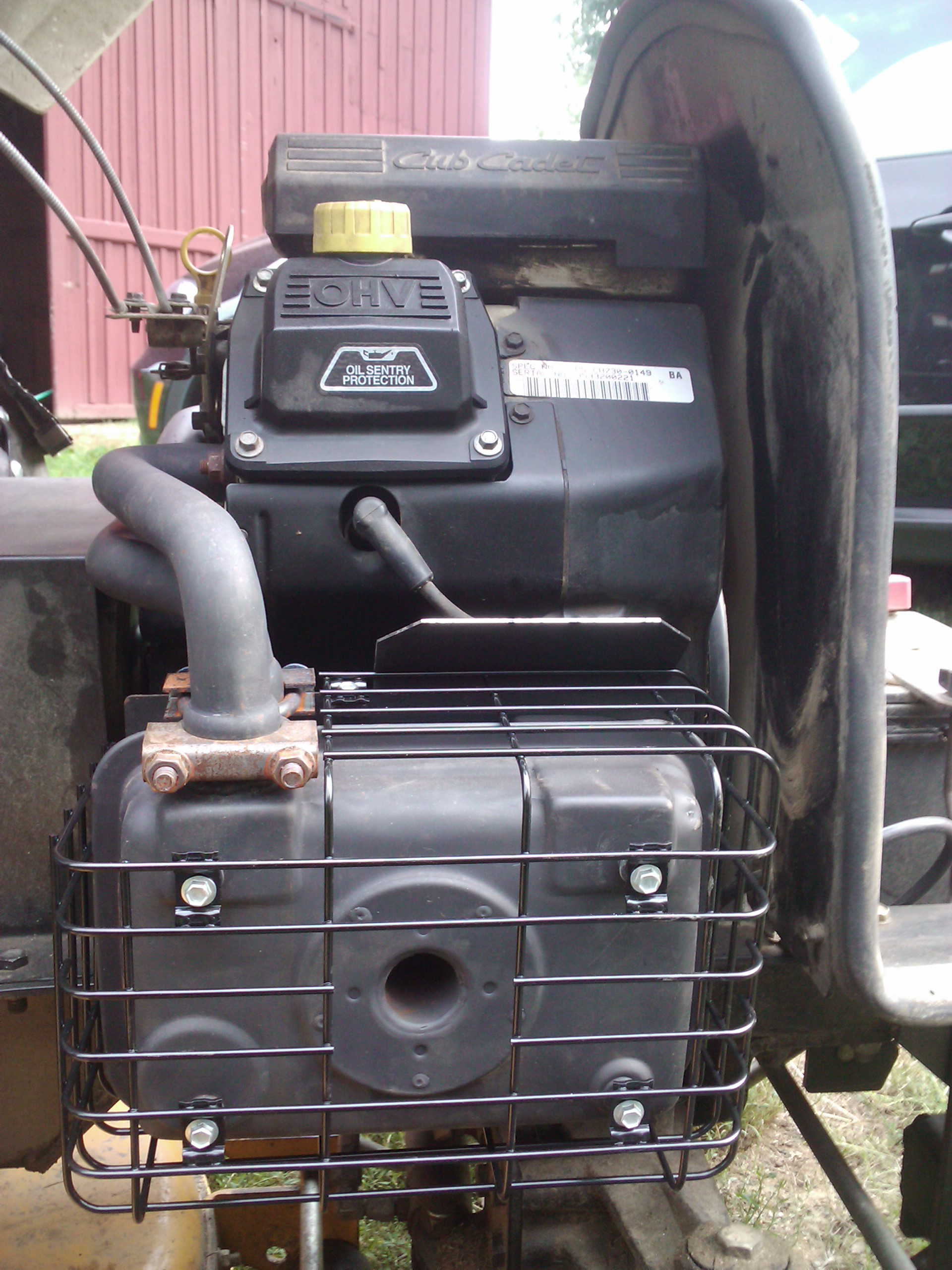

#13
Over the weekend I ripped out the factory muffler/headers/heatshield and replaced it with Kohler kit #2478620-S which consists of 2 header pipes and a side-mounted muffler that goes next to the oil filter. It's not a 100% direct fit because the mounting holes in the engine base for the muffler bracket are obscured by the tractor's frame, but I think even without that it should stay on there. I haven't tested it fully yet because I'm waiting for a cage for the muffler to keep it from coming in contact with the hood. I might end up just cutting off a small part of the hood overhang that touches the muffler, if the cage doesn't do the trick.
By the way, I started the tractor up with just the 2 header pipes and no muffler and it was loud. At idle it wasn't too bad but at full throttle the noise level was just unbearable.

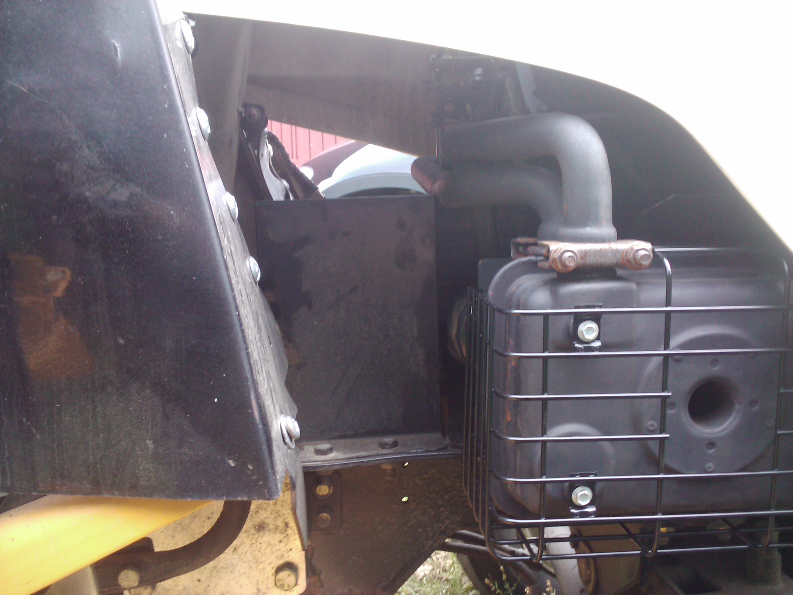

Here are some pics:

   / Cub Cadet 5252 power steering problem only when hot #18
Looks like a good solution but my loader's hydraulic hoses are on the right side. They do sell a left side kit but I think a better solution would be to get the headers that go into one pipe and put a much less expensive muffler on it. $100+ mufflers for these tractors is ridiculous.

#19
Changing the engine oil filter should be no problem because the kit came with a low-profile filter (same as the one already on the tractor btw). This particular muffler was about $200 but to me it was worth it because the tractor runs much cooler now and also there seems to be less heat and noise in the cab. I also removed the big metal shield around the flywheel for extra airflow.
I just ran a PTO broadcast spreader for an hour and no steering issues at all. I'm sure partly because it's in the 50's today. A couple of weeks ago when it was still around 80 degrees out and I was doing some mowing, the steering did get a little weird after a while but it wasn't as bad as before. I definitely see a correlation between the steering issues and heat accumulating in the dash area. I noticed that when the steering is acting up and I shut it down and take the key out of the ignition, the key itself is quite hot. Maybe I'll try putting some heat resistant insulation in front of the dash or something...
