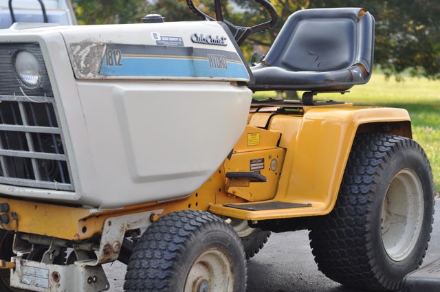

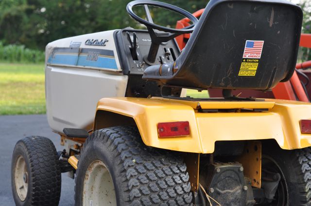

Wow looks like new Carl . I need to get a few more rattle cans , but here is today's progress

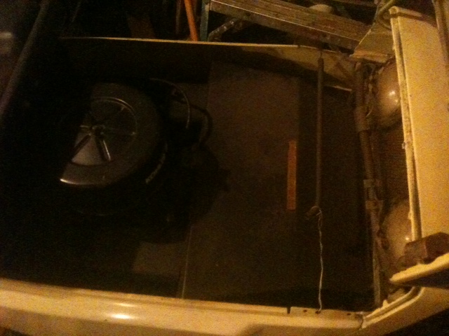

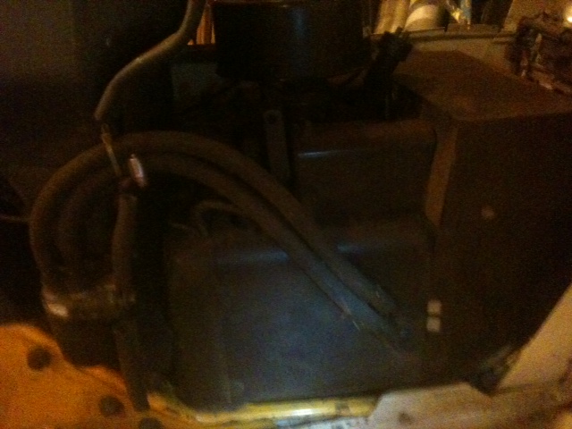

By the way Carl when you get a chance could you take a photo of the engine with the hood up . I have an engine shroud I can't find a place for I believe it goes up front . Also would like to see how the side panels attach by the headlights I have them bolted by the steering wheel but only wired by the headlights .
thanks
   / Cub Cadet 1812 #13
Lookin Good Tooth, nice progress,
Here are two shots taken tonight of the right side engine cowling (under the white side panels) then the other one is the top of the engine and shrouding.
I didnt have the best light but I think you get the idea. Essentially the engine is surrounded by cooling shrouding including the exhaust / muffler which pushes all the air from the rear fan to the front of the unit. This is INSIDE the white side panels which are more for show.
Black metal shrouds are on both sides L&R - shrouding is attached by 3/8" head auto type fasteners thru clips on the shroud - these are a PIA to R&R.
On the top side to hold the front of the white panels in place is a spring (mine broke so i added a wire to one end) and it connects to the top holes on the white side panels.
Hope this helps.
Carl

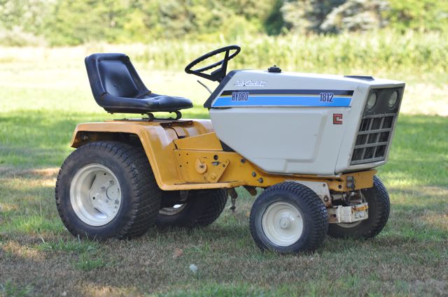

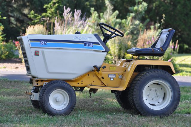

Stopped at the Case dealer yesterday picked up up 2 gallons of Hy-tran and a hydro filter , made a huge difference with the sound of the tranny and the way the hydraulics sound . Cut the old filter apart it was black and had a coating of slime .
Bought some new decals and a few more rattle cans . Thanks for the help .
