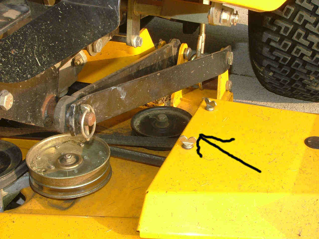

Hey Bill,
I'll attach a picture, we may be talking about the same pulley?
Curt

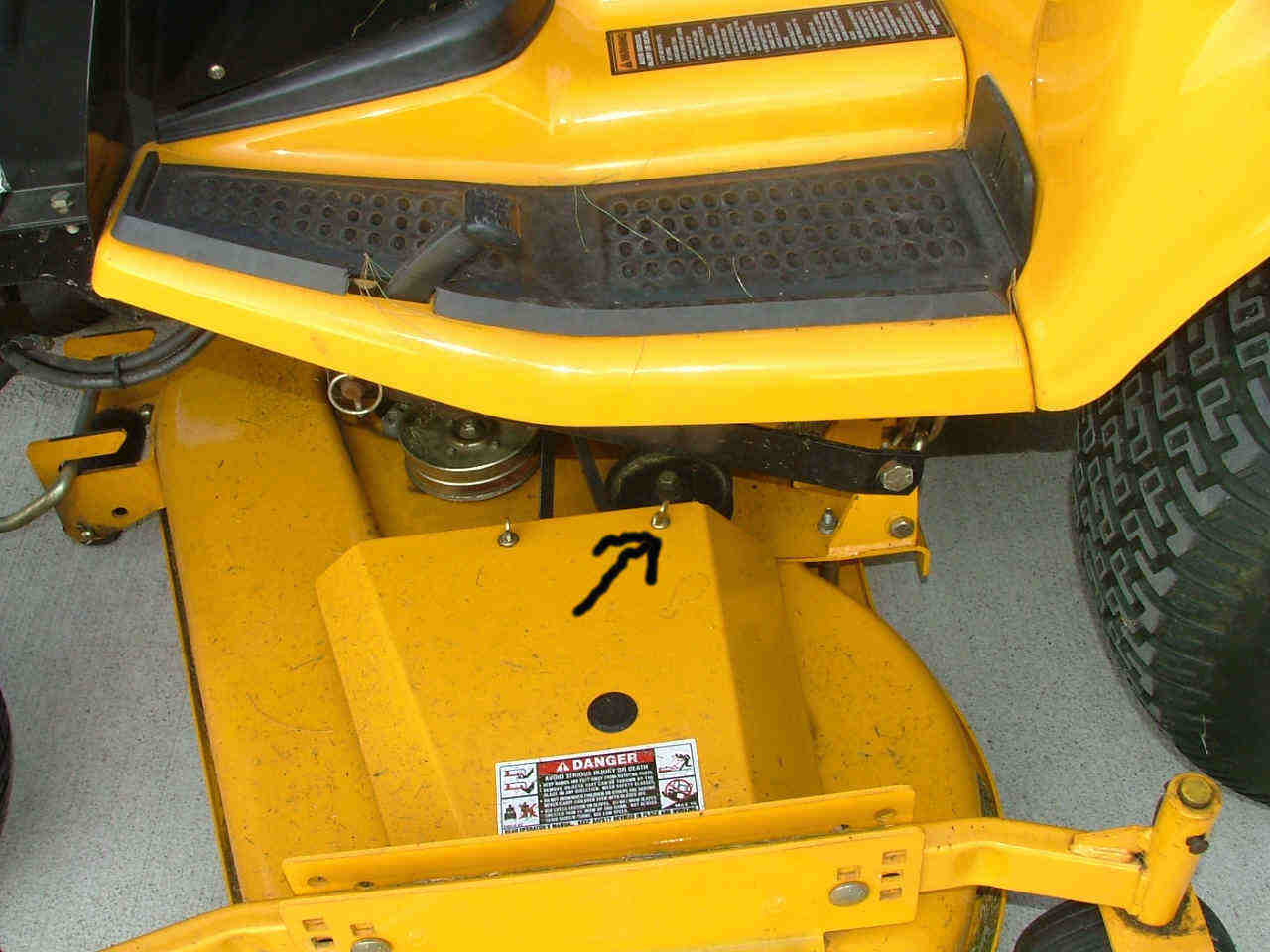

Hey Bill,
Another view.
Curt

Ohioguy, I don't have that pulley on my deck. It looks like its just an idler pulley, no spring tensioner? How does it adjust?
   / Cub 5000 MMM eating belts #24
Bill,
It's fixed, no adjustment. The reason I wondered about its' purpose was with the deck engaged it barely turns, if at all. I'm sure that because it's just intended to limit travel. I'll get the part # from the manual if it's listed, although it may be a warranty repair/upgrade for you?

   / Cub 5000 MMM eating belts #25
I went out and fired up the tractor, it does turn, I just assumed it didn't because it doesn't lok like there is enough contact to spin it.
Neither of my manuals show that pulley? Maybe the dealer added it? Nah, that would be way to proactive for them.
I'm curious now /forums/images/graemlins/cool.gif
Curt
   / Cub 5000 MMM eating belts #26
I emailed Cub Cadet's tech support and included the picture of the pulley. I asked why it wasn't in the manual or present on a friends deck who was having belt problems.
This was the reply;
Thank you for contacting Cub Cadet.
The pulley you have pictured seems to be a standard drive pulley, that should be on the tractor. You might have your friend speak with their dealer if this pulley is not present.
Thank you as well for choosing Cub Cadet!
I have no idea! I asked more questions.....
Curt

The manuals are probably the original manuals and don't show the addition of the new pulley but there is a part number for it. Mine should be here tomorrow and I will post a picture and part #. I really question whether that pulley in itself will solve the problem but we will see.
   / Cub 5000 MMM eating belts #28
That is one of the pulleys that we usually add onto the deck to stop the belt from falling off. As far as the previous posts about aftermarket belts, I would recommend the original belt. I recommend this because most complanies when they make belts for their machines, they make sure the belts have the same angle V groove in them as the pulleys that they use on their equipment. Most aftermarket belts don't have the same V style groove as the original belt, therefor they heat up much quicker and eventually break much quicker. The companies aren't stupid, they all make their equipment and parts so you almost have to buy original parts to make things work properly.
