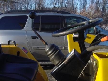

I have the 417 loader on a 7265. I took a couple of pictures hopefully it helps. This one is of the diagram at the base of the joystick. Notice if you push up past the detent it is the float position.

For some reason it is not taking the attachment. It is only 79 KB. Lets try the second one. This one shows the joystick in the normal position. The next one will show it up past the detent in the float position.

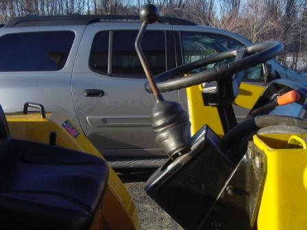

Here is the second picture at same angle as first. It shows the joystick past the detent in the float position.

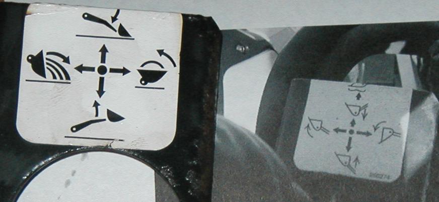

Lets try the diagram attachment one more time. I also looked for the float lockout and could not find anything. It has always worked by just pushing it past the detent.

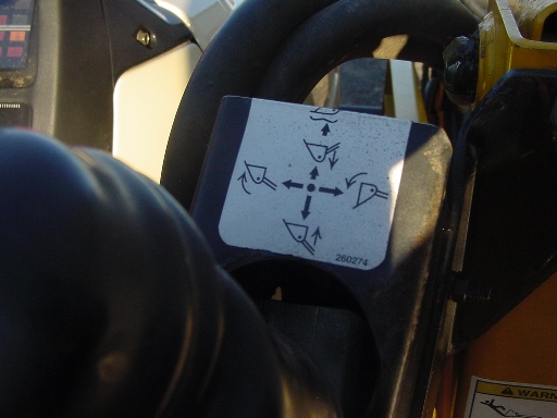

I also had a problem where the bucket curled the opposite direction from what the diagram on the loader said it should. I tried reversing the hoses to curl cylinders and was amazed to find it didn't work. I could curl down real well but couldn't curl up at all. Putting it back it seems to work normally. Maybe the valve has some kind of compensation for the difference in plunger area due to the rod on one side?
I am wondering if my diagram is just wrong as it shows reversed bucket curl compared with the photo posted earlier on this thread. My diagram also doesn't show a float position even though I do have the end cap with the detents for float.
