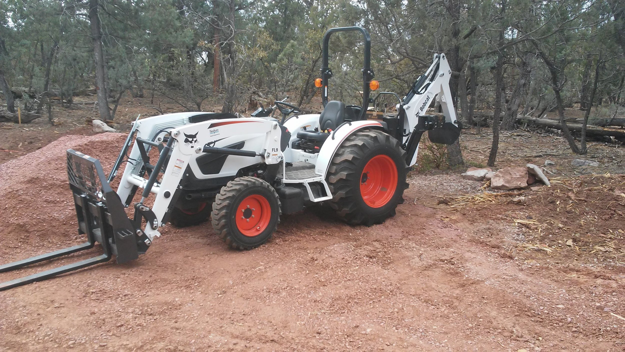

There don't seem to be many 4xxx series threads out here, and I had so many questions prior to the purchase that I could not really find answers for (and new ones now that I have one) I thought I should start a Q&A thread.
I recently purchased my first tractor - a 2020 CT4058, with a BH-86 backhoe, Bobcat 72" box blade, and Bradco 48" heavy duty pallet forks. I have a 2nd rear remote kit and a factory 3rd function kit (have not actually installed either of those yet, but it looks fun.)
I am not a professional, trained, or highly experienced operator, but all together I have several hundred hours on backhoes (35-95 HP) and 3-5 ton mini excavators, so I can at least compare the Bobcat to those.
So far I have about 20 hours on the tractor, about half and half between the backhoe (pretty strong for a compact tractor backhoe) and box blade, so I don't have any reviews from a reliability standpoint yet (except that you must, MUST, go over all the bolts and nuts periodically and make sure they are tight, especially on the front loader, and anything else the dealer attached.)
I have spent a ton of time online doing as much research as I could about the 4xxx series, (and the corresponding Kioti DK/NX models), and learned a lot, but many questions were only answered after I could put my hands and eyes on the tractor.
-Shawn

Nice looking tractor. I have a 2012 ct225. It’s an awesome little tractor. However I always considered sizing up to the 4/5 series. Just recently had a guy locally put up a kioti dk 45. For sale same year with similar hours.
I think he would do a fair trade with me if I chose to. But I can’t seem to bring myself to let go of my 225.

Are you happy with the size you chose for the tasks that you have?
   / CT4xxx HST Series Q & A
So far it's pretty awesome. There are, of course, things I can't lift, and holes too big to dig effectively with the backhoe (like my house foundation) which is when I rent the bigger equipment (New Holland B95B is a beast!). I loaded some huge stumps today... like 20" ponderosa and juniper, and had no trouble lifting them to full height and dropping into a dump trailer. The box blade is unstoppable, and I added a hydraulic top-link yesterday, which makes the blade 10x more useful, especially while I am raising my 400 foot driveway about a foot with fill from the foundation dig. Last week I used the backhoe to dig out a couple of (estimated) 2-3 ton boulders (had to roll them aside, since the loader can't even dream of lifting them.) I am actually pretty impressed with the BH86 backhoe power. It doesn't have the reach of a mini-ex, but it is no toy either. Yesterday I unloaded a full 100 gallon diesel transfer tank with the forks, and the loader didn't even break a sweat.
