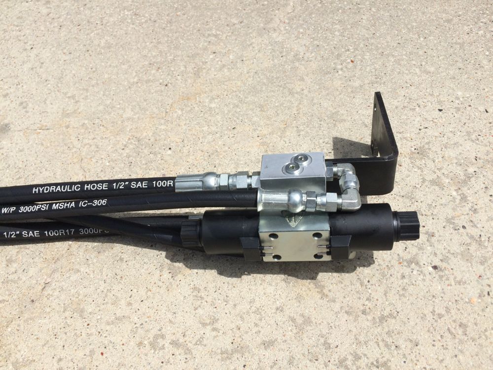

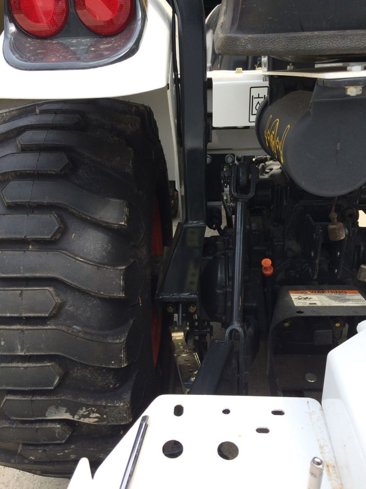

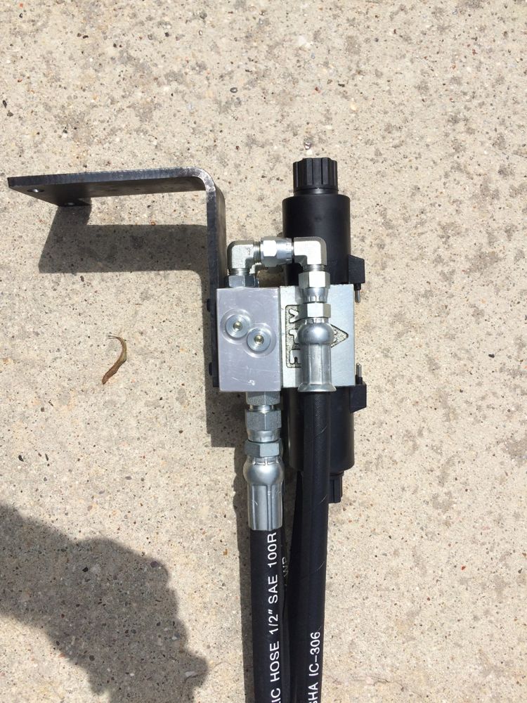

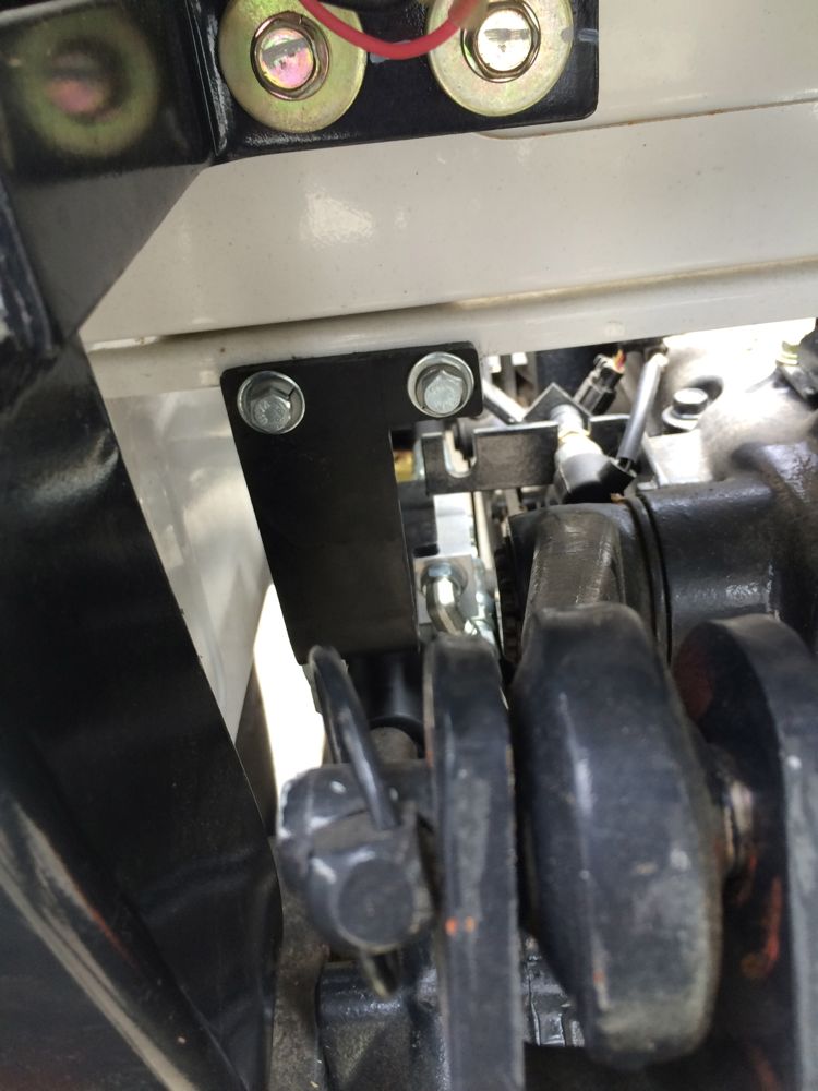

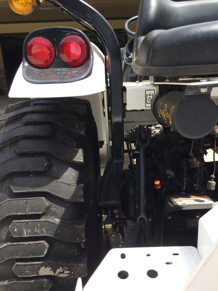

* The 3rd Function kit is supposed to be tractor specific (as are the summary instructions). Installation space in general was tight - very very tight. The kit has a nice valve mount that attaches to the left rear of the tractor. So basically, you route from PB on the loader valve (which is underneath my right foot floorboard area) to the left rear of the tractor, then route back up to the loader valve area for your hose disconnects. Then another set of hoses route from this disconnect area along your loader frame to ultimately connect to your implement. No surprises there and this set up allows for you to remove the loader along with the hoses in an orderly fashion. The ag connectors leak like a sieve. Continuous drips and trickles. In two days of grapple/tree work at my home, I probably lost 1/2 gallon or more. I have spots all over the driveway, drips all over a trailer (tree guy's trailer), and all over the tractor. I am a bit frustrated with how bad the leaks are at the connectors. I know, I know - ag connectors leak some. But my loader and rear remote connectors don't leak?r at least non-detectible leaks. I may just order and buy new hoses. Visually, I can see fluid coming out all day long.
The grapple itself has been great.
Various pics below for your pleasure.
_________________________________________
3rd-function valve and WRL mounting plate:
Mounting bracket location on tractor:

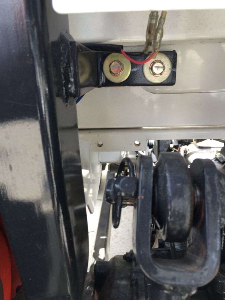

Valve mounted on tractor:

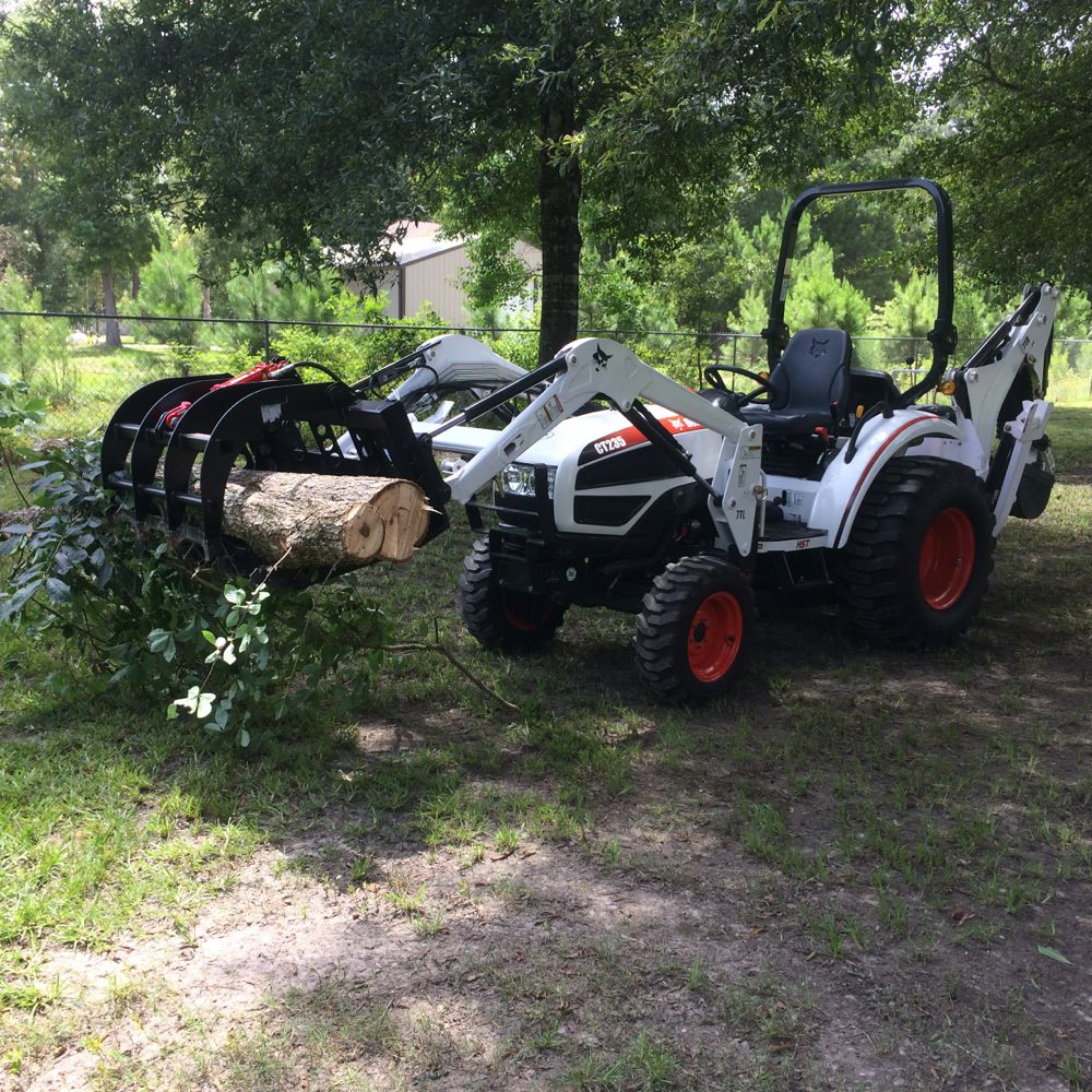

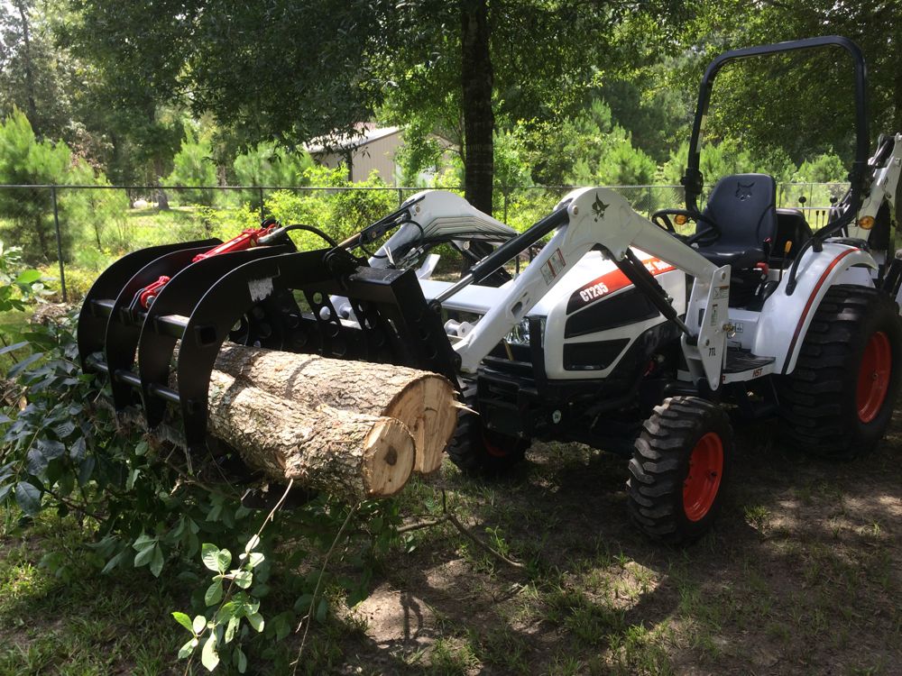

First test grapple loads:

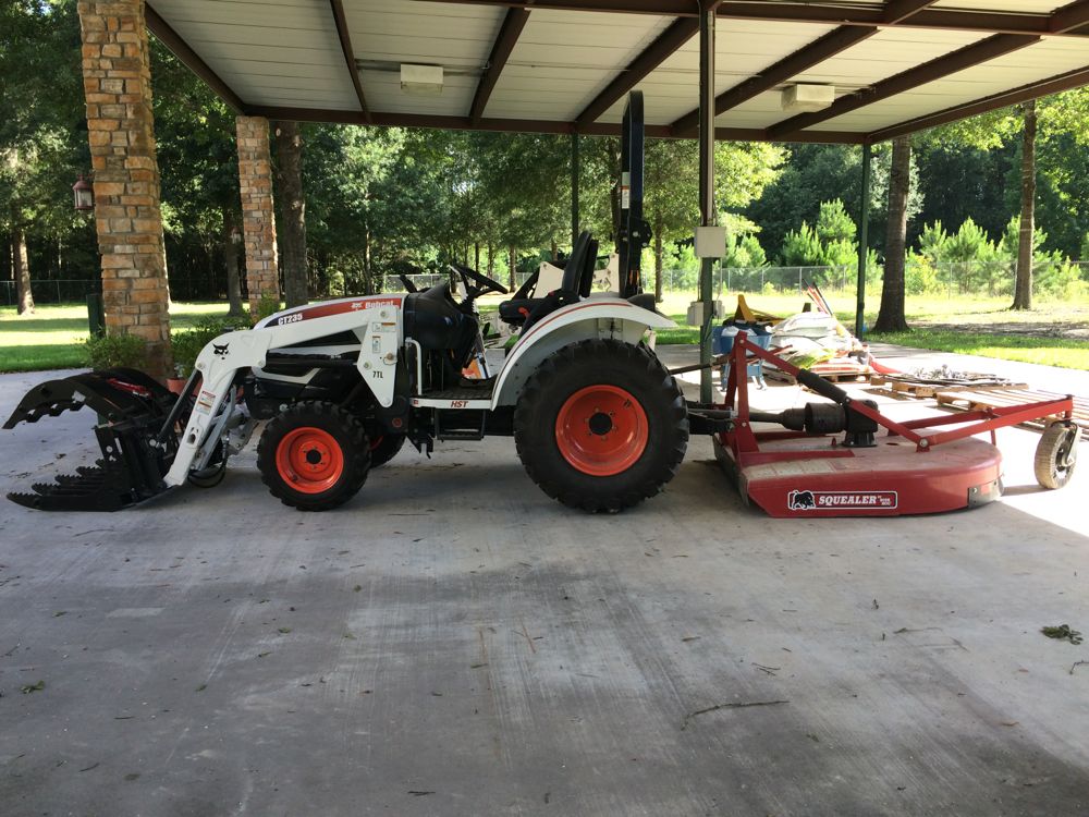

Couple random pics:
