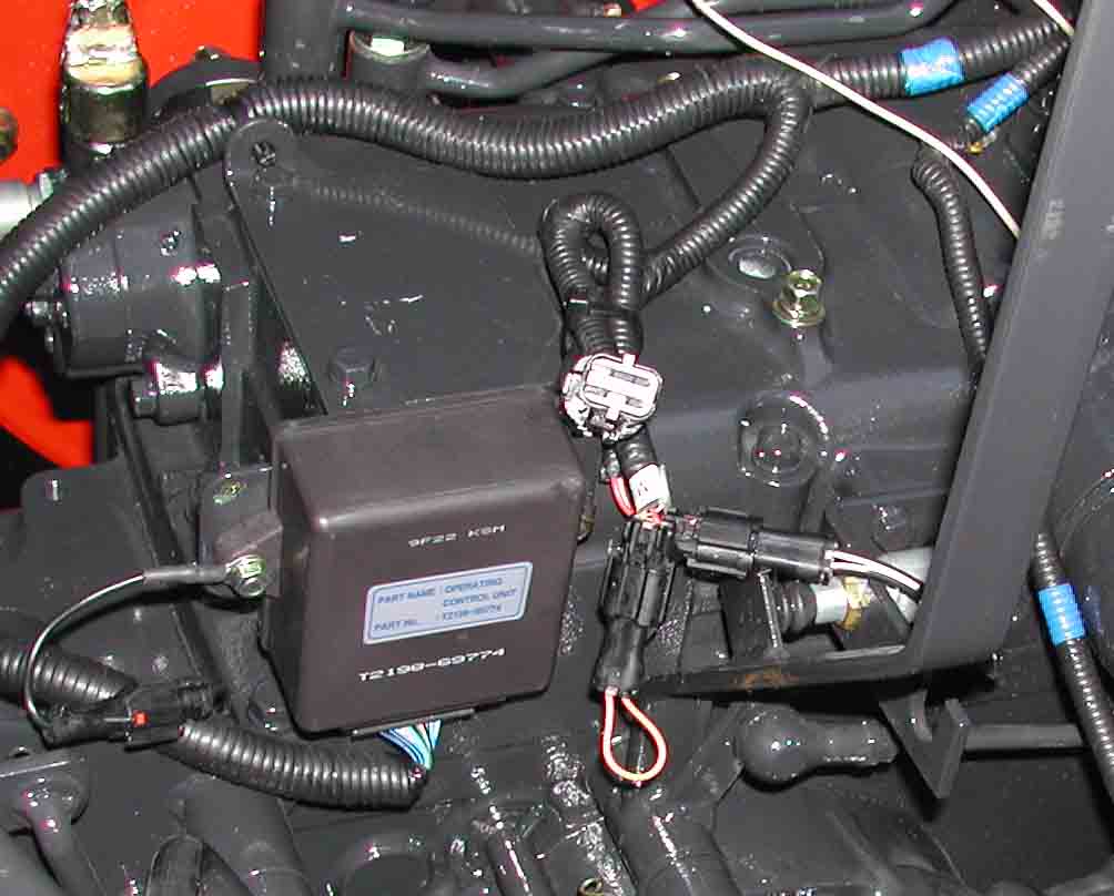

Well, electrical is the area with the most differences between the CT230 and the CK30 (both aka
the DaeDong M27). Not only did Bobcat use the standard Bobcat start switch (with no weather cover),
they also have a much more extensive interlock system.
The photo is of the interlock logic module from my 2010 CT230. The CT has so many switches, they
can be quite troublesome. I even had to disable the parking brake switch right away, as the engine
would die whenever I tried to disengage it. My 2005 CK30 only had the foot clutch switch.
I highly suggest you get the wiring diagram for starters (in the service manual). Bobcat improved many
areas of the the manual, BTW.
