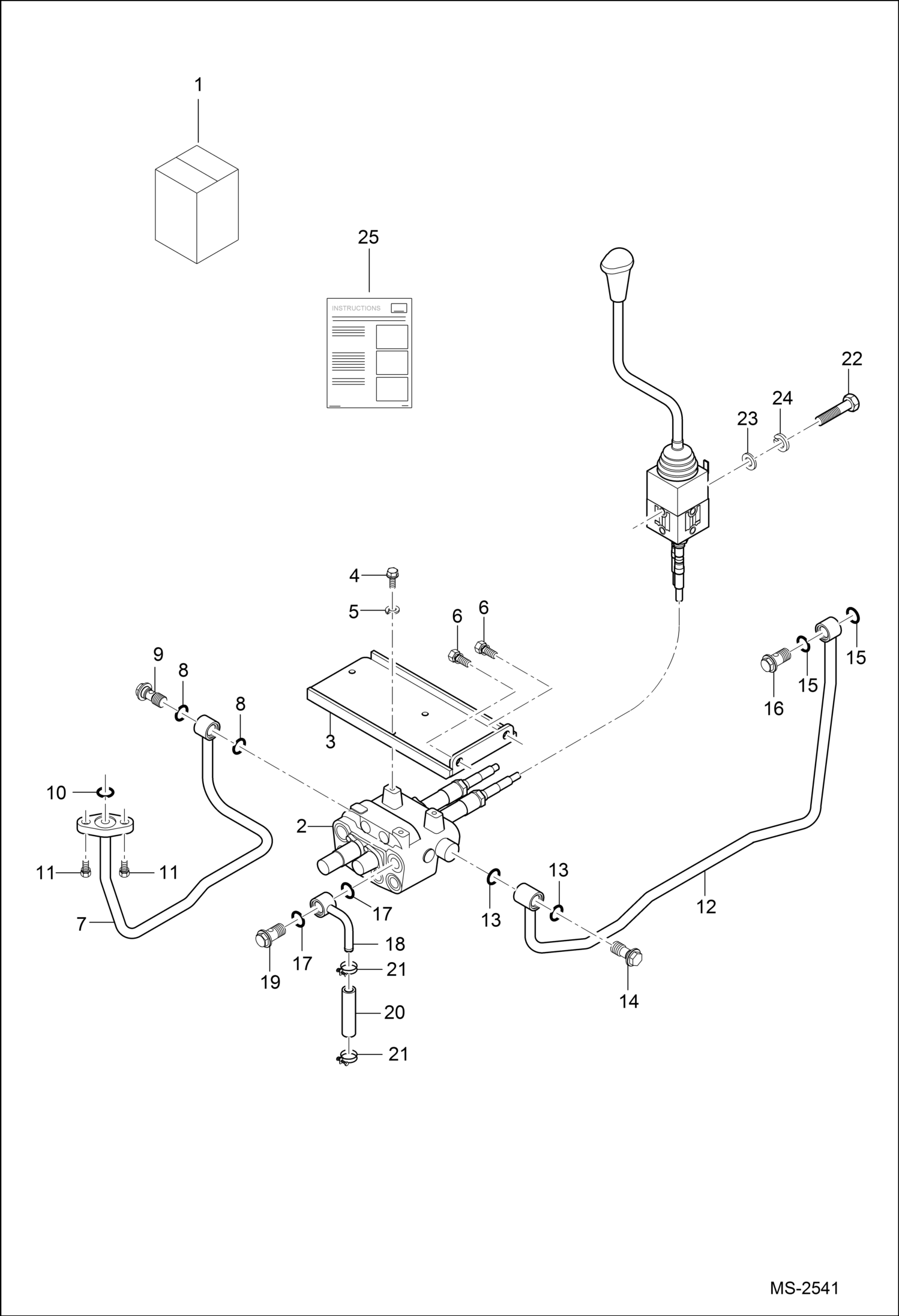

Hi guys, been clearing timber. Log broke the housing that is mounted on the manifold.
Can you help me find part to order?
Thanks very much!
I've wired it closed, to get loader to drop.

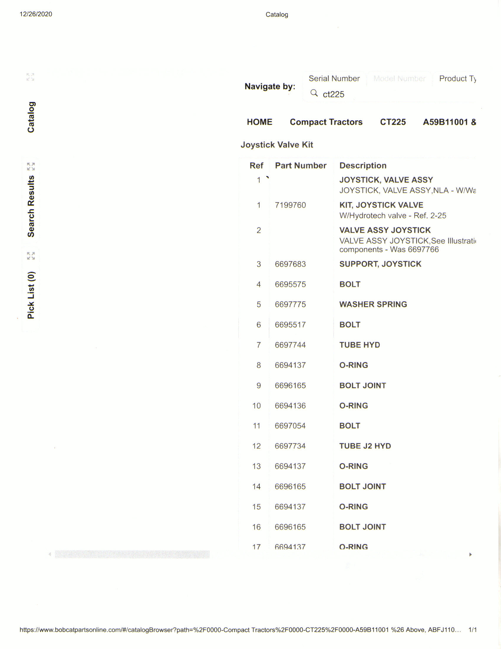

Not sure just what your wanting to order. Here is a part drawing and some part numbers. Not smart enough to copy the whole page. You can go to "Bobcatpartsonline" and search by CT225 and then look for Joystick valve kit.

/ CT225 Up/Down loader lever broke #3
6696835
KIT, ADAPTER I think its this part you want..........Screenshot_2020-12-26 Catalog.png

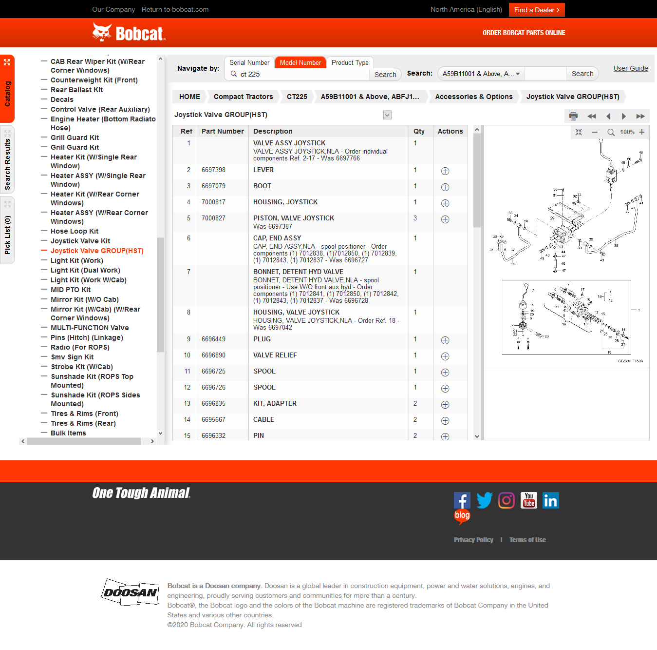

Here it is with the STAR marked on it.
Broke off at the base.
I wrapped baling wire to hold it.
I can't tell in the schematics the PART #.
Thanks for ur help!
In this pic the 2 cables feed up to the joystick.

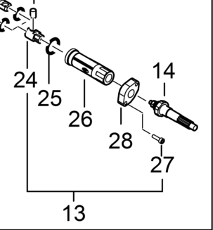

/ CT225 Up/Down loader lever broke #5
The part number I posted is the kit for that sleeve with the the extra hardware.....
/ CT225 Up/Down loader lever broke #6
bobcat.PNG This is the part #13
/ CT225 Up/Down loader lever broke #8
I guess you could call a dealer and order it over the phone to make sure its the right part...
