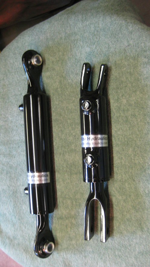

Can anyone tell me what length stroke or what the min/max length I should be using for this tractor? I'm trying to order the parts ahead of my tractor arriving and I'm just not sure how much adjustment is in the stock top link.
/ CT2040 Hydraulic top link #2
Typically I provide a cat 1 unit with a 2" dia cylinder with a 1 1/4" dia rod having an 18"-25" working length.
Find something close to that and you should be fine.
