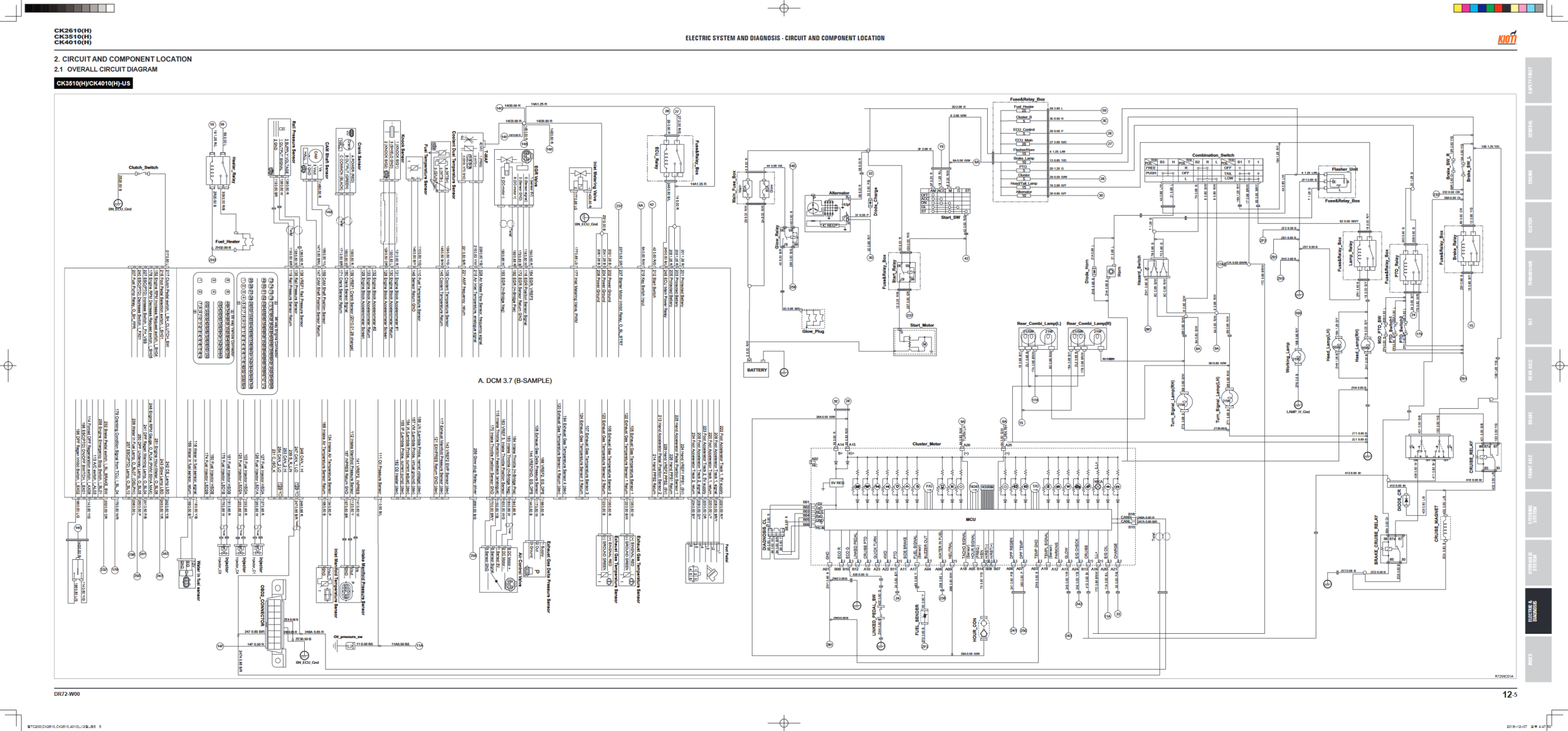

I'm pretty sure it's one of the 50 safety switches.
I can start the tractor by jumping the starter to the solenoid, but for whatever reason I can no longer start it with the ignition switch.
Tested the ignition, and it's good. Seat switch is likely good since it doesn't shut off while I'm using it. PTO switch is good AT the switch. Can't remember if I checked the clutch switch.
I need to get a service manual to trace the wiring, unless any of you have a pdf of it or the kioti 2610?
Anyone else experience this issue? I'm still under warranty for a few months but but I'm in the middle of tractor season and I don't want them to have it for 3 months.
Thing only has 67 hours on it.

Quick things to check are the Bosch Relays on the firewall (forget which ones which) and the ignition switch. Also look under the dash for any loose wire/connections, and fuse panel.
I think the CT2025 is the same as a CK2610, no? If so, DM your email..
/ Ct2025H Won't start with key. #3
See if this works..

I'll have to pull that picture up on the computer when I get home but it looks like it might help!

Well, when I blow it up on the computer I can make out some of it, but a lot of the writing gets pretty blurry, but its better than nothing! I'll see what I can trace down with this for now until I get to spots I cant read.

I sent you a link, did you not get it (check your spam)? Page 639 I believe.

Ok.. check DM, see if that worked.
