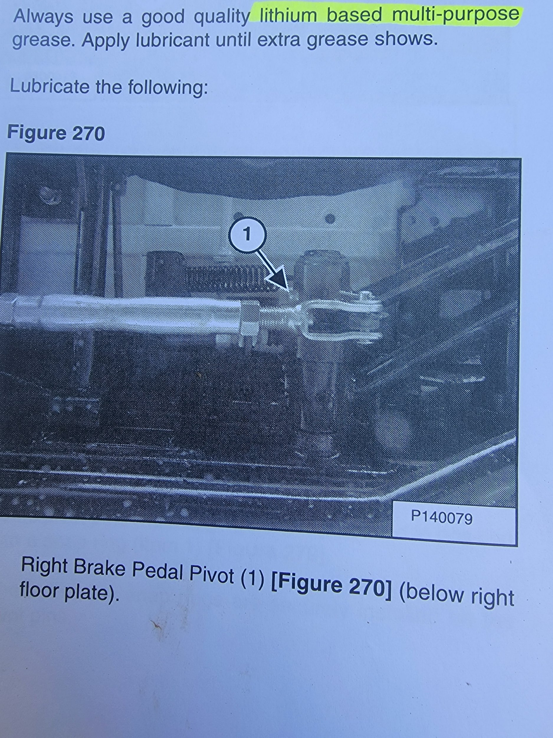

Bobcat CT2025 HST

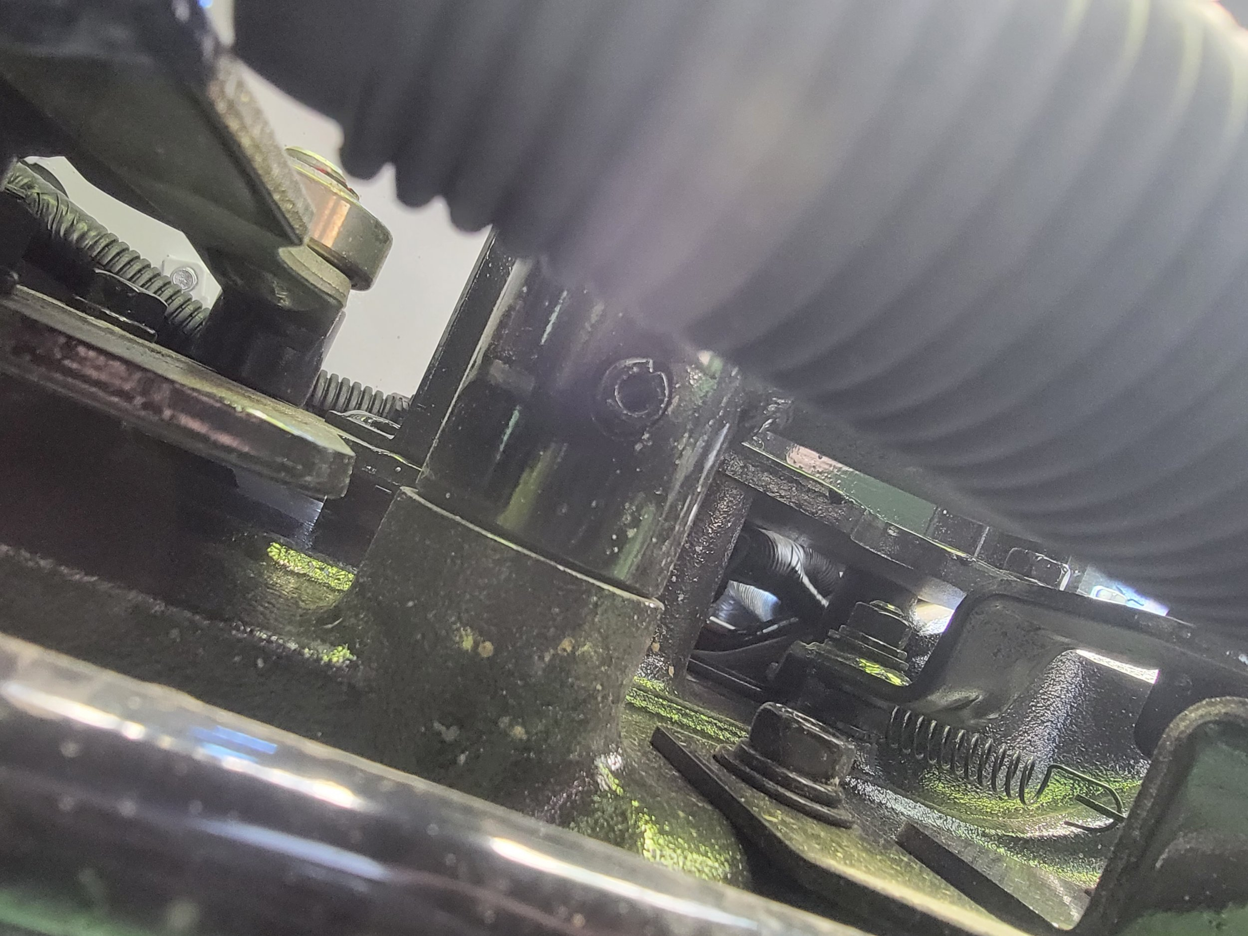

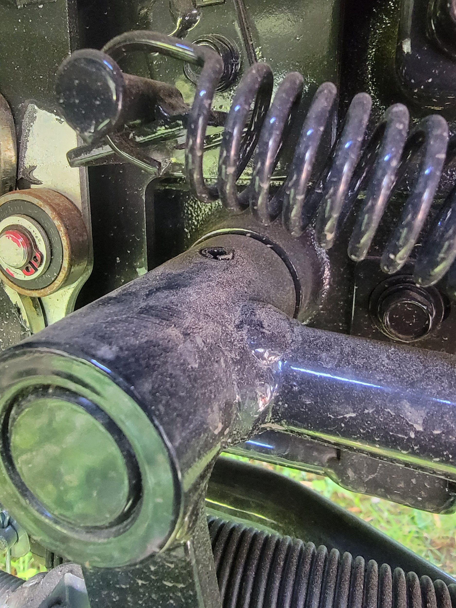

I was greasing and torquing my ct2025 and I came across greasing the pivot location for the brake pedal (right side under floor). Now the manual doesn't specifically say there is a zerk here, but the picture appears like it has one? Under the tractor is a see through roll pin. Does anyone have a zerk here or the roll pin? Maybe this was a change in manufacturing?

There's a roll pin connecting it to the shaft and the only movement is where the shaft goes in, so pretty sure there's no greasing required. Sometimes the manual calls out things for various models and years and yours might not have it.

Do you have a Right and Left brake pedal? From your pic, it looks like you only have the one, same as mine. I believe the non-HST versions have the 2 and thus the Right brake pivot and the need to grease it.
   / CT2025 zerk locations
I have a hydro and yes only the one brake that controls both rear wheels. The manual trans has the split brake.
