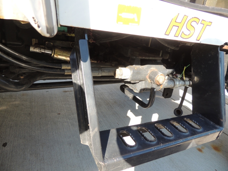

On the left of this image you can see the two cables from the loader joystick, on the right you can see the yellow and green cable ties on the of the loader cylinder lines. In the very center bending down and then toward the center line of the tractor I believe is the Return line to the pump. Just to the left of that is a metal fitting that is plugged off. Can anyone tell me - is that the power beyond? My CT 235 does not have any remote options. [I hope this photo attachment works]

That is the main relief valve. The power beyond is on the far side of your picture and will go back toward the 3 point. It will be a high pressure line. The line on this side you are speaking of is the pressure line coming from the pump. The line on the other side of the valve having a small hose connecting it to a bigger tubing line will be the suction or return line, no pressure.
You are likely going to need to buy the remote kit.

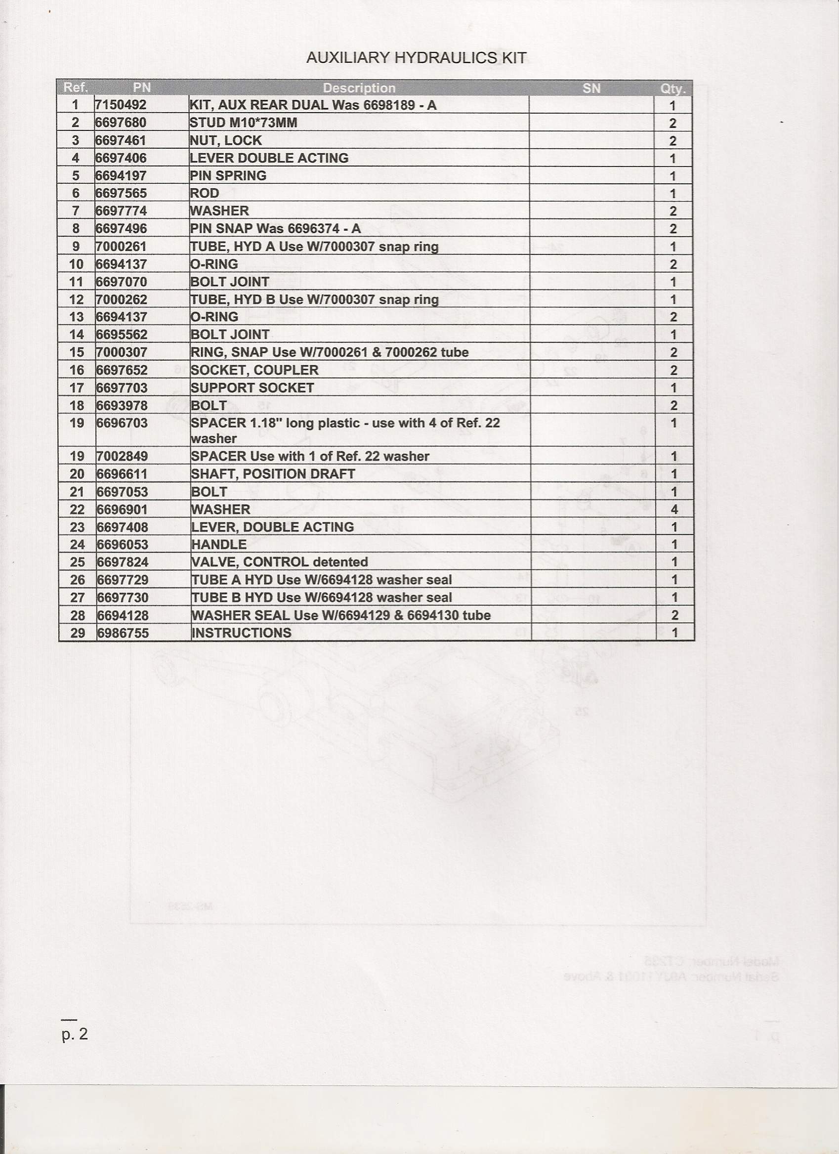

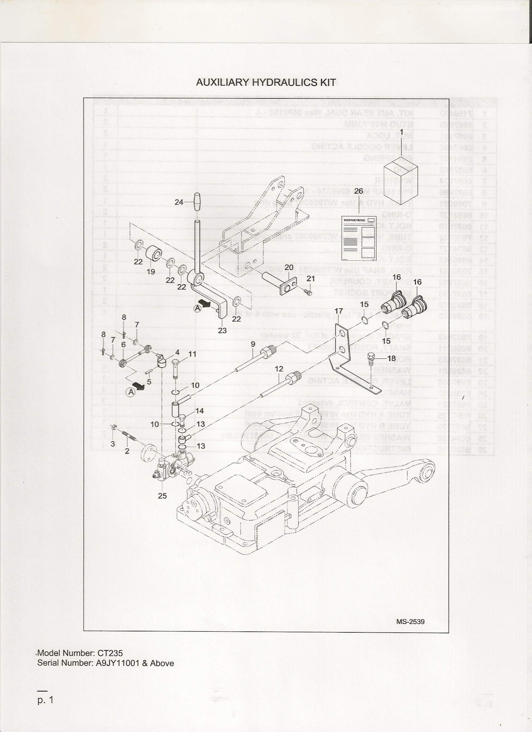

Here is one kit, there are others, may want to talk to your dealer.

Follow instructions to your model number and then look under accessories.Takes a little using to get the hang of it. This is just the parts pages, you will need to order your parts from a dealer but you can find all your part numbers. There are 3 different kits. Bobcat Parts - Bobcat Company

Installation of the AUX valve(3rd function) is easy.I can install the kit in less than an hour. It stacks onto the 3point valve or #1 AUX valve if you have it. Definitely remove the seat. This gives you great access. Don't forget to unplug the seat switch. I have installed lots of these valves and hoses to the front loader frame for customers. Have the 2 hoses split with couplers so you can remove loader if nessary.Locate these couplers approximately under R foot rest. Fab a L shaped mounting bracket for a second set of FF couplers if you have an SSL type mount for your bucket. The bracket can be mounted on the cover plate that protects the steel lines on the front loader cross member. This set up gives you AUX hyds out front and the ability to use other attachments. Get the detent kit for the valve. I thinks its only about $50. this gives you continuous flow option both front or back. You may be able to modify the valve lever to make it more user friendly with the FEL valve lever.

Correct. Install the kit Winston1 posted with the AUX kit thumbnail.Bobcat PT#7150492 Make up and run your plumbing as described. Yes its a nice set up that don't mess with any of the other hyd functions. Do you have the Detachable bucket on you loader?

Yes, the Bucket is a "Bobtach" setup with 2 levers to disconnect. The parts description for the #7150492 Auxiliary Kit list part 25: 6697824 Valve, Control detented. So it looks like the Detent is a part of the kit. Thanks to you, Winston and everyone else for all the assistance. I'm going back to the dealer this week and ordering the Auxiliary Kit. I'll keep you all posted as I install it.
