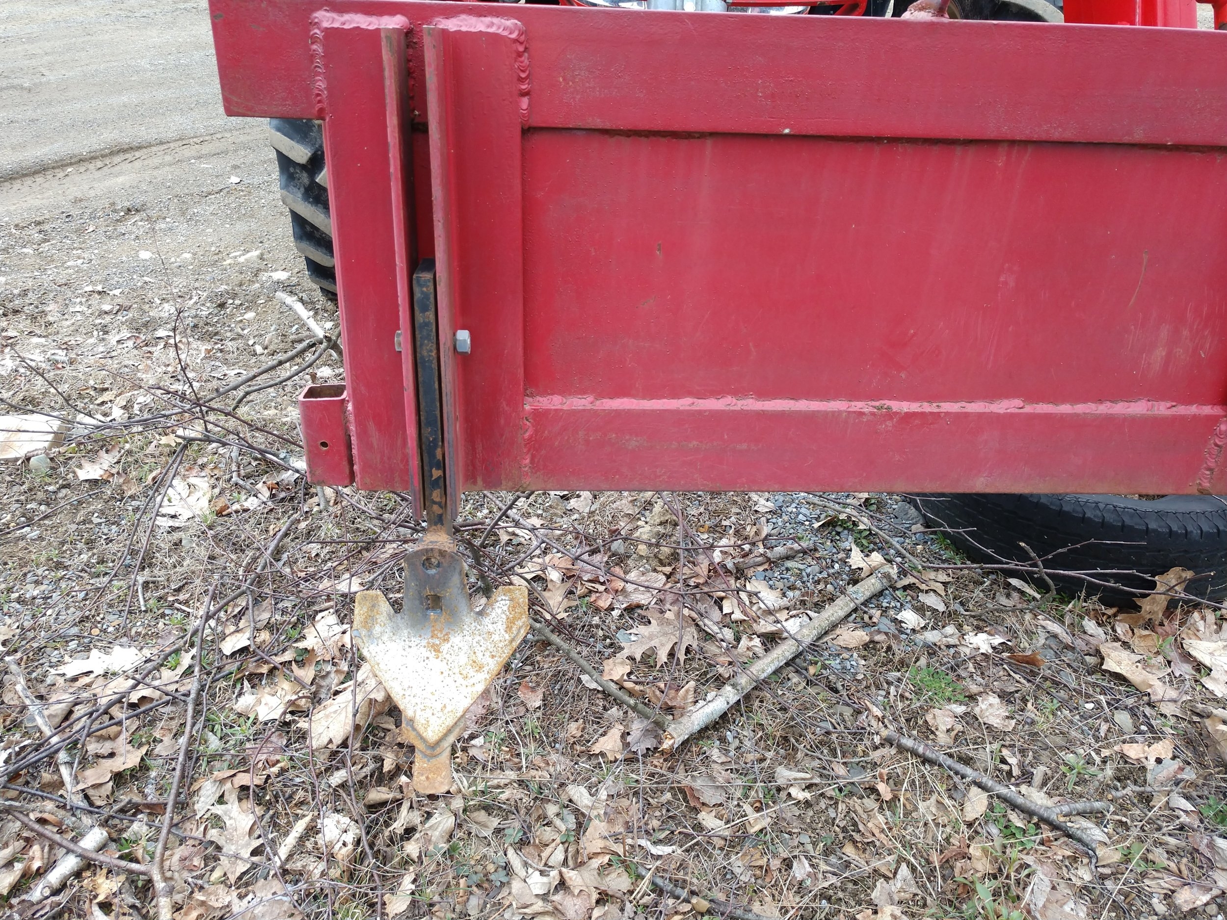

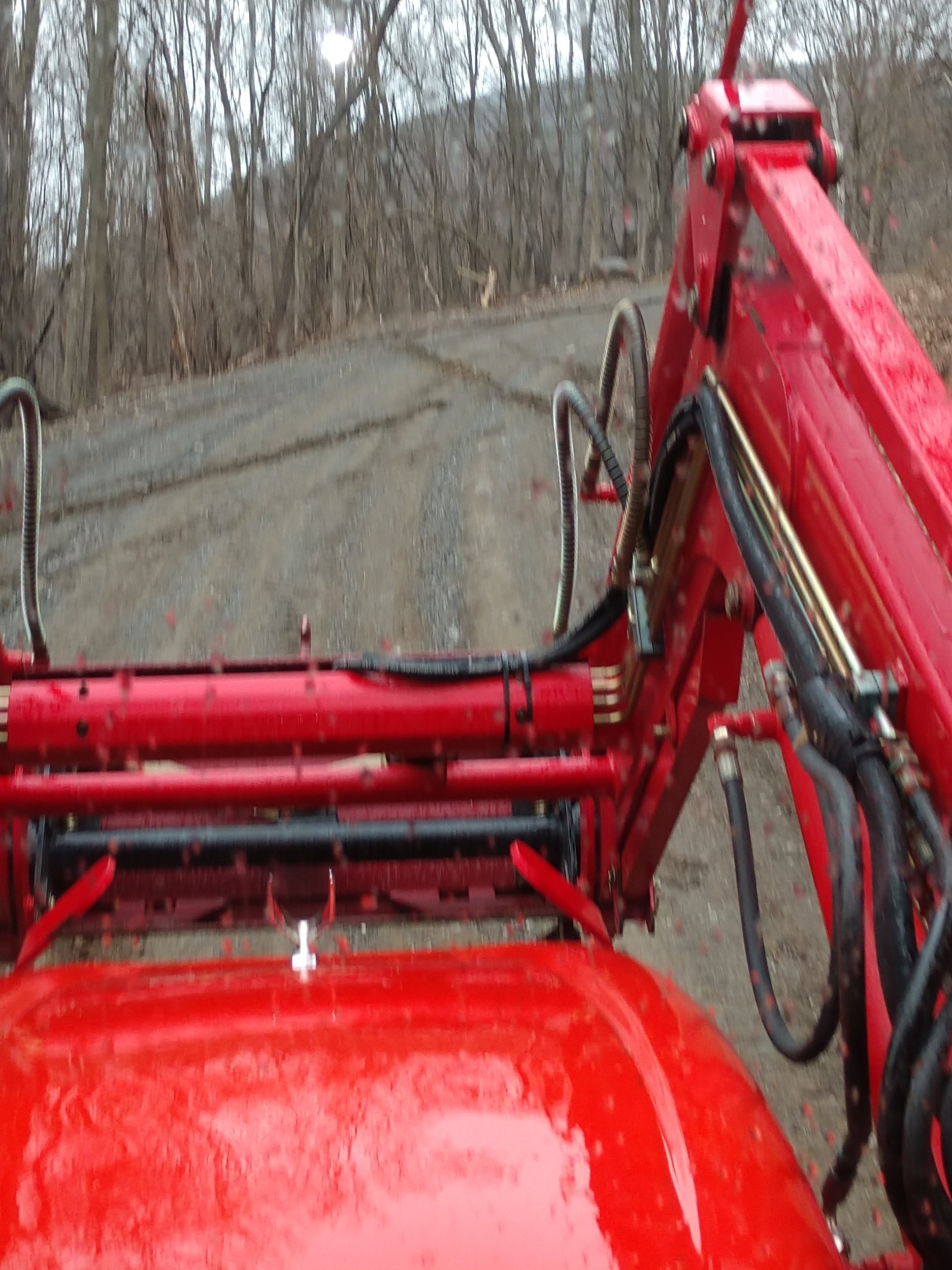

25 yrs of maintaining 1 mile of dirt road topped with road base. Too much traffic going too fast makes washboard. My 7 ft GP LP weighs 500 pounds. I ended up adding up to 500 pounds of weight to cut the washboard effectively. No tool short of a road grader is perfect for the job. The box grader with tilt will help you redistribute material. You may need the LP to cut and loosen the material and the box blade to finish it. Problem is the smoother I make it the faster they drive and the faster the washboard comes back argh. My neighbor has a new tractor and he likes to play with the road maintenance... he's green and leaves a lot of bumps. Maybe I'll just let him do it - that will slow em down. lol
