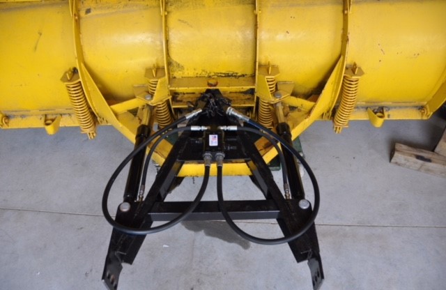

That’s exactly what I put on mine. A few hoses and adapters (maybe) and it was good to go. I think it took 1/4” bolts to mount it.

Yes, that is what you need, note we also sell a similar one.
   / Crossover relief #5
I used the one with 3/4" ports only because I could get a better deal on it at the time and I needed to add bushings anyway since the hoses from the 3rd function were 3/8" and the hoses to the plow are 1/4".
Little tip, I mounted my crossover relief to the plow instead of to the QA plate so that all of the hoses stay with the plow making it easier if you ever need to unhitch the plow from the QA plate.

Do you have a pic of how your plow hooks to your quick attach plate?
   / Crossover relief #7
Would this type of valve be used in the event of hitting something on one side of the plow letting it relive to keep things from breaking ?
   / Crossover relief #8
Yes, that is correct.
