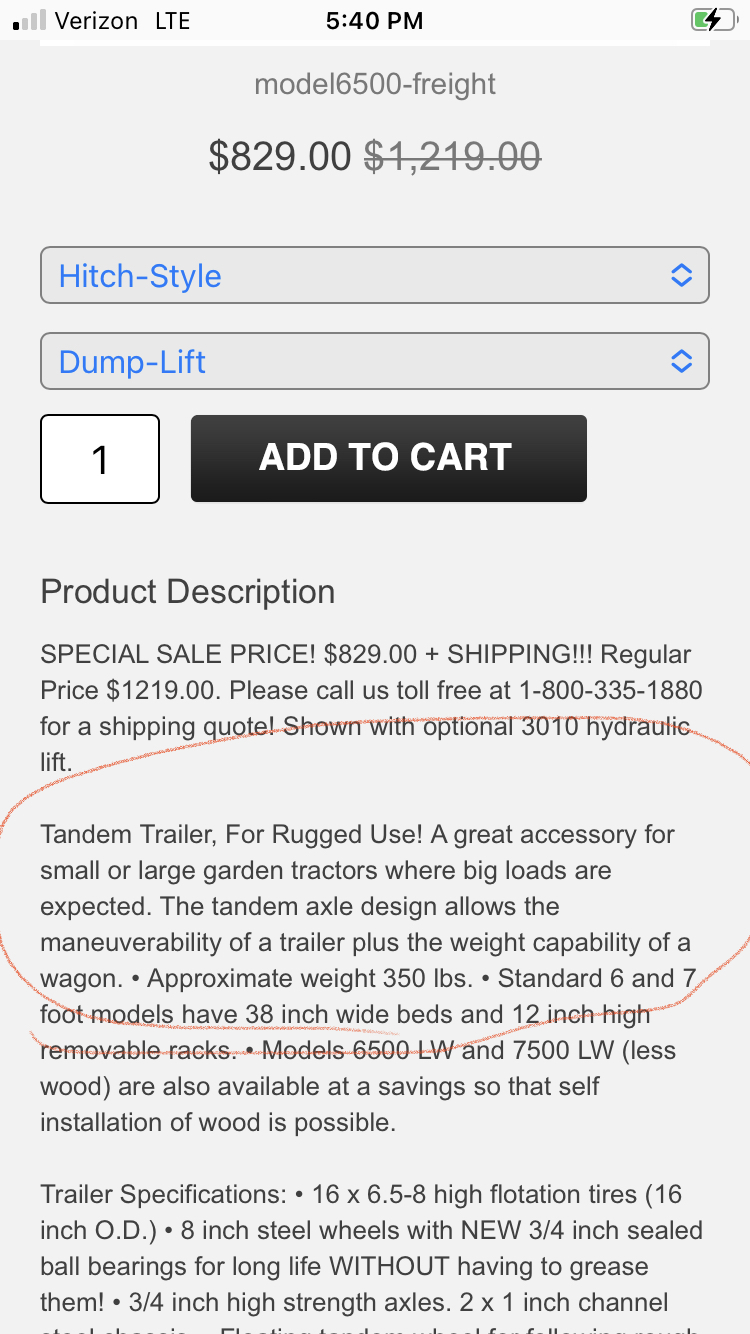

BTW, it doesn't even need to be such a big log. By chaining the load just right to be wrong, it is possible to get the chain tension to ADD to the total bending load on the axle.
Gotta say that I thought I knew what you were saying, and I agreed the first time around, until I re-read it.
I thought you were saying, or intended to say, that the tension was adding to the bending load on the trailer bed. The reason I was thinking that is because I have seen that happen when I strapped down a utility tractor on my lowboy double-axle bumper pull. After tightening the chains, connected to the sides, I looked underneath to see the angle irons over the axle with a very visible bend in them.
Trailer axels have a camber.....if they are straight you should worry.
