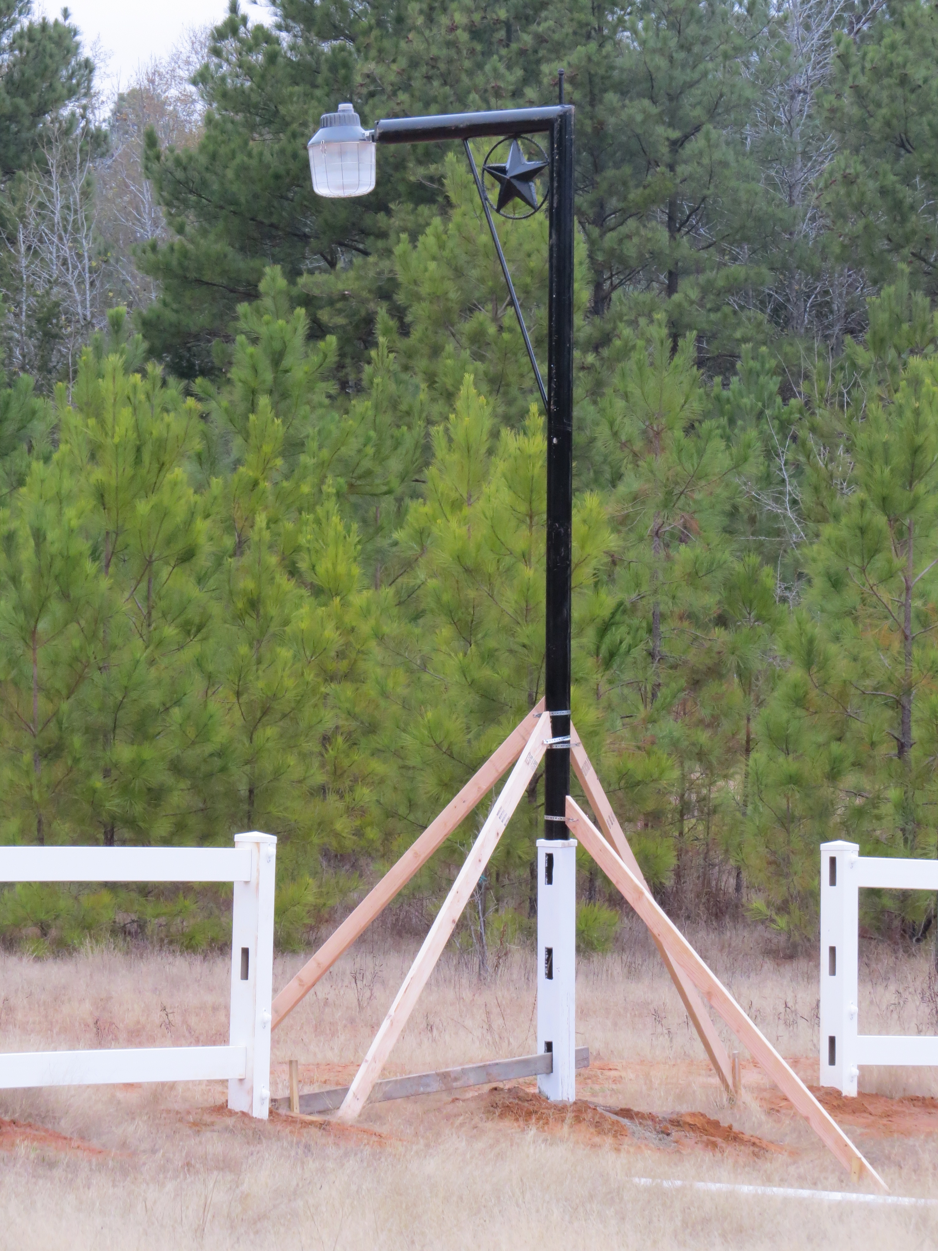

Eddie, your post/light combo looks great but it is way past my pay grade

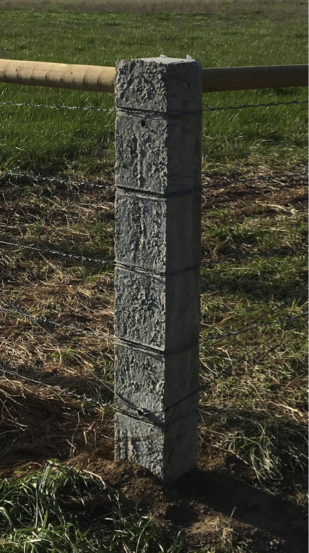

I made some crude forms with 2x8s to make concrete posts that I use as corner and end posts. I make them with groves to hold the barb wire and through PVC tubes for X brace wires. You could put in gate hinges or through tubes to bolt later. Or whatever. I use 4 pieces of 3/8 rebar set in about 2". I set them in place with my backhoe. I estimate they weigh nearly 500 lbs each so you need to think it through if you are making these in forms. Doing them my way you don't need to worry about vibrating the air out so much. I just use a shovel to jab out the air. My forms make 5 posts at a time which is about 30 sacks of 90 lb concrete.

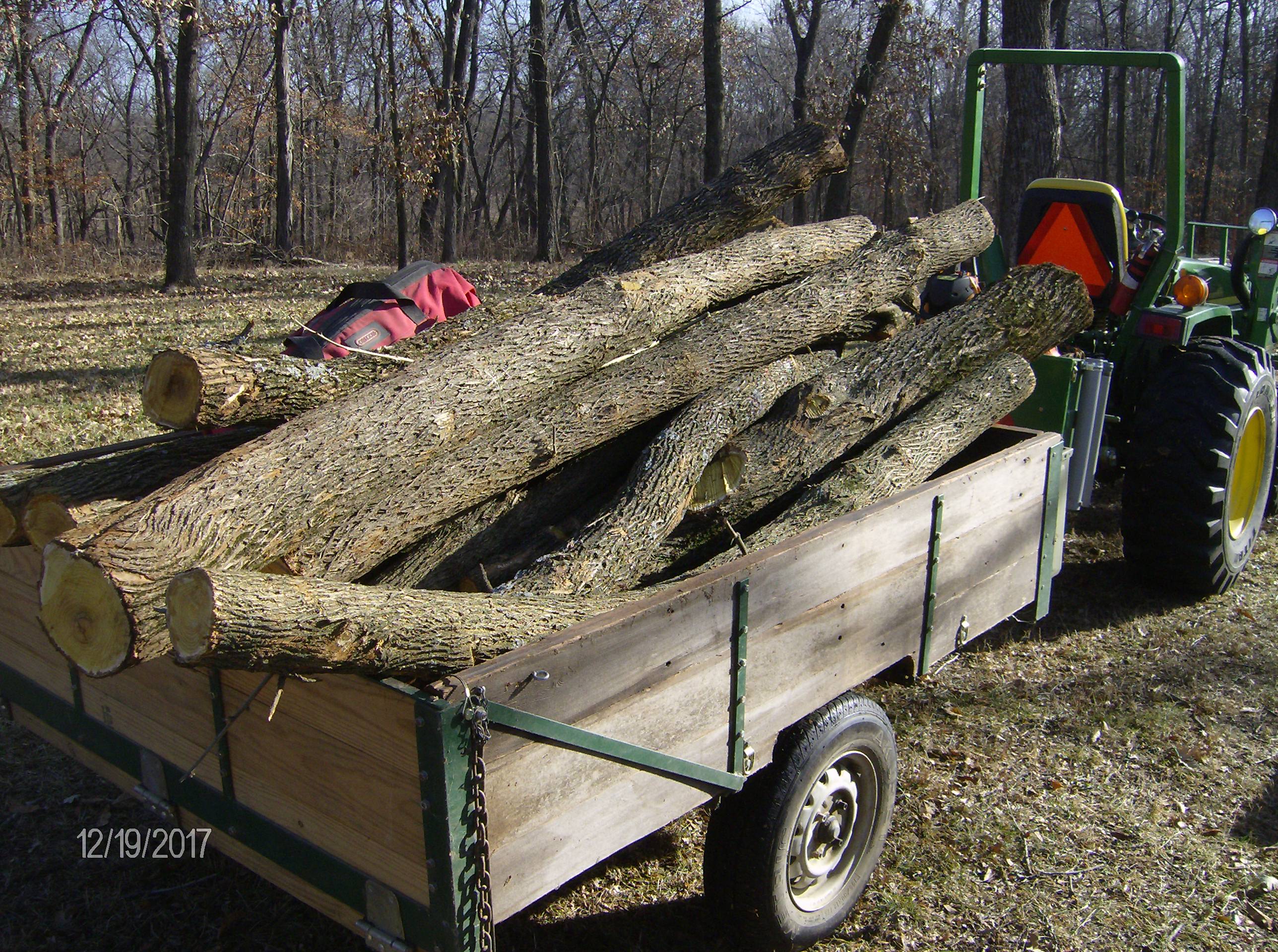

Someone suggested railroad ties which are usually locust, someone else said osage orange. Both are excellent rot resistant hardwoods which will last nearly forever, they're fence post lumber, but who knows how you ever find milled locust or osage orange. Consider asking a local sawmill if they have access to that stuff.
