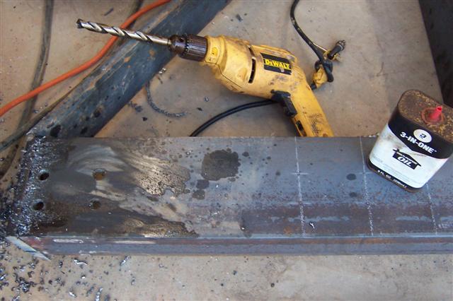

Eddie, I used to know a machinist who went "nuts" the first time he saw me using oil to drill with. He yelled at me to get some cutting fluid instead. I've never forgotten what he said, "Oil is for lubrication and cutting fluid is for cooling." I don't know if he was right, but I have a bottle of cutting fluid I use on anything heavier than sheet metal. I'm always afraid he'll yell at me again.:eek:

Thanks for reminding me there is a difference between oil and cutting oil. I'm going to the feed store this morning and I'll see if he has cutting oil. I'd heard the same thing, but forgot all about it.

You can actualy use water in place of cutting oil to keep the metal cool. Just use a little spray bottle
/ Creating a simplified Landscape Rake #26
Cutting fluid is an emulsion of oil and water - at least for steel cutting.
Here is a related article:
Cutting Fluids
Eddie, are you drilling it in one shot or do you predrill first? I have a floor drill press, one of the best tools I ever bought and I would still go in two steps to drill all those holes.
Also the drill press gives you the slow speed you need - unlike hand drill with two preset gear speeds.

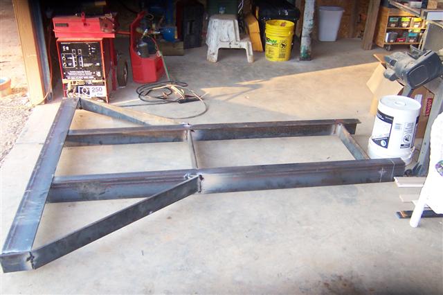

I rained 3/4 of an inch yesterday and another quarter inch today, so it was a good time to work on my rake.
I had finished drilling the 50 holes awhile ago, to that nightmare is over.
Today I cut some triangles to brace my corners and finished my welding on the flat part of the rake. Then I cut and bent some 3/8 x 2 inch flat stock for the top parts.
I had to figure out the angles and lengths, so I cheated and copied my other impliments to cut down on brain stress.
I even swept the floor and put my welder away!!!
First picture is of the rake on it's edge so I can weld the sides and put in the triangle braces.
Second picture is of one of the triangle braces.
Third picture is of the top mount for the three point attachment. To get the upright pieces lined up, I had to weld in a cross brace. This turned out to be a bit on the high side, so I had to notch it to fit the long pieces together.
Fourth picture is of the rake all welded together. I just have to finish drilling the holes for the three point attachments and then paint.
Eddie
