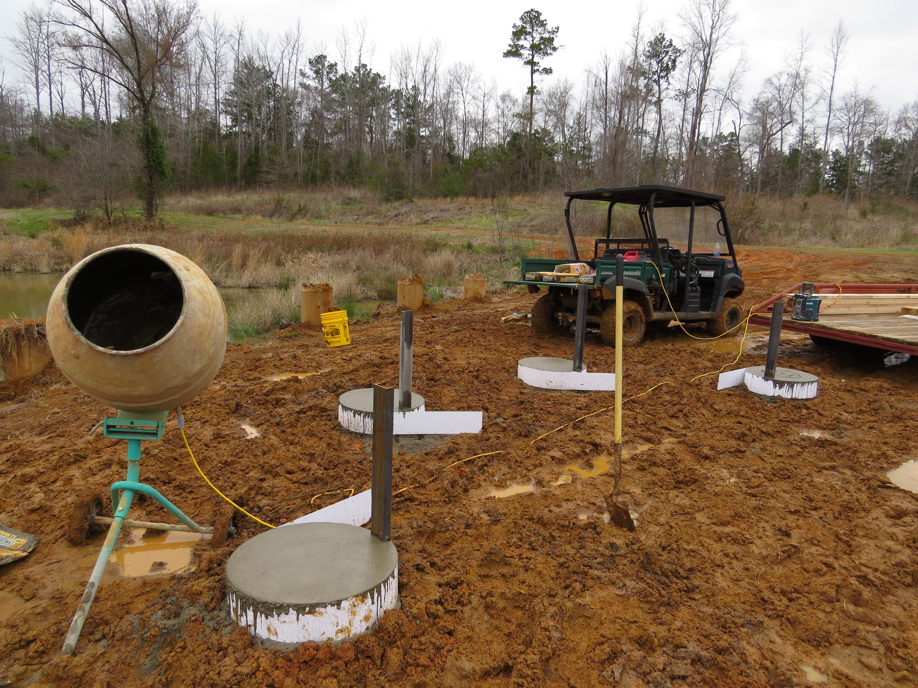

I went to Lowes last night and picked up a pallet of 60 pound sacks of concrete for the footings. I drilled the holes and set the C channel in them with four sacks of concrete, then set the forms and got four of them poured before the rains hit. I also used up every sack of concrete, so I need to get some more tomorrow to finish off the footings for the logs to rest on.
Each hole is 12 inches wide and 3ft deep. The C channel is 3 inches wide and five feet long. The forms are made from some plastic paneling type stuff that they use in mobile home showers and tub areas. Supposed to be water proof, but all I care is it bends real easy. I ripped it to 6 inches so I could get 8 forms out of one sheet. I then used some half inch wood screws to hold it together. Each footing gets 2 pieces of rebar that are five feet long and bent into a kind of circle. One goes in after a layer of concrete is poured, then the other goes in a few inches from the top.

If you got any of the rains like we did yesterday evening, it is probably a muddy mess there today! Is that an electric mixer? back saver for sure.

We received half an inch during the night, which is just enough to make a mess of everything. I used up a full pallet of 60 pounds sacks of concrete Saturday, and bought another 20 for today. I used 17 of them for a total of 74 sixty pounds sacks, or 4,440 pounds of concrete!!
The mud made it miserable. Temps where about 60 degrees with a cold wind blowing, but it was all about slipping and sliding in the mud. Probably one of the most painful days I've had in awhile. At least it's done and now I can start working on the logs. I'll deal with the dirt once it dries out.

Thank goodness for the hot tub!:laughing: A couple of days and it will be dry with the winds we've had.
How do you like that mixer? My brother bought a gas one and told me he would sell it to me when after he built his house, well he didn't:laughing: I have never used an electric one, but several gas ones, but electric is cheaper to purchase for as little as I'd use it.
