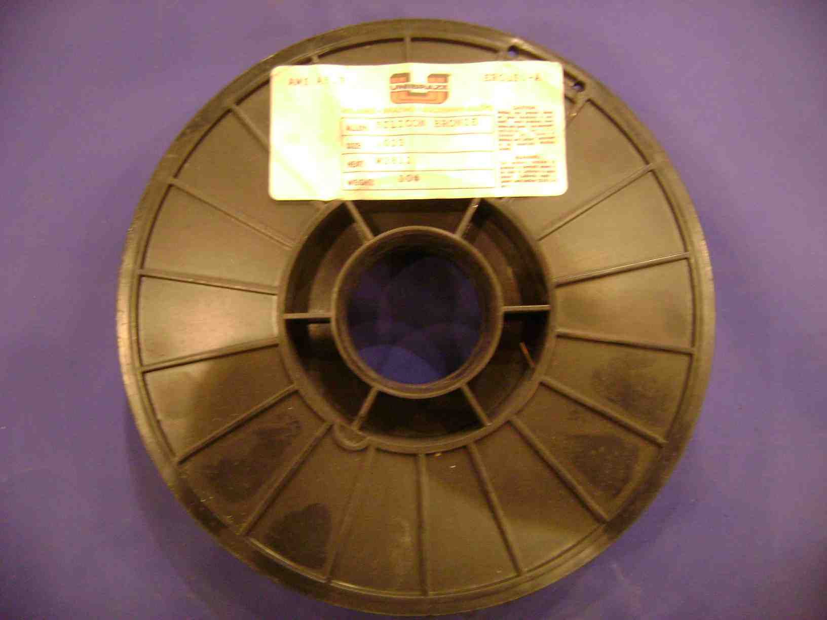

This probably sounds strange since bushings are made to be replaced. What i have is a small swinging lift like you would find on the back of some service body trucks. Capacity is around 1000lbs. It has an electric winch for the actual lifting. Anyways, it was given to me after laying around in the mud for years. I managed to get the winch to working, added new cable and now have a working lift for my wood splitter. Problem is where the post fits down in the support base. I had to machine a new hub for the bottom to set in, but the base is pretty well eat up with rust. Its 2 1/2in schedule 40 pipe just slid down into a larger pipe. What I am considering is machining a couple of collars to weld around the top of the base and the bottom of the riser pipe to tighten up the rust pitted fit. I am thinking about just brazing up one side of the collars and machining them down to a flat fit just to reduce wear and friction from the swinging boom. The heaviest weight I will be picking up is a piece of firewood, couple hundred lbs at most and I just want to eliminate the slop that is already rusted into the boom. My question is what kind of brazing material would be best to use. I could mig it up and machine it down, but this things gets used out in the weather and any steel material would just rust and bind. I figure brass or bronze, gas welded and machined to fit will be my best bet, and most likely wouldnt be rusted stuck next time I decide to use the splitter. What do you all think.
