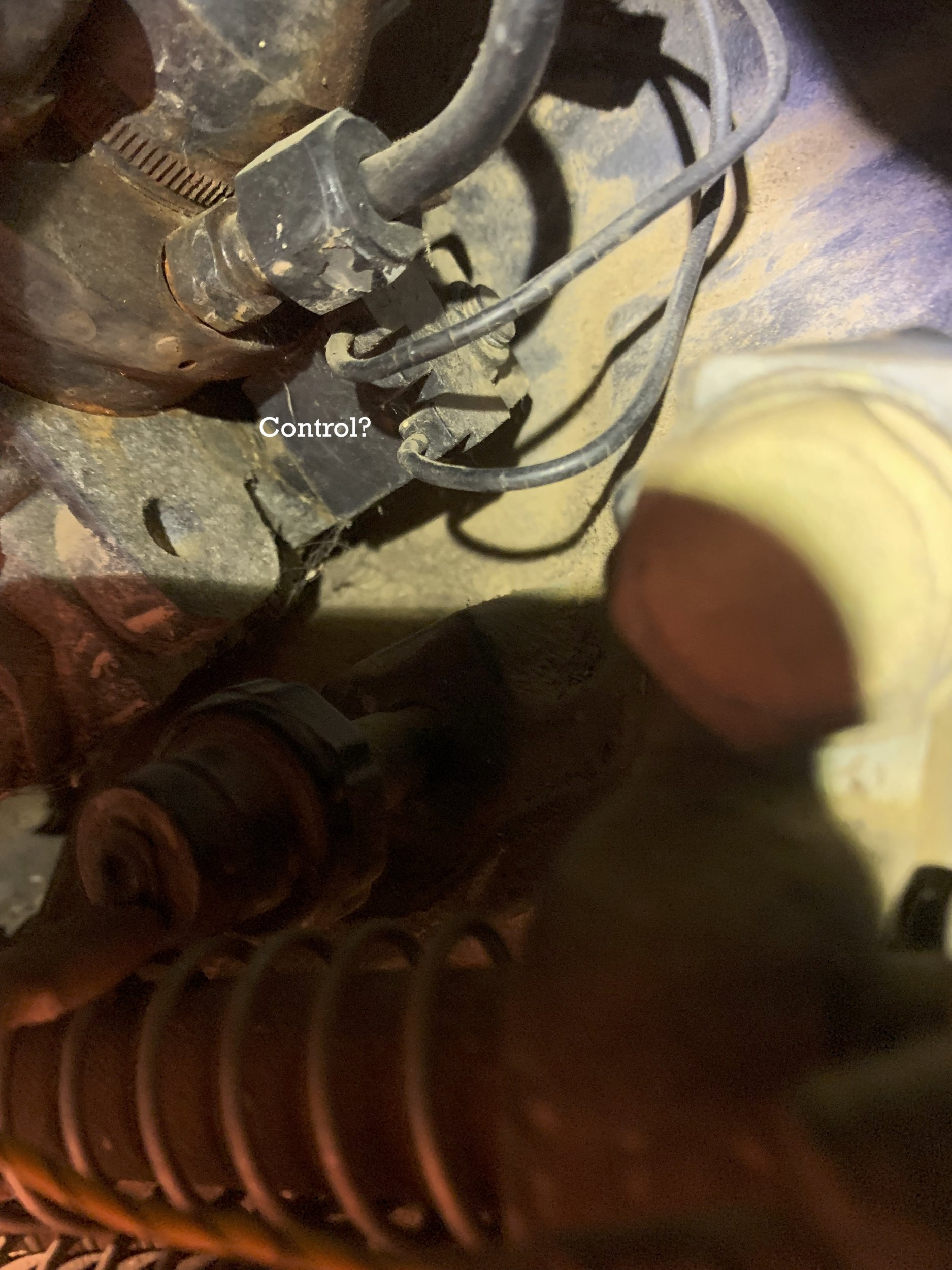

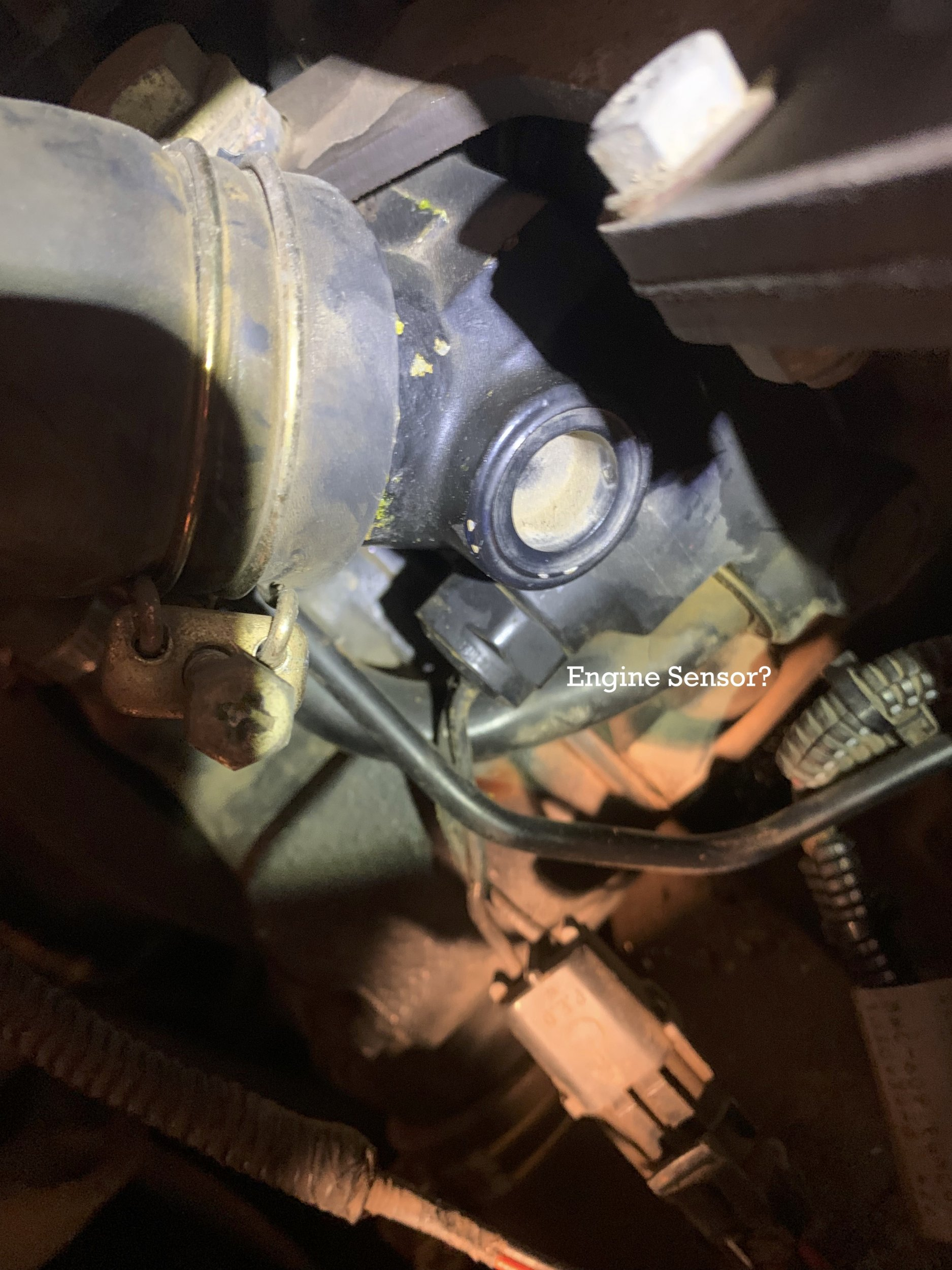

I could use some more help with this. The short is not in the peripheral wiring. Instead the pump circuit itself is drawing too much power. There are two sub-circuits: one appears to be the main fuel-control solenoid, and is ok—powering this alone allows the tractor to start and run. The other circuit has power going through an engine sensor and into a component mounted on the injection pump. If I directly feed this circuit power it's already drawing 6 amps at 5 volts, so clearly it's blowing the 10 amp fuse when full battery power is used. My questions: What is this circuit? Is it a protective element to kill the engine if there's overheating? Or something to do with fuel regulation? I'd like to know if it's safe to run the tractor without this, or if I need to first identify the faulty component and replace it?
I'm attaching pictures of the possible sensor and pump control.
