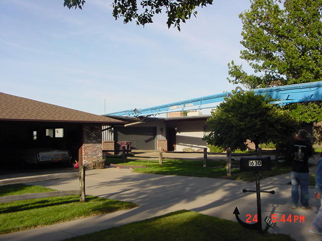

I think they both lost... Do you realize the expense to replace a damaged boom section and to do a full inspection (dismantling) before the equipment can be used again?
I used to do concrete pumping, so when a competitor in town laid one over on a house, the pictures made their way to me.
I never heard what happened, but from my study of the photos, it appears the operator never extended the rear outrigger, and perhaps the front wasn't fully extended either. The truck was OK until the load of concrete began getting pushed through the boom pipe shifting the cg outside the outrigger footprint.
