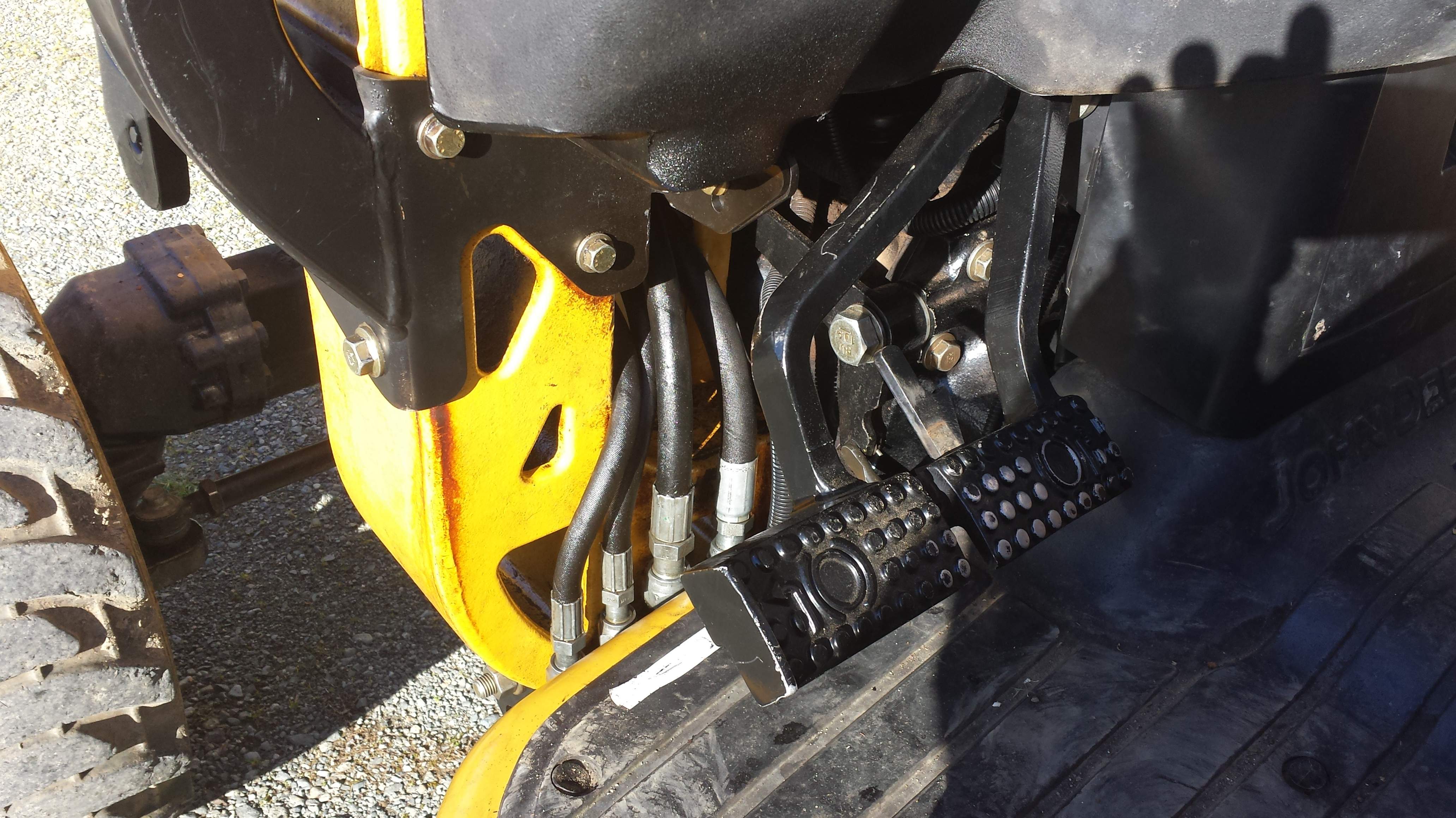

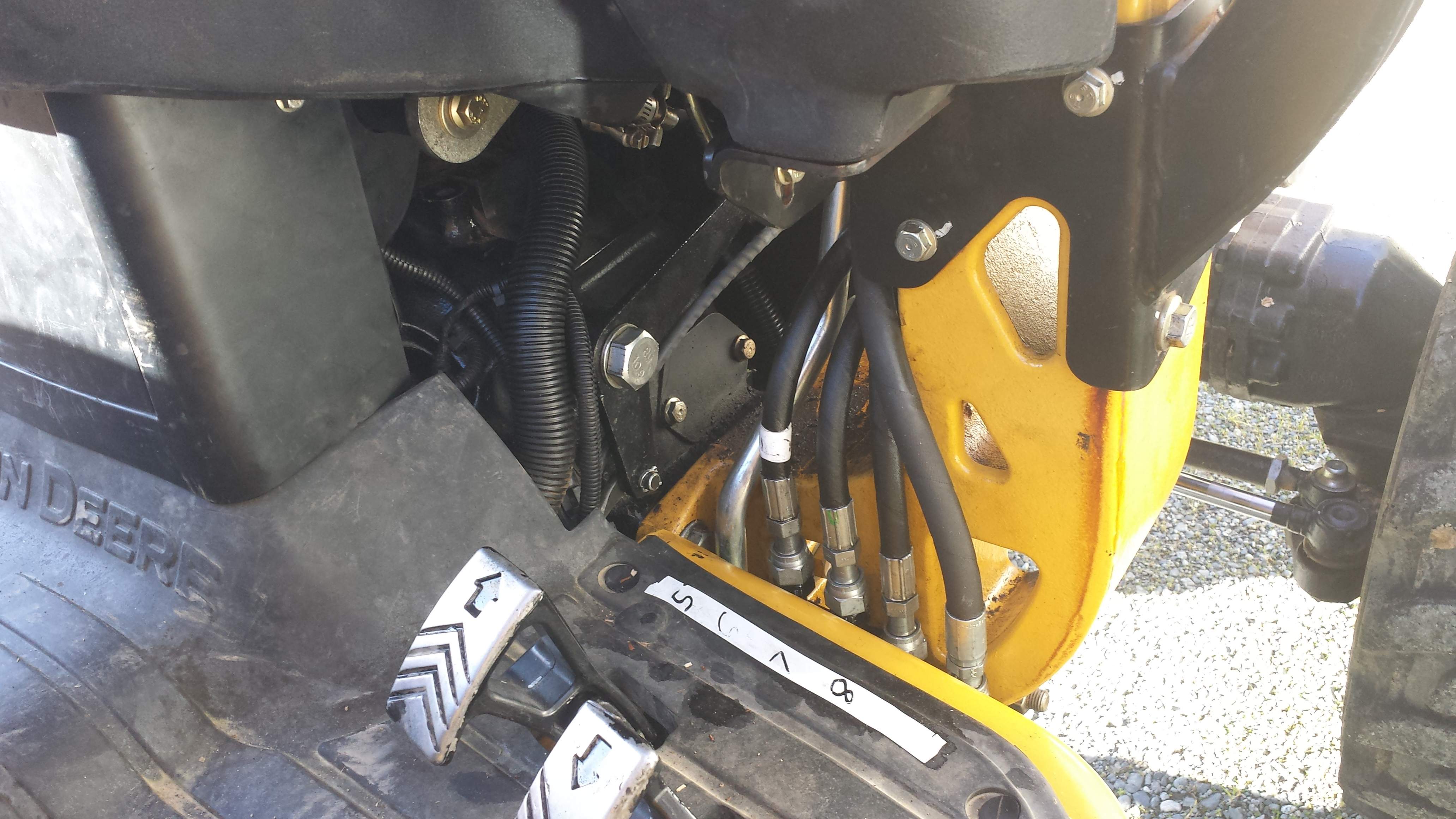

It's the hoses that come from the valve controlled by the joystick that go to the front boom raise/lower, bucket curl up/down and the auxiliary electric valve that controls the 4-in-1 bucket jaws. Pics attached.View attachment 414352View attachment 414353
I'm guessing that you need pics of the hose configuration for the spool valves just below the joystick? www.JDParts.com would likely have a diagram that might be useful as well.
AKfish
I've looked at the exploded parts diagram in the catalogue but it's really hard to see where the lines and hoses go. I guess it need a "pin-out" diagram of sorts.
