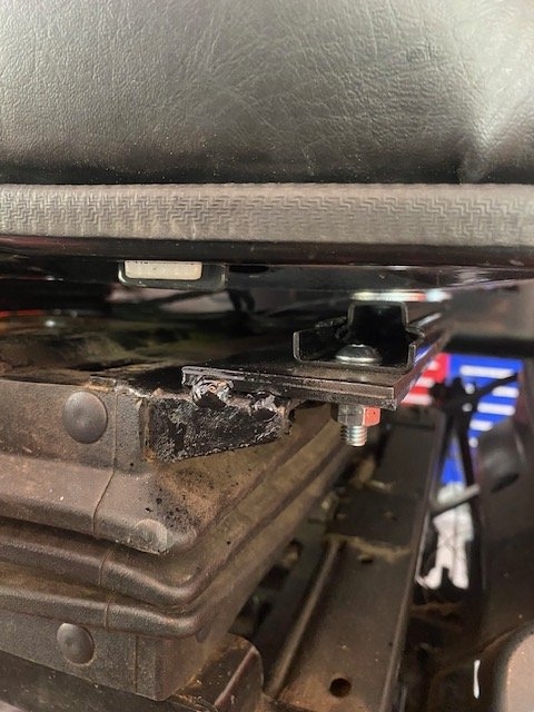

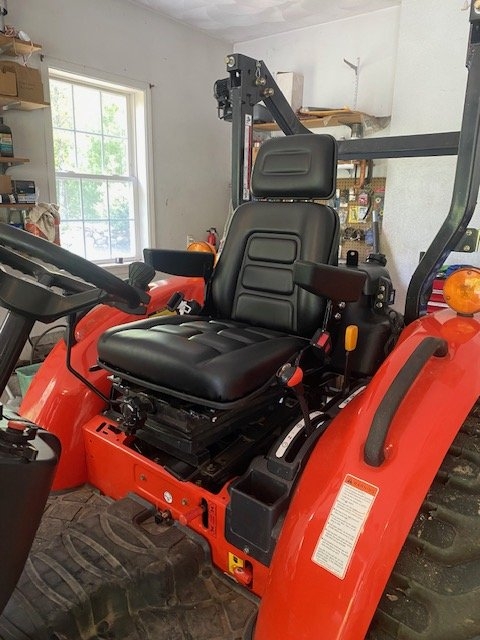

I have a CK2610 and the seat cracked after just 1 year. the tractor is kept inside except when in use. I bought a seat from Amazon for about $380.00. better seat and was easy to install. The seat came with the entire suspension but I didn't use it. Had I know I could have Just bought the seat assembly. To install the seat I welded 2 pieces of 2 1/4 X 1/4 flatbar drilled a few holes and it mounted right in.
