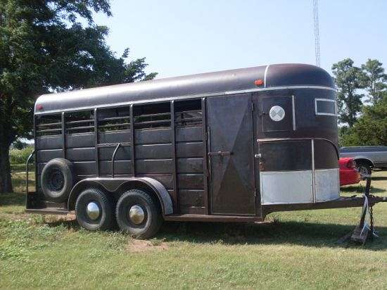

/ Cows in a horse trailer? #9
We have a friend that raises beef and his daughter showed horses in high school. He has a trailer very similar to this. He's been taking cows, two at a time, to the butcher every spring for about 10 years. Hauls the horses to shows. Took a couple pigs in this year. Cleans it out and moves stuff for people when they need furniture moved, move to new house, etc... its a really useful type of trailer.

/ Cows in a horse trailer? #16
