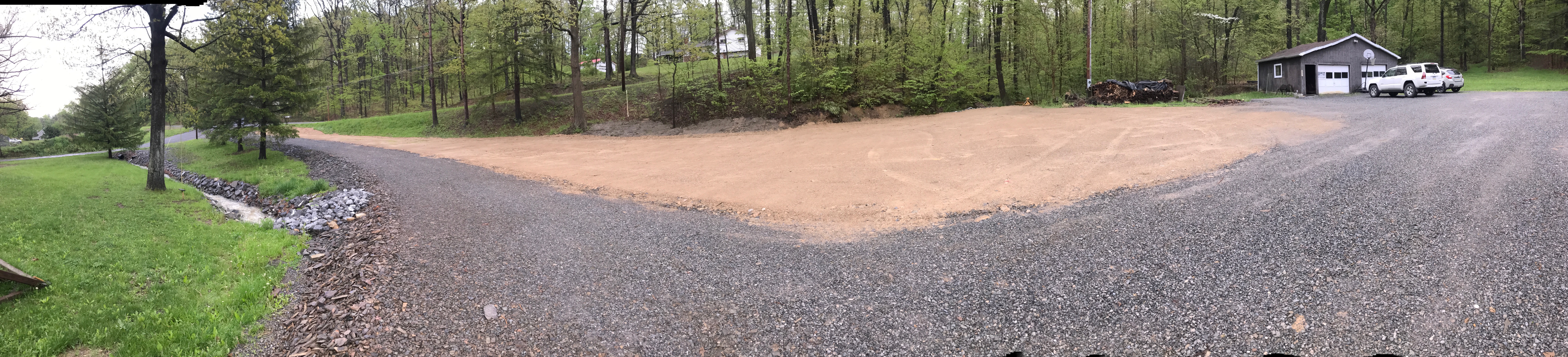

Thanks for the compliments, men. I have been thinking how to do this for the last 10 years.
10 or so loads of clay rolled in on Thursday. Neighbor can get me unscreened topsoil for a pretty good price so it sounds as though 6 triaxle loads of that will show up. Then the Kubota gets to do a little work!

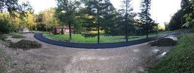

I pulled the trigger and I am really happy we did. Kids having been riding bikes, scooters and playing basketball on it all month. Although the cold can hold off as long as it wants to, really excited about no ice on the driveway in the winter.IMG_6390.JPG

Thickness of the blacktop is 4 to 5". As an added bonus, the township had the same company that paved my driveway do a mile long section of our road. Tied my driveway into it so nicely; can't even feel the transition when you pull out. Had some more slate and clay delivered last week to fill in next to the right edge.

CincyFlyer is right on. The driveway underneath is over 40 years old with load after load of gravel laid in over the years. I then had lifts of slate rolled in, additional gravel brought in and then the paving guys laid another 2 to 3" prior to paving. I didn't cut any corners on this one. And I don't expect to have any triaxle's on it again....ever if I can avoid it.
Time will tell, but I am pretty confident it will last. And if it doesn't, it will get fixed when a top coat goes on in a few years.
